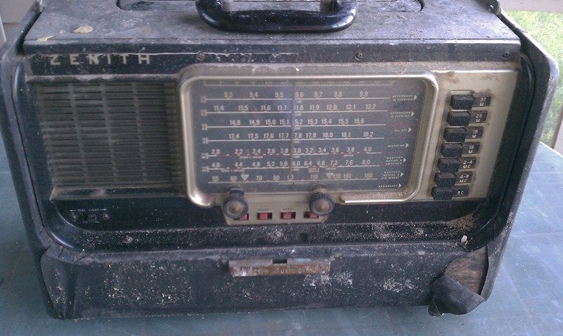

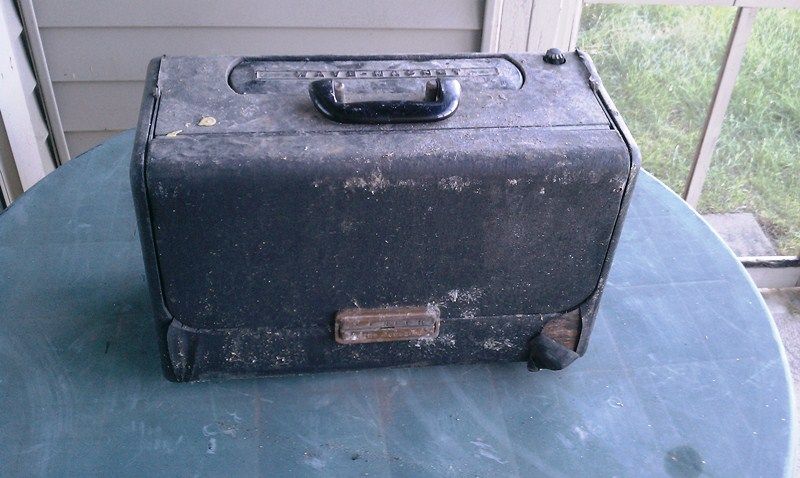

Picked up this old radio for free.  It is filthy and I bet no longer in working condition, but it's cool and full of fun stuff.  And based on what I see under that torn covering on the front cover, I may be able to strip it to a wood base and finish up the wood nicely, or even re-cover it.  Assuming I don;t gut it for more artistic purposes.
The guy had found it in his basement hiding in a corner that had been blocked off for about 40 years by a wood burning furnace he just had removed.

« Reply #2107 on: October 21, 2013, 04:54:08 pm »

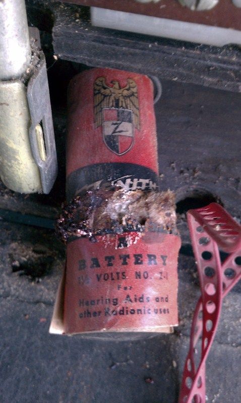

I love this giant dry cell battery that says "for hearing aid and radionic uses".
I can't make out the print on all of the the tuning indicators. Does it have short-wave capability?

« Reply #2108 on: October 21, 2013, 05:58:03 pm »
Yeah, I noticed that too  Wink  I know it was an AM only radio.  I haven't had the time to really research it.
« Reply #2109 on: October 22, 2013, 02:29:02 am »
What's the era of this radio? The giant dry cell doesn't look like it belongs with the perforated red plastic strap.
« Reply #2110 on: October 22, 2013, 02:42:01 am »
I'd venture to guess that it does. The band selectors appear to be marked for the 31-, 25-, 19- and 16-metre bands, as well as 2-4 megacycles (MHz) and 4-8 MHz; all of which are in the short-wave spectrum (according to TSOATAK.) The last button, marked "BC," would be for the commercial AM broadcast band from 530 kHz to 1610 kHz.
« Reply #2111 on: October 22, 2013, 04:44:03 am »
^agreed^
Almost any time one sees multiple(and not 3) lines of bands it's a shortwave receiver. I bet all that will buff out and a little work will have you listening to far away places at night time. Grin

« Reply #2112 on: October 22, 2013, 05:05:15 am »
My Good Msr Sulla -
Congrats!
You have stumbled upon the tube-based version of  the famous Zenith Trans-Oceanic Short and Medium Wave Radio, probably model Y600:
http://en.wikipedia.org/wiki/Trans-Oceanic
http://en.wikipedia.org/wiki/File:Transoceanic.jpg
1946 Zenith Trans-Oceanic Shortwave Portable Radio Model 8G005
Vintage Zenith Y600 Transoceanic SW Shortwave Tube Radio Cowhide
to some of us the Trans-Oceanic is the grail of antique portable radios.
The covering could be leather or leatherette - please consider restoration over removal. Tubes (oddly enough) are available from several vendors out of Eastern Europe (often via ebay) . Batteries can be replace by modern dc-to-dc voltage devices.
hope this helps

Wow, thanks!  That does help a lot!  I have no idea what this thing has been through so I hope it still works.  It has a plug in the side that can be reeled out of it, but I am glad to know current power supplies can be used.  I feel confident that I could refurbish the outer wrapping, but if the mechanism inside is toast, well, that would be most unfortunate.
I wonder if a little compressed air would be OK to get a lot of the dust and dry debris out of it without damaging it?

« Reply #2114 on: October 22, 2013, 07:10:43 pm »
Everything inside is replaceable.

« Reply #2120 on: October 23, 2013, 06:17:37 pm »
Picked up this old radio for free.  It is filthy and I bet no longer in working condition, but it's cool and full of fun stuff.  <snip>
SAVE THAT BATTERY! If it isn't already too late...  The label, if it can be removed intact and run through a scanner, will be highly sought after by enthusiast radio collectors who make reproduction batteries for their sets!  Be sure to include the correct dimensions of the cell and position of the label.

I have not done anything with this radio (or it's battery) since I got it; except to store it safely.  Thanks for the tip about the battery.
