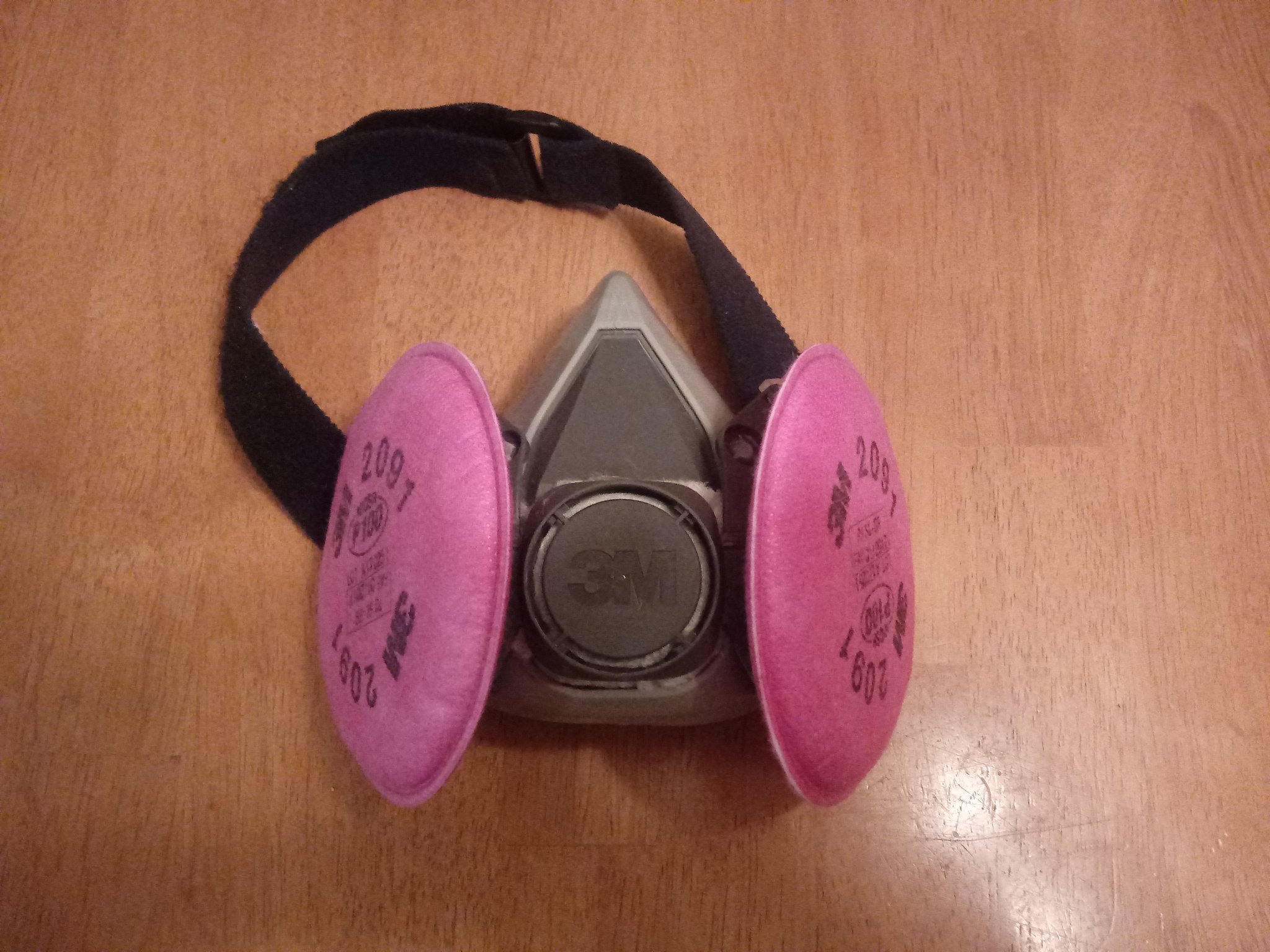

I am currently working on a modification to a 3M P100 respirator very graciously donated by a Brassgoggles member (said member may or may not want me to divulge their name, so that's why I'm not mentioning their name - otherwise, please come forth and accept your accolades!). Having tested this 3M mask in public, I quickly realized that professional respirators were not made for this pandemic, because the design focus is all on protecting the wearer of the mask. Also most respirators seem to be designed for people who are working in a sedentary way inside a closed air conditioned environment and not running to catch a bus or jogging around the park.
Modification to add an output filter and new strap to 3M respirator
First and foremost, respirators with valves have an unfiltered outlet. This is a problem since the wearer doesn't know if he/she is infected. If you are comfortably sitting in the bus confident you are protected from other passenger's SARS Cov2 particles, please be aware that you may be breathing your unfiltered SARS Cov2 particles into the cabin of the bus. Worse, the particles are accelerated, because the output valve accelerates your breath coming out of the mask. Unfortunately this is a problem shared with some N95 medical grade anti-viral masks out there!!
The solution for the 3M mask is however extra simple. I can use the same type of filter material I used in making the respirator above and place it in the cover of the output valve. Initial trials indicate the system works well, but there is increase pressure in the mask when you exhale, so I need to change the strap design to keep the mask secured to the face. The strap will need to be different to that provided and even the strap of the respirator I made. There will be significant design changes before I venture out with it! Note these challenges are being faced by health and emergency workers out there in the real world!

So I did the test for the 3M respirator, and I actually replaced the hospital style double strap (one for your head and one for your neck) with a single buckled strap - the same I used for the PVC respirator in the pictures). I was convinced that setup was better than the thin elastic straps the 3M respirator came with. But after walking for 15 minutes, I had to leave the hardware store I was visiting at the time, because the warehouse was warm, and I realized that sweat was making the mask slip, and even if I tightened the strap (the same way I did over the ears and around the back of the head for the much heavier PVC respirator). Every time I exhaled, a jet of air would blow over my nose into my eyes, and the mask would just fall downward. I could only keep the respirator attached to my face by pushing the mask firmly against my face which meant I had only one hand free. Previously, when I had worn the same 3M respirator at home, I had convinced myself that the single strap worked perfectly and was very tight, since my PVC respirator was much heavier and the 3M mask was soft and comfortable.
As it turns out, that seal on your face for the 3M device is dependent on your skin being dry and cool for the rubber mask to have some positive grip on your face. In contrast, the PVC mask's steel ring just digs into your skin, not letting go even if you're sweating profusely (with some discomfort - but bearable).  So the design of straps and shape of mask is integral with the seal around your face.
Now, I'm determined to make the 3M respirator work (and I'll keep working on it), as I feel that it is a more universal design which will fit more faces, and it features strong professional grade filters and valves that you can find commercially. But as Ms. Sewstine shows, sometimes some masks pass the test and others don't, and it's not necessarily the fanciest design. You have to keep working at it. There is some secret to the sauce, so to speak.
