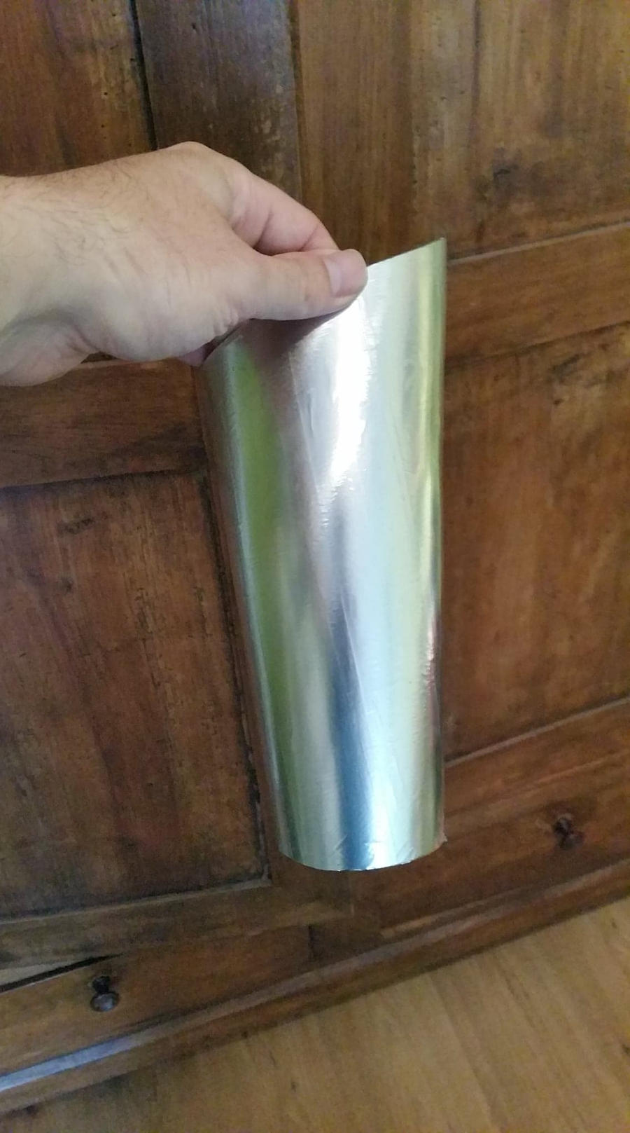

« Reply #29 on: October 06, 2019, 03:27:10 pm »
Time for an update:
I have purchased a 100mm diameter PVC pipe and some aluminium tape.
Boiling water as a melting medium for PVC pipe works perfectly!
Within half a minute in boiling water, the pipe is plyable without loosing to much if it's structure. Not melting at all.
So far, I have made a template of my arm, using a thick sweater covered with plastic foil, covered with ductape.
The ducktape is my template for both my arms.
I have transfered the template to the 100mm PVC pipe, bumping in to my first heardle.
The diameter of the pipe is limiting my design of the pieces.
The aluminium tape looks awesome, but has a downside.
When overlapped, the thickness of the aluminium shows through the shining surface.
From a distance, it looks good, but up close you can see the overlap.
I had do dull down the aluminium because it was unrealisticly shiny.
On a test piece, I have dulled down aluminium with a stick-on silver ornament.
The picture also shows the overlapped aluminium tape.
If I find some time to continue the build, I am going to figure out how to connect the parts to each other and to my body.
« Reply #30 on: October 06, 2019, 05:27:06 pm »
The overlap marks could be used to advantage; you could create the look of thin layers or decoration.

« Reply #32 on: October 15, 2019, 11:05:14 am »
The pipe I used is originally for downspout. The outside vertical part on the side of houses.
It has a thinner wall than the regular PVC drainage for sewer system.
The 100mm diameter means the circumference is about 310mm.
A decent size that is small enough to work with comfortably.
All I have to do is design according to the limit of 310mm.
For the PVC pipe material I am happy with the results.
For the metal surface, I'm not satisfied.
Aluminum tape works, but has the annoying overlap and tape edges.
Also, the tape needs a flat or at least unstretched surface otherwise it starts to wrinkle.
An alternative is to use small pieces of tape, deliberately overlapping as a patchwork pattern.
I've got one more option and that is aluminum foil, gluing on the PVC.
I'm going to try that next, on a test piece before I continue.
If this does not work, I am going to look at metallic (spray) paint.
My main concern is the durability.
The armour parts are going to rub against eachother, possibly shaving the surface.
