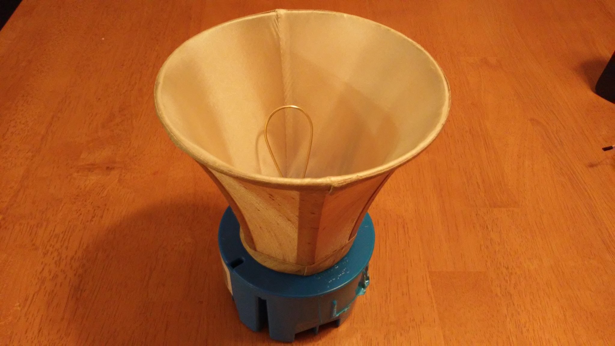

I just purchased this inexpensive PC sound system. I'm not expecting much from it, but it has a nice bass sound and 25 W, which is good enough for a tabletop device.
I was inspired by a lot of steamy lamp accessories at my local shops lately, like these LED filament bulbs from GE, which often are paired with equally steamy lamp bases, in this case the sconce base in the picture above.
I had already though about tiny lampshades as horns. The trick is keeping the items inexpensive and believable for their purpose. I know I'll never ever find horns as nice as those Aluminium lamp /sconces I used on the original Boombox. But I'm going to give it a whirl, to see if I can make it inexpensive and aesthetically pleasing
The purpose of the unit is to be sold, in identical copies, like the headphones I just made. So the plan is to bring the Boombox into the present with Bluetooth and make it much lighter and inexpensive. Gone are the days of the iPod dock. The quality of sound will not be anywhere close to the old 2000-Era Altec Lansing subwoofer system. But on the other side it will not be the monster the Mk I is at over 30lbs of weight. I may also try my hand at using a power inverter and battery. The last version was a mains powered only device on account of the very large and complex multi voltage transformer.
I don't know. We'll see. I saw this brand new unit for $30, and I couldn't resist to buy it.

So late last night I got my first go at making the speakers for this boombox. The satellite speakers, unfortunately are to big and awkwardly shaped to use in this project. Unlike the Vicky Box Mk I, the satellite dishes can't be fit within the horns. So I set out to reverse engineer them.
At first, I started tearing one of the speakers apart, and I thought to myself that was the toughest little plastic box I had ever encountered in my life. Good enough to be a money safe, the designers in Switzerland made sure that their speaker enclosures were very rigid (as they should) to avoid having a "boxy" sound. The idea is that the speaker enclosure material should be very dense (not in this case - just ABS plastic), and very rigid. That is why particle board is used to make old-school speakers and subwoofers. The denser and more rigid, the more acoustic energy can be stopped and reflected back where it's needed as opposed to having the box vibrate and act like a violin or a guitar where the wood enclosure also generates sound.
Alas, I must be losing too many brain cells, because on the first teardown I found that there were 4 more screws hidden under the circular bezel of the speaker  Roll Eyes  Much to my dismay (not really) I found out that these speakers are not really Port Bass Reflex. The hole and horn are just for show and the manufacturer cleverly made a placebo horn and port duct, totally isolated from the internal speaker enclosure (I hate dishonesty - it's not even needed!  Angry ). Luckily, the port on the subwoofer unit is NOT fake, as I can see it made from carboard and I can see the back of the particle board inside the enclosure - the bass coming from the center unit is very nice, for such a small subwoofer driver - obviously it was tuned as Helmholtz resonator  with a 1/2 wave port (the way we learn it in acoustics class as part of fluid mechanics science) = Bass Reflex system (the way that it's understood in practice in the audio industry - there is a set of two languages when it comes to acoustics - mostly due to the complexity of real life vs. theory). The small woofer driver which is facing to the table or the floor, is totally exposed however, it will need a grill or something to protect it.
https://en.wikipedia.org/wiki/Acoustic_resonance
https://en.wikipedia.org/wiki/Helmholtz_resonance
https://en.wikipedia.org/wiki/Acoustic_suspension
Anyhow the little satellite speaker boxes are simple acoustic suspension enclosures. That makes my life easier. I set to measure the volume of the speaker enclosure by filling it with water, and using a measuring cup. The volume of the speaker is 350cc minus the fake port horn cylinder  Roll Eyes, for a total of about 316cc total volume. It should be easy to find a cylindrical enclosure to subsitute for that volume, though that will cost me money...
The ideal choice is PVC cap fittings in either standard 2.5 inches or 3 inches. The PVC material is very dense and heavy, ideal for a speaker enclosure. For a 3-inch size (actual internal diameter 3.500 inches), the cap depth needed is only 2 inches. The cap is 3 inches deep. If I use 2.5 inch PVC caps that should be about 8cm. Some compromise will be needed, so I'll go to my local hardware shop to play with plastic pipes after work today.
« Last Edit: April 03, 2019, 09:26:43 pm by J. Wilhelm » Logged
« Reply #9 on: April 05, 2019, 12:34:48 am »
So having paid a visit to my local hardware shop, I found out that 2-1/2" sized PVC pipes are are not found. Looking at the 3" size caps, I liked the density of the plastic, but see that they're expensive at nearly $5 per cap. One alternative, is to use electrical ceiling boxes. What I liked about the elctrical boxes I found is that they already are rated by internal volume, and thay have lids. For $5 you can buy two boxes with lids.
The one shown was rated at 20CU (cubic inches) while my calculations required 19.X CU to match the volume of the original speaker enclosure. I'm taking a bit of risk here, because the plastic is thinner and lighter - I'd much prefer the thick, heavy PVC, and I also have to seal a series of perforations/tabs, meant for electrical wire access.
The reason for changing the shape should be obvious. There are two ways to use the enclosures. A compact method where you insert the cylindrical speaker into the "horn" and another one where you attach it externally to the neck of the horn. The latter is historically more accurate noting PA speaker horns throught history. But while I like the traditional method, that makes the "horns" way too large for the central woofer unit.
I prefer the more compact form, even if the horns are just for decoration. I ended up doing the same for the original boomboox, except those units were already compact so I didn't have to discard the original satellite enclosures. I will have to cover or paint that ugly blue box. Also thet "horn" may well be red, or made of glass. The shades I can get at my local shop are oxblood red on the ouside and champagne on the inside! Or I can get all-black. Unfortunately the golden shade I show is about to be discontinued, so that is an issue for me. I need to only use items I can purchase repeatedly.
I need to figure the attachment methods. These are lamp parts, so there is a plethora of methods and hardware. and it's best to stick to lamp harware. One cool idea is to take advantage of the ceramic sockets, and make the bell/speaker assemply removable by way of screwing like a light bulb!
The ugly blue plastic box is best dealt with by glueing coloured felt over it with Latex construction glue, either red and/or black, and that doubles as a grill cover for the driver unit. I would just punch holes or one large hole on the blue plastic lid for the driver, and cover it with the felt.
It turns out that Latex can be spread very smoothly and will evaporate water for a cure by way of the felt. The bond is extremely strong over plastic surfaces such as the Formica and the ABS plastics. That is the way I built the entire Mk.I - I was covering white formica with felt  The glue is also strong enough to hold the entire speaker encluse, but not in this cloth "bell." I will need to figure something out (the jury is still out, I could end up using glass shades, depending on what I can find).
The alternative is to look for some bezels of sort while at the hardware shop. I could even have a wire mesh if I wanted to, or some ornate "grill" over it found at a hobby shop (laser cut wood embellishments abound). Depends on what I can find. This is where creativity counts the most. I do worry, though, that in the future I may not be able to get some components easily, so I have to be careful to chooose for maximum repeatability...

The jury is still out on these blue electrical boxes. I have the nagging feeling that I can do better and ensure I'll be able to continue making these items in the future.
It occurred to me that it'd be a very good idea to have the speakers be removable by way of a light bulb style plug. It turns out there is such a thing. Old fashioned electrical fuses still use the same type of screw as standard GE styled lightbulbs. I got myself a pack of 3 fuses, and they're basically a hollow cylinder with heavy duty brass contacts and a plastic window to see the state of the fuse.
I can solder wire leads to the brass contacts and sink wood screws (or machine screws) in the plug with epoxy. That would create a very strong type screw plug that could hold the entire speaker in place. The lightbulb socket is of the very solid ceramic type screwed to a stiff threaded lamp pipe, you know the standard variety. The idea is that the main structural component is the plug directly attached to the speaker container, and the lamp shade just glued to the speaker enclosure.
I had the experience with the previous Boombox that the sconces could be unscrewed from the sides, and there was a standard phono plug embedded into a flexible spiral pipe (standard lamp parts) which would go into a jack on one side of the subwoofer enclosure. Very good system, but the phono jacks did get stressed over time and the contacts became loose and scratchy (you need to wiggle the phono plug a little to ensure contact). That left me thinking that an even stronger more brute force approach is needed, and yet the ceramic light socket is a a perfect strong 2-pole connector. Why not? It's already wired too. When unpacking, the customer would see the two speakers ready to screw into the sconce base. Very simple and very strong.

I've been researching, and it looks like I'll switch away from the Carlon blue electrical boxes. They're a bit too wide for the lamp shades, and I'd like the speaker enclusre to reach all the way back to the ceramic socket if I can. I also need the lamp shade to hold onto something solid, and it's easier if it can attach to the PVC.  I'm going to try to make the speaker enclosures out of 2" pipe fittings instead. There is a sharp price drop from 3 inch to 2 inch material (I guess driven by demand), and it's something you can find anywhere. That translates to an enclosure with a diameter of about 2.3 in and a length of 4.3 in. The material is much more rigid and it can be cold welded with PVC cement.
« Reply #15 on: April 08, 2019, 09:30:25 am »
So I've changed my mind. I will not only not use the Carlon boxes, but I will forgo the light bulb style screw socket altogether. The reason is that I was successful at making a tight PVC enclosure with 2 inch water pipe components:
The cylinder is made from a PVC cap, a coupler, a segment of pipe to join the pieces together and a pipe reducer/adapter, which ended up being perfect to mound the speaker driver I can even screw it to the front. It is very dense and heavy, still it was not perfectly airtight until I treated it like a standard water pipe installation with plenty of glue. The ugly blue streak is excess PVC cement used to make sure that the joints are airtight. It will be sanded off later.
I found these Oxblood/Champagne coloured shades. They're a bit more expensive, but will look great in the final product.
The cylindrical speaker is ideal to hold the lamp shade with minor modifications. However, the speakers will be very heavy due to the PVC, and I don't think the light bulb socket will do well holding the weight of the speaker. To make the system stronger I will revert back to the Mk. I Boombox detachable speaker system and fix  the PVC speaker cylinder directly to the sconce by way of the lamp threaded rod, which is very solid. The electrical connection will have to be done by way of phono plug. I can hide the cable underneath the felt, or some such.

I like where you're going with the wooden plaques added to the speaker case.
To my eye, the colors look like a close match (maybe my rods/cones might suck, but not colorblind)
The wood does look painted red, vs. stained red.  Gives me the feeling of modern ultimate rather than actual ultimate.  I think you're lamenting the same thing.
Couple of ideas:
how hard is it to paint a faux wood grain?
If you can't match the colors of the wood to lampshades, can you paint the lampshades with the same color?
what do you think of a metal trim around the edge of the thinner bevel on the plaques?
Other questions are:
how does it sound using the lampshade as a cone?  Since it's fabric, I'd think it absorbs rather than projects...
There are stamps you can use to paint wood grain streaks...
Different people will perceive colours differently. For me, the difference is one of tone, as well as variation in hue. You definitely don't want to ruin the silk-red lamp shades though! That's the nicest red you'll ever get!
The horns as shown would in any case be non-fuctional.* You need a lot of mass to stop and direct sound; the fabric is very thin, pliable, and hence basically transparent to sound, which is basically pressure waves in air.
~~~ The thought just ocurred to me that if I wanted the same depth as the lamp shades and the lamp shades are "silken" that perhaps I could use printed silk fabric to make panel inserts?
*They could be rendered functional, but you'd have to make them from a rigid heavier material and would be much thinner at the neck and longer and very flared at the end, like a trumpet or a Victrola horn. You'd have to tune the shape to the frequency response of the sound source. The horn is an "impedance matching" device, that takes mid-range sound energy (eg human voice registers) and pumps it into low end frequencies for sound sources that are very poor in the lower registers, like early records and cylinders, and old-time electrical speakers
