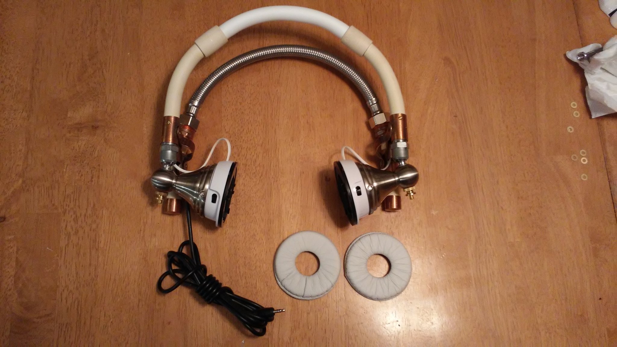

Dear ladies and gents, since Mr. Bowman has broken the Piñata and now the mystery item has been revealed, I'd like to ask for some feedback from those in the know of materials and such:
CPVC headband version
PEX-B headband version
The pipes are held with screws
Both materials have serious issues:
1. CPVC is very stiff and heavy, and the colour is more like a cream-yellow than the snow white of the ear pads. However it is very easily molded with a heat gun. You can make very sharp bends on CPVC with a pocket lighter (see headband slider mechanisms with the two short tubes). Can be fused with PVC glue and decorated with solvent glue, like paint.
2. PEX-B is soft, elastic and very light. Perfectly snow white. But it's a b$%^* to mold into shape. It takes a lot of time and a lot of heat to convince the plastic to stay put in shape. I had to use a combination of boiling water and heat gun just to approximate a smooth curve. It can't be painted or glued.
CPVC is a thermoplastic, which means that it molds to shape and stays put rigidly after that. The problem lies in that CPVC is a "hyper-vulcanised" plastic, where they've added chlorine ions to create cross-links in the otherwise normal PVC polymer chains. That makes the plastic very hard and somewhat toxic if it is overheated. It will become brittle over time. The cream/yellow coloration is the result of the extra chlorination. Besides PEX tubes, this is the only material available in copper sized tubes (which allows for a number of copper, brass and plastic fittings to be used interchangeably).
Specifically, PEX-B (shown) is a cross-linked Polyethylene that is sort of "waxy" and "gummy" - the same material used in ball point pen cartridges. Nothing sticks to it - you can't glue it or paint it. It seems that alcohol, can penetrate the surface and deposit ink (permanent marker) below the surface. You can, however, sand to a very smooth finish, though using 800 grit sandpaper. PEX has a "memory" in that the material can creep out of shape in favour of the original shape it had when the cross links in the polymer chains were created. If you heat it it will want to go back to being a straight pipe - but only the less-available PEX-A grade will return evenly to its original shape. The more commonly available PEX-B will warp back into shape unevenly (may not be a problem, though and even an advantage if you can introduce a permanent warp in an aesthetically pleasing way). Oddly PEX-A will turn transparent when heated, giving you an indication of when the cross-links have been broken; this does not happen with PEX-B.
*sigh* I've been at it for a long time. I was hoping to have this ready by SXSW (started this last Friday). That's why I couldn't write anything on SXSW yet. I've been working on this project. A lot more expensive and difficult than it looks folks. Appearances are deceiving.
In both cases moulding is done by heating the pipe and the cooling while holding the piece in place. In both cases the moulding temperature is slighly above the boiling point of water, so you really can't just cook the pipes like noodles and expect to get very far.
I have issues with heating the PEX without having it deform unevenly. And the plastic does have a "creep" or "memory," whereby it relaxes into whatever shape you give it, but  which thankfully returns to normal overnight.
Not terribly happy with PEX (notice the headphones are a bit more open with PEX), but the CPVC is unwearable because it is so tight around the head. Too rigid. I'm thinking of making a "hybrid" headband with both PEX and PVC components... Any ideas?
I remain AYS

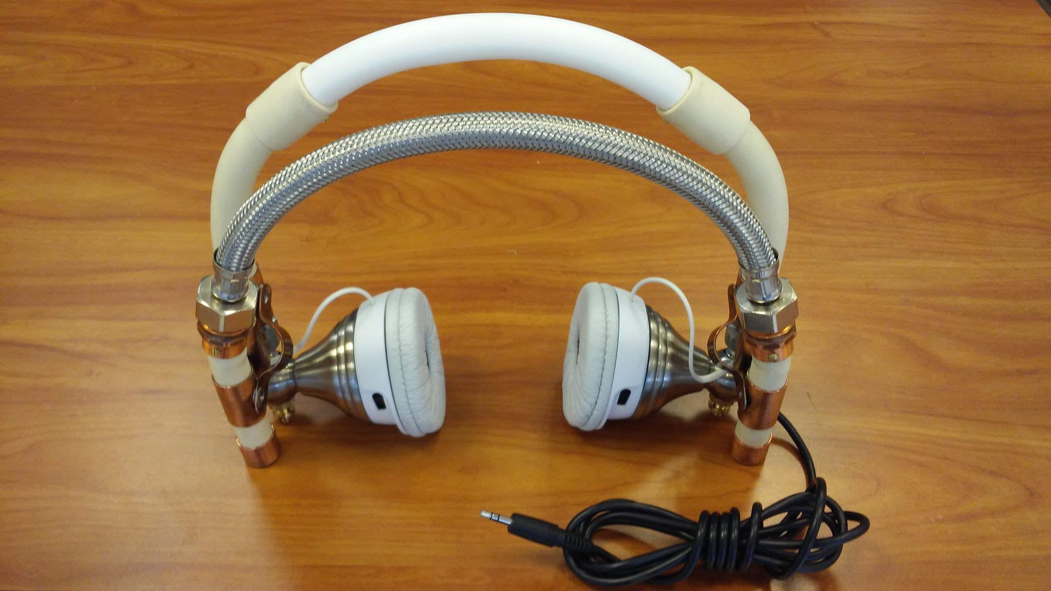

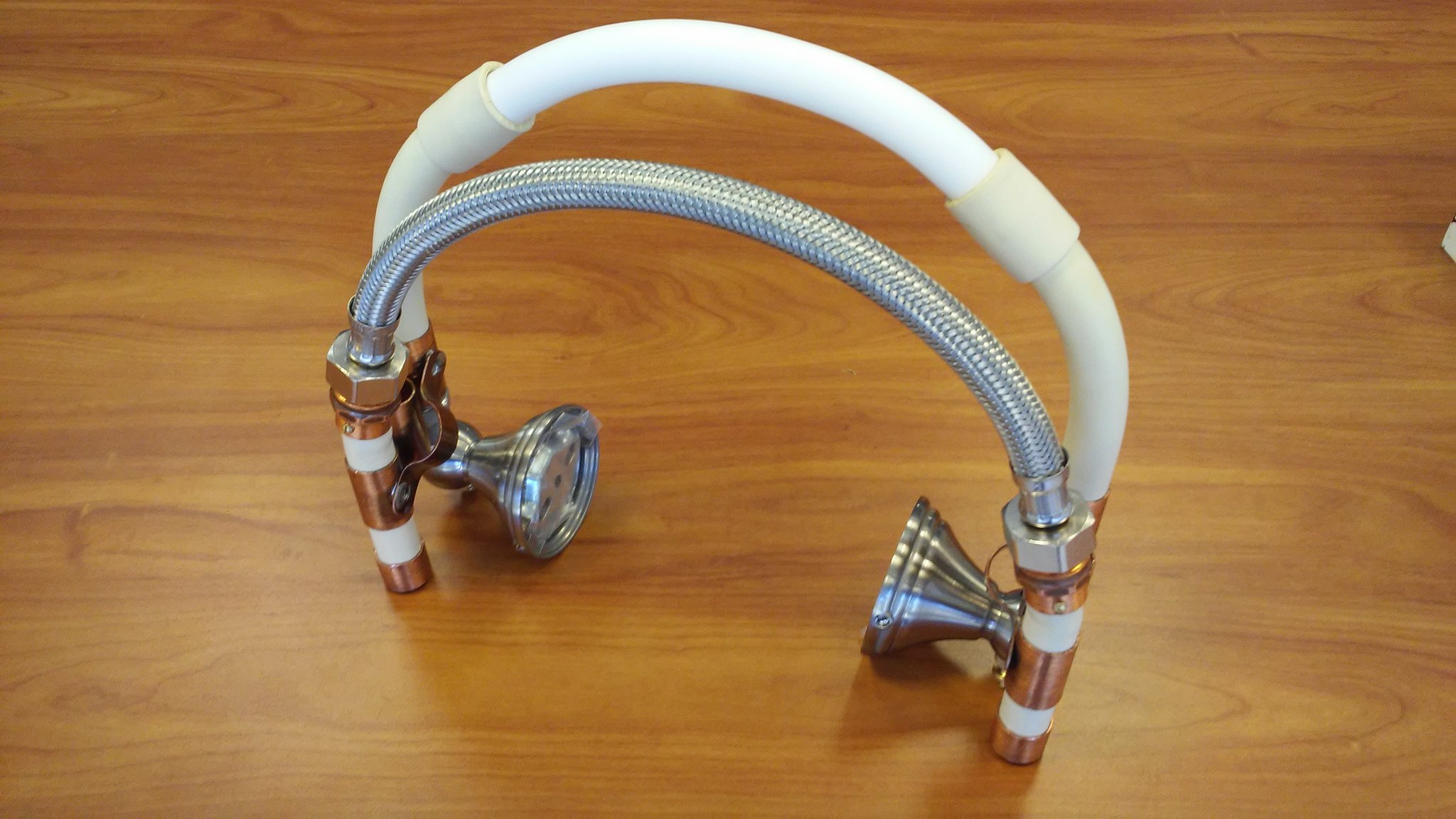

I'm still struggling with it and coming down to the wire. I would like to take the headphones down to SXSW this Saturday or Sunday. I need to add a pad for the metal braided headband. But the elastic headband is giving me hell.
I experimented with another brand of PEX pipe and discovered a technique for handling the PEX. It's still PEX-B but this new brand is of a higher quality and allows you to more smoothly bend the pipe without kinks. It's a trade secret I won't reveal it though, as it's a major advancement (no it's not anything you see on the Internet).
The other is that I made a pipe with "bi-plasticTM technology" and mated a PEX pipe segment to rigid CPVC pipes. This greatly improved the behaviour of the headband. It doesn't feel so gummy and keeps it shape while reducing the tightness around the head. I like it but the process of making was hellish because I didn't know how to do it at first. And the pipe ended up about an inch shorter than I had planned. I have an idea of how to avoid that much work for the next one (I might do this right now) But this is what I made yesterday:
Bi-PlasticTM Technology  Tongue
I'm still sweating bullets, though. I have to decide in the next few hours if I want to pay $25 to go to SXSW. Tomorrow at the latest I would need to make a final decision.
EDIT:
I've redone the Bi-Plastic band. To the correct length. I think I may have a final version here. It will require a jig to align the parts and screws to hold the PEX in place. Three trade secrets involved in doing this right.
Second version of Bi-Plastic

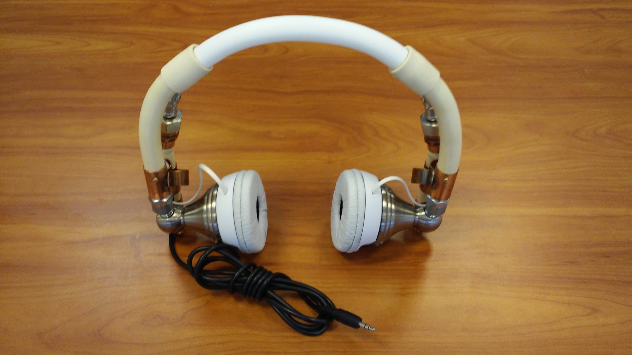

Managed to take the phones to SXSW, and even had a photographer snap shots of me in full uniform with the headphones.
I added a small leather pad to the headband. The headphones work very well, but they are, as expected, very heavy. The sliding mechanism works entirely by friction, which is a pleasant surprise - very easy to slide by hand, but once you place the weight of the phones on the band, the lateral forces of the "arch" are enough to lock it in position by friction! There was no need to "squash" the copper tubes increase friction. Friction only works on copper-CPVC. PEX is too slippery to do that. The plastic headband needed further adjustment to make it softer, but not so soft that the headphones fall from your head. It's a very tricky balance... I think I want to increase the size of the leather pad for stability.
I'm currently trying to design derivatives from this project... I want a Bluetooth old-timey candlestick telephone made from cheaper Bluetooth earphones. Very easy project, I just don't how it would sell... I'll make that in the next few days.
Added a leather pad to the headband... May need to be bigger.
