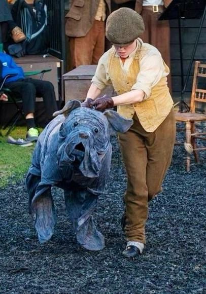

For the puppet, I'm thinking about something like this, but bigger so I can stand up straight while operating:
or like this:
Most puppets I've seen have just dangling feet underneith the torso, just touching the ground.
I want mine to have walking feet, operatable from the spine area.
The head is operatable from a handle that sticks in the back of the dogs head.

Most dog puppets I've seen have the operator just drag or hop the legs around.
I think, the little dog in the first picture has operatable legs.
The dog in the first picture shows some of the strings and controller bar.
The way I see it, the controller bar is directly operating the dog's spine. Operating turning and pitching.
The body can't roll, because this operates the legs.
I don't know if the dog's legs are made to lift legs diagonally or two from the same side.
The head in the first picture is operated by a rod that is fixed to the back of the head.
I can't tell if the mouth and ears can also be operated by this rod, but I think it does.
Soon I'm going to make a fullsize sketch to see where goes what and how big my dog has to be, to walk comfortably.
Probably a Great Dane or Irish Wolfhound.
For now, my biggest concern is how to walk this dog.
I probably have to hold my hands like the young fellow with the gray dog.
And have the dog stand sideways in front of me, when I'm not walking.
This to make it a bit more comfortable for me.

Meanwhile, work has kept me from further building the dog. But thinking about a few problems along the way.
The dog's legs are going to be controlled like a marionette. Ropes going from the leg to a controller.
Only unlike a marionette, the controller is going to be mounted on the spine of the dog.
This way I can move the dog's body directly, like the handle on a suitcase.
And here comes the problem. I have to turn a about 30cm motion of the legs, into a 5-6 cm controlling motion.
Extra problem, I want to control the for joints each dog has, in a most realistic way.
Moving the top joint will make the bottom joints just dangle underneath it.
Using push/pull rods bitween the lower joints, will limit the flexibility of the walk. It might look more like a machine then a dog.
I think I'm going for using elastic band as tendants. Tentioning the band just enough to pull the leg up, but not to much so it stays tucked in.
Either that or a flexible push/pull rod.
Perhaps to complex of a problem I can express into words. I'll show a picture later in this build. After I've glued the legs and joints together.
