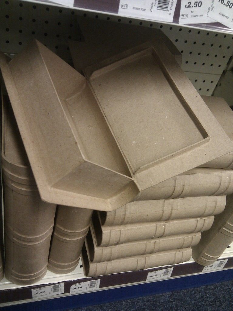

Aha- browsing in a local craft barn, I saw this, and thought of you  Grin  :-
In the decoupage area.
