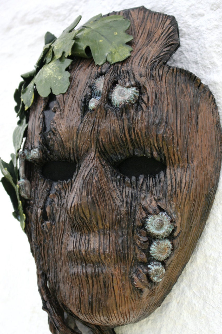

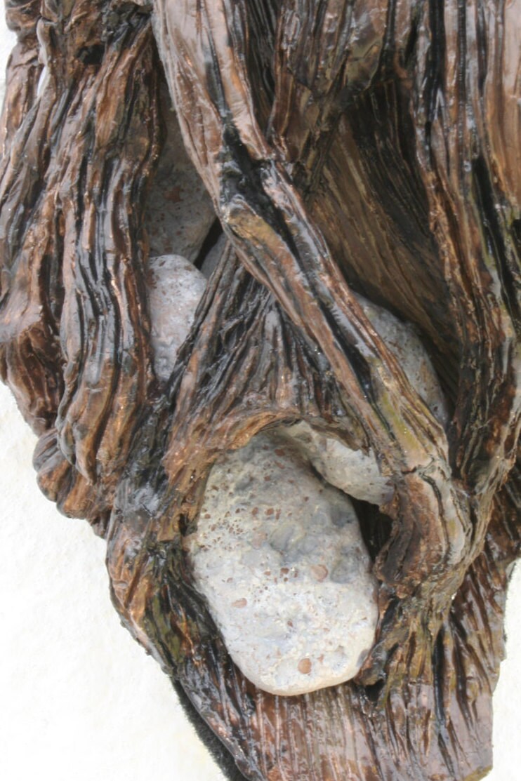

What about about doing something like this. Hair would be an easy step from the wood effect. I make these using paper mache and air drying clay. It will shrink slightly and cause small cracks, which you can fill in with more clay or emphasize them as a feature.
If you want to know any more just let me know. I have other masks you can see here if it helps. https://www.etsy.com/uk/shop/Marvellousmasks?ref=hdr_shop_menu
