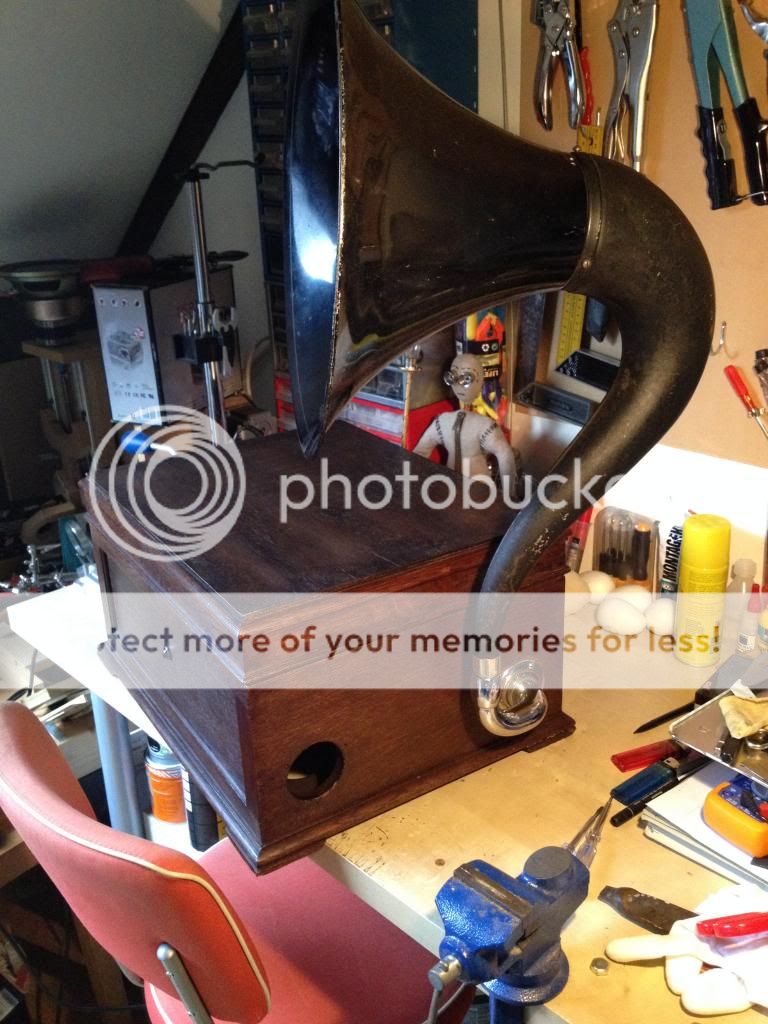

Hey hey,
So, somewhere end 2013 I started a project I called "Steampunk Docking Station" and then I got distracted by other projects and parked this thing until a couple of weeks ago...
Back then it looked like this:
But to make a docking station out of it with the lid closed as my wife preffered I would have had to cut into the lid of the box which I was reluctant to do. Now however the plans have changed and I decided to return it to the original function, a gramaphone!
