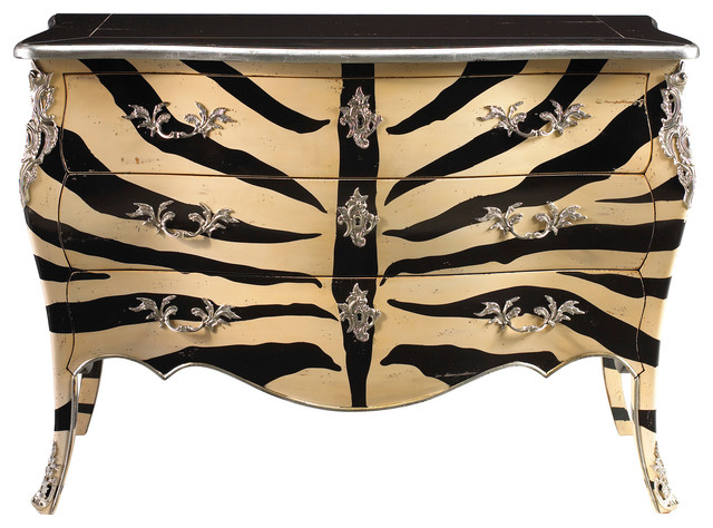

 Is that tape the type they  use for marine repairs and antiques?  It has sparked an old memory  of seeing it lying around  somewhere ?
 Most advice has recommended the primer you suggested  and enamel paint , with plenty of sanding at each layer.  The chalk paint mentioned to me   is probably just an expensive fad  for painting  school size suitcases . I will check out the hardware  chain store for  options
 The [carving ] on the  detail is the only redeeming feature and I had hoped to preserve it.  If worst comes to worst  the mirror is in good nick  and can be salvaged for   good use.  Now I have inspected in in the day light the trim detail is more  Baroque or Rococo  than Indonesian. But then  the style of  Italian designers of that era were heavily  influenced by the sea trade  and  the Eastern  designs https://en.wikipedia.org/wiki/Italian_Baroque_interior_design
 The zebra does have me thinking...

« Reply #17 on: August 11, 2016, 09:35:35 am »
The zebra treatment is fabulous.
After all, why give the piece a conscientiously workmanlike treatment when you could be splendidly over-the-top?

« Reply #18 on: August 12, 2016, 01:38:21 am »
I remain yours,
Prof. Cecily
Dearest Prof. Cecily
That was my thoughts.  If one is going to go to all that trouble  if you are not going to go all the way with it -
Take it to the giddy limits !!!
Otto Von Pifka

my first instinct is to put down newspaper under the middle Cheesy
combine that with some animal head drawer pulls and it would rock the ark
looking at how torn up the edges are on the old laminate paper, you would be better off peeling away the worst of it. a heat gun would help considerably.
solvent to wash away any residual glue and then seal the bare wood to take primer and paint.
they look to be large blank pallets to lend artwork to, that zebra look is an awesome possibility!
