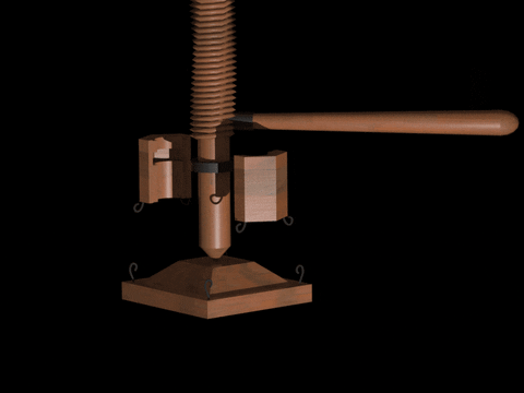

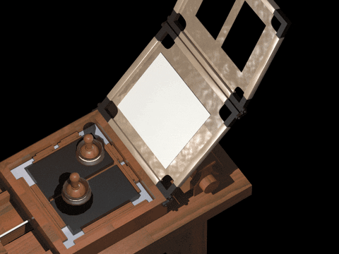

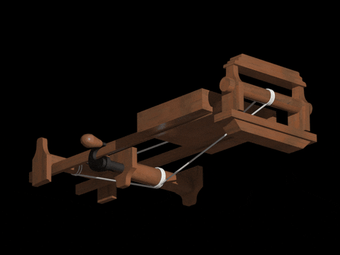

Having illustrated the principles of 19 century platen presses, it might as well be prudent to do the same for the original printing behemoths.
The basics of a Common press remained virtually unchanged from early 15th to late 18th century.
The hose and spindle assembly:
Tympan and frisket closing down onto the inked up form:
Coffin movement:
