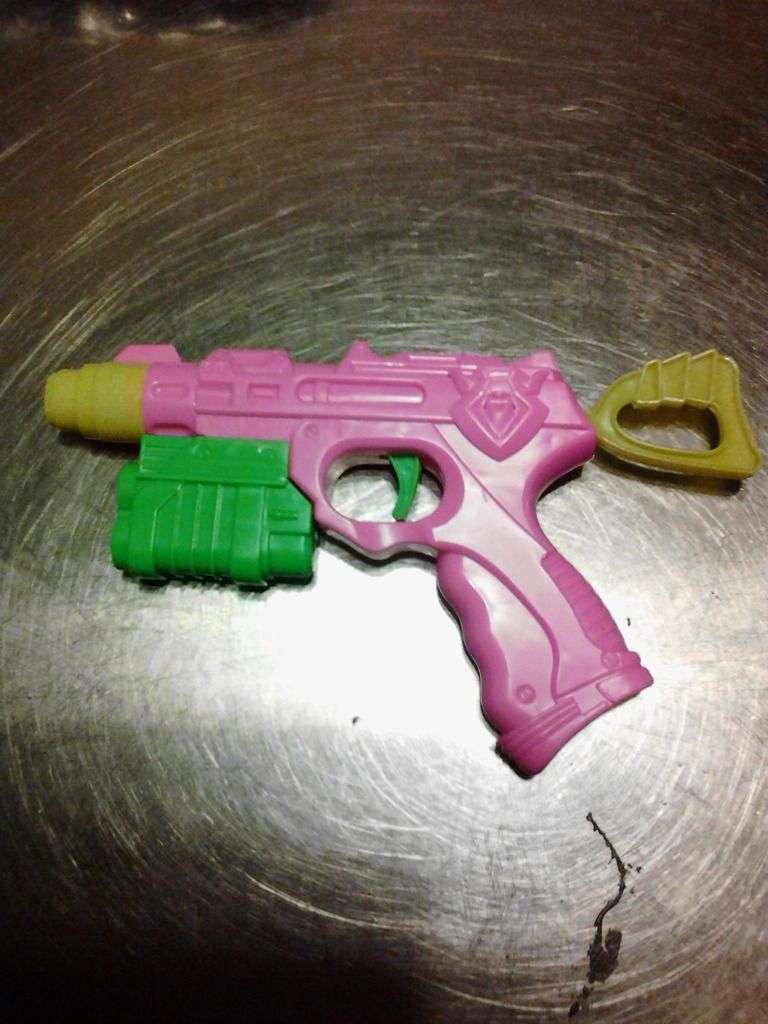

The battery powered incandescent flashlight was invented by Enghlish inventor David Misell in 1899.
My next project is to make a flashlight gun. This Momentum Brands foam dart gun was purchased at a thrift store for .85ยข. It operates by pulling back the yellow charging handle, which pulls back a spring and rod with a notch on it. The notch catches a hook on the trigger mechanism. When the trigger is squeezed, the hook is pulled down, releasing the spring loaded rod down the barrel. That is supposed to fire a dart.
I aim to make the rod press a button on a flashlight. Two challenges:
Finding a flashlight of the proper length and diameter with a push button on the end.
Loosening the spring so the rod doesn't destroy the flashlight. I plan to snip off a few coils.
Most of the gun comes apart with screws. Problem is, the muzzel is glued in place, with some serious glue. I wouldn't be surprised if the glue has melted the plastic together.

That went well. A little hairdryer heat and it's apart. Here it is in the cocked position. I could trim down the muzzle to accept a larger diameter flashlight. I may have to take a little off the rod, as well. That rod slams home with more force than I'd expect from a cheap toy.
