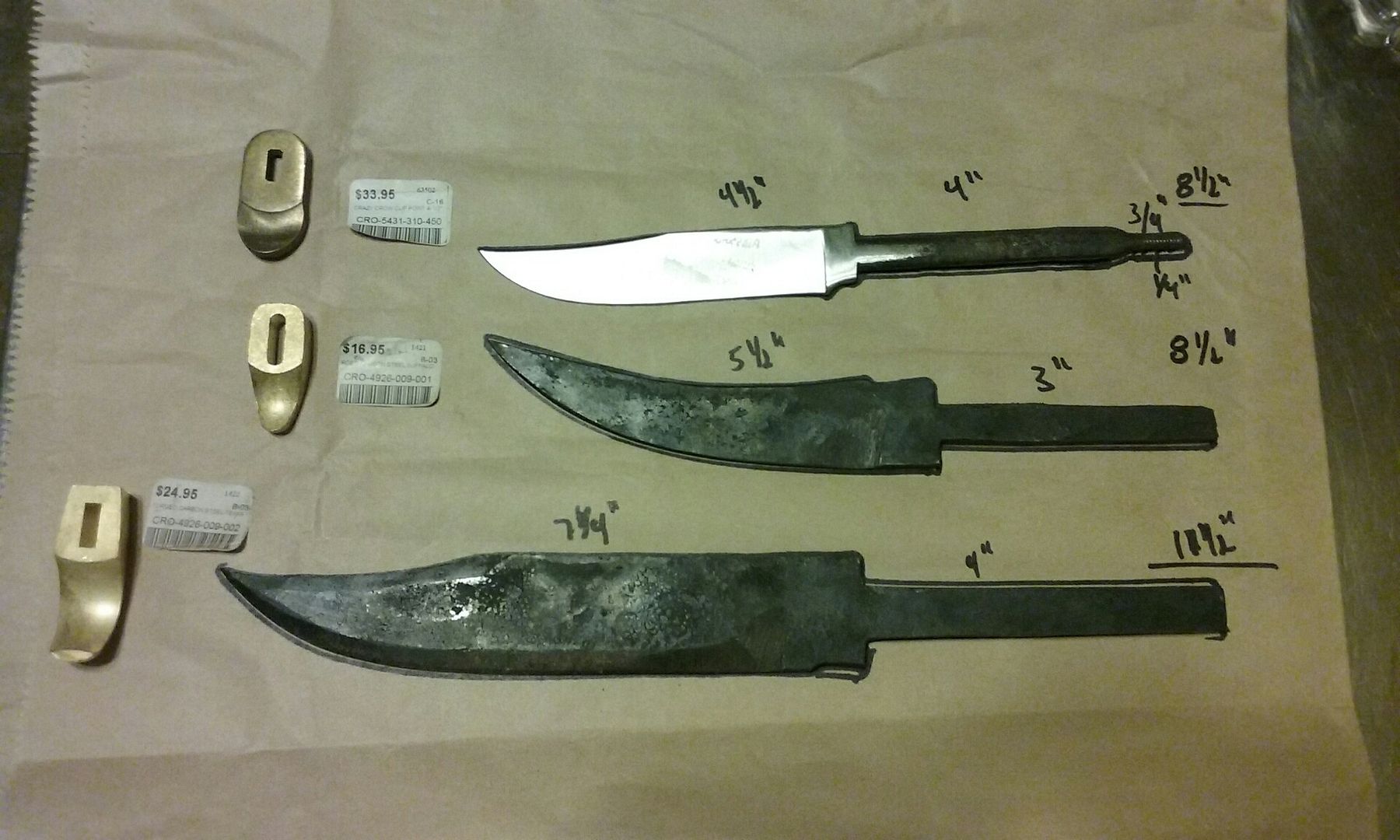

Okay. Good. I figured out how to add pictures. Nothing good will come of that.   Grin
That bottom blade is the one. Close out sale at a local knife shop. Got the pommel there, too.

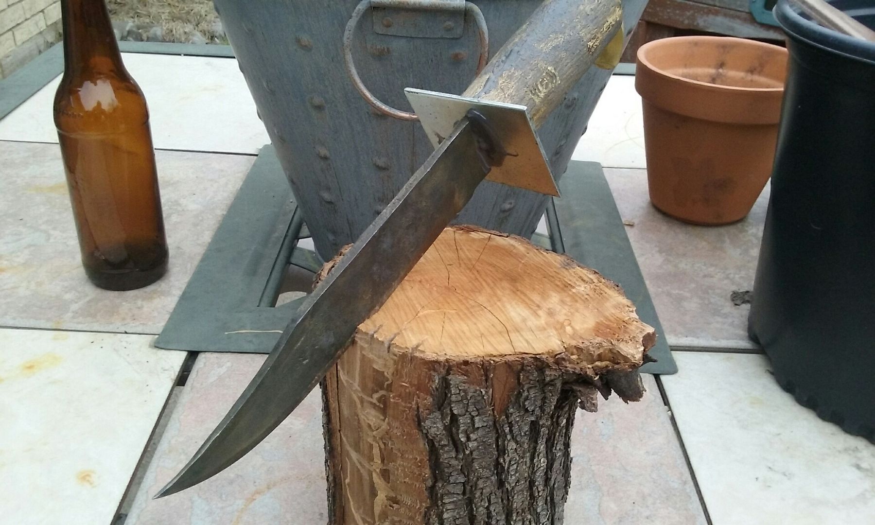

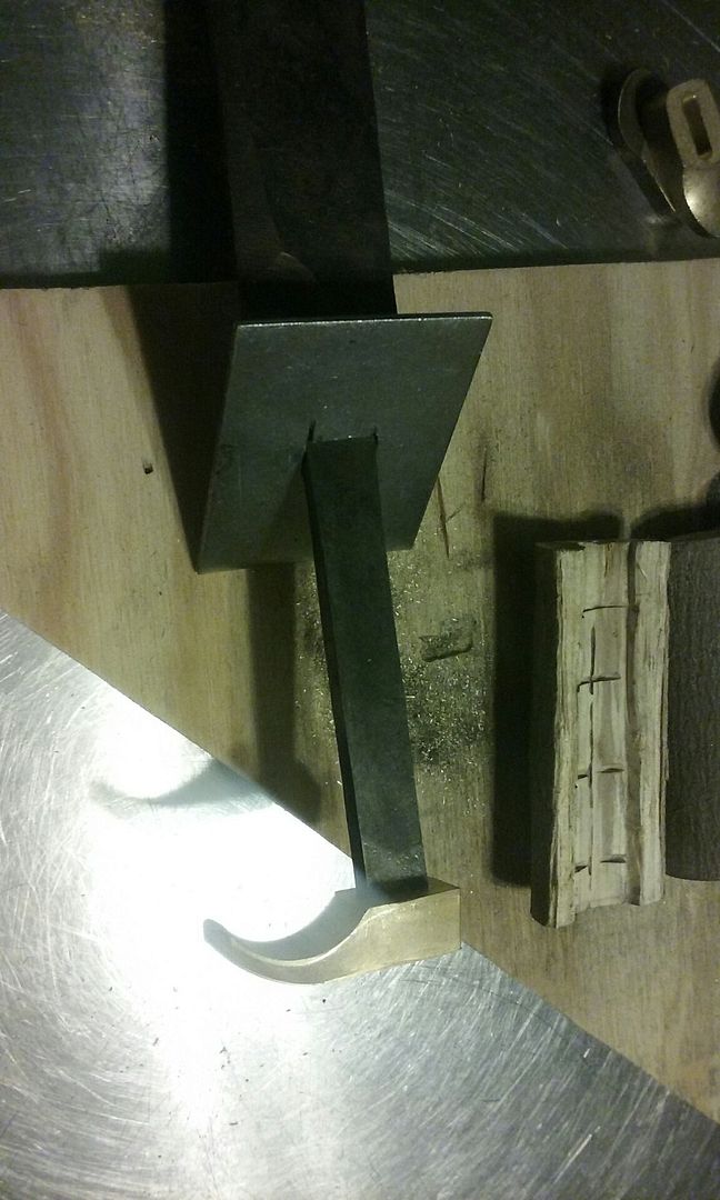

Roughed together. I cut the handguard from a piece of steel from my junk pile ... One of my junk piles. Or piles of junk. The tool of choice was a Dremel and a black cut off wheel. The pommel, I had to wallow out some, again with the Dremel, and beat on with a hammer. It ain't coming off.

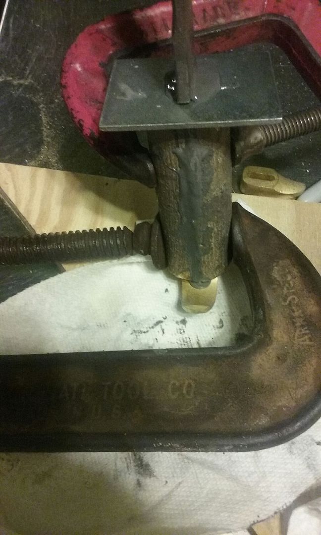

I've cut and JB Welded the ash wood handle in place. Don't mimd the excess. That just means I used enough. It will be removed later. It will stay C clamped until tomorrow afternoon. This isn't the best way to affix a knife handle, but I don't have a drill press to make holes to pin the handle through the tang. This though will more than suffice for a functional accoutrement. There are worse ways to do it.
Once it all dries, I'll shape the guard and handle. I've not decided on a final style. What the knife is "supposed" to look like is as widely debated as the story of how it came to be.
« Last Edit: December 31, 2015, 05:17:55 am by Bines » Logged

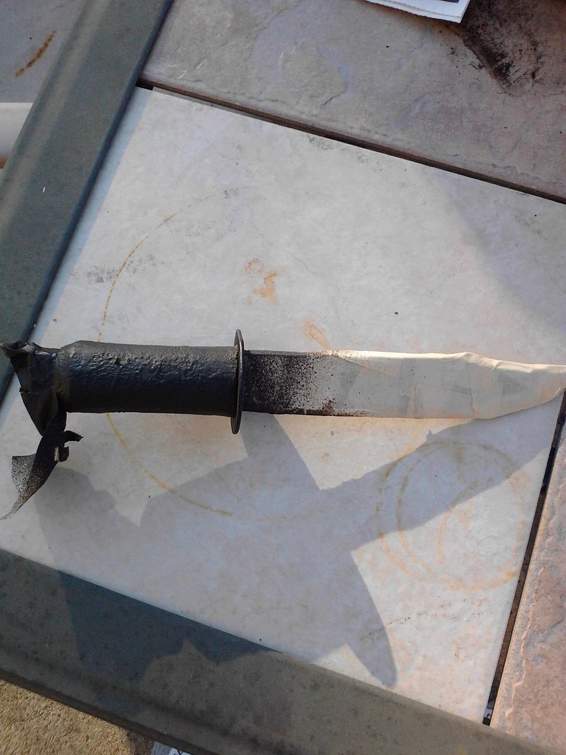

Here it is today. I've cut and ground the handguard to be round. Then, I sprayed the guard and handle with Krylon flex seal. This looks to be similar to what's advertised on television for $19.95. It was $9.99 at O'Reilly's purveyor of motor carriage parts.
This flex seal could prove useful. It covers blemishes well, is waterproof, adds grip, and since it stays a bit soft, but not wet or tacky, will be a good base to wrap wire on.
I'll sand it down smooth, maybe spray another coat, and sand once more before wrapping. The handle has to be smooth or the wire will look sloppy.

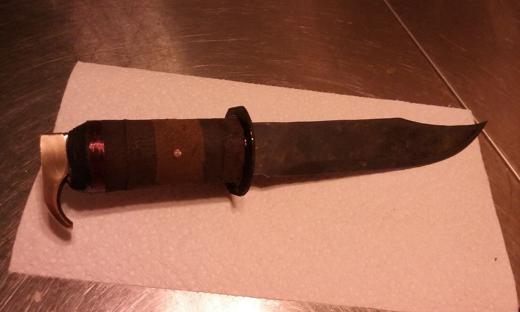

« Reply #13 on: January 10, 2016, 05:53:01 am »
I found some leather in the form of belts at the thrift store down the road. One has been cut and wrapped around the handle. It came out so-so. I used Gorilla glue to secure it, and some glue squished out, discoloring the wrap. Oh well. My character is a salvager of sorts, so it works that it doesn't look perfect. The blade itself is rather rough forged, too. I may still accent it with wire.
The best news is the knife is holding together. The primary goal was to craft a usable piece. I feel confident in that accomplishment.

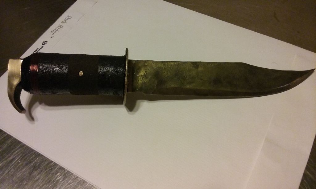

Here it is today. I covered up the glue splotches by spraying on the Krylon, and then blotting it right off. I made the gold dots by painting a stripe around the handle before wrapping the belt leather around it. The wire is craft wire. I drilled two holes for each free end to fit in, wrapped tight with one free end in a hole, put the other free end in a hole, put a dab of glue to hold the free ends in place, and then brushed some glue over the whole wrap. Did the same near the hand guard. The handle will get some touch up, and then it is done. This handle should hold.
Blade work is next. It doesn't look like the brass finish is going to stay. I may paint the false edge with some gold paint, for flare. I'm using Dupli-Color automotive touch-up paint with clear coat. It's tough stuff.

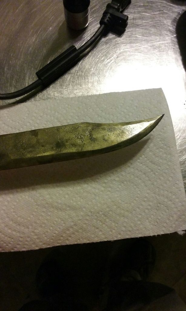

Wait a minute now. I just went over the blade again with a brass wire wheel. The brass look is back. This is not paint. This is metal transfer. The brass from the wire wheel transfers onto the carbon blade. I've just sprayed it with Krylon Fusion clear coat. Let's see if it stays. I hope it does, because it looks awesome!

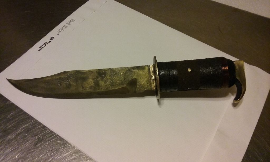

Ladies and gentlemen, and other sentients, I present here tonight, The Shivas Regal!
Get it? 'Shiv'. This thing is a shank and half. Built like a barge and twice as beautiful.
Now it's time to sharpen and make a sheath.
What do y'all think?
