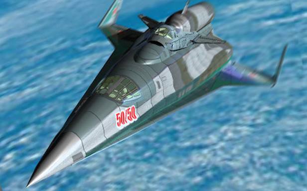

The "Spiral"So were the 60 years - the height of the space race and the Cold War. At this time the United States had an active project development Dyna Soar, which meant the creation of a hypersonic interceptor manned orbital reconnaissance bomber, the X-20.In response, the Soviet Union decided to create its own aerospace systems. In 1965, the corresponding instruction was given to the experimental design bureau 115 (OKB-115) named Alexander Mikoyan, where the study was headed by Chief Designer Gleb Lozino-Lozinski. The project was called "Spiral". He was to be the main argument for the possibility of war in the Soviet Union in space and from space.
The chosen scheme launch space plane and constructive solutions incorporated Lozino - Lozinsky , have given the project the USSR "Spiral" at a glance:In orbit, can be derived payload 9% of the total weight of the entire systemThe cost of output for each kilogram of cargo was 3.5 times cheaperRapid withdrawal of the orbital plane at any point on the globeLanding in all weather conditionsThe " Spiral" consisted of three main parts: the hypersonic booster aircraft ( GSR) , two-stage rocket booster and the orbital plane (OS). As planned Lozino - Lozinski , booster aircraft to the orbital plane at the back had to take off from the base airfield and accelerate to a speed of about 7500 km / h After reaching a height of 30 kilometers of the orbital plane was separated from the GSR and using a two-stage rocket booster accelerated to orbital velocity ( about 7.9 km / s). After that, the orbital plane went into orbit and performed one of their combat missions : reconnaissance , missile interception space targets " space-space " and the bombing of missiles " space-to- Earth" with a nuclear warhead. At its core, the orbital plane is a true space fighter .The orbital plane of the " spiral ", as well as booster aircraft was piloted . Place the pilot was a separate capsule, which in case of emergency situation was to separate and save the life of the pilot even in space .Closure of the " Spiral"Development of the project "Spiral" was in full swing, and in the second half of the 1970s , scientists led by Gleb Lozino - Lozinsky planned to begin flights fully manned aerospace systems "Spiral" . The case remained for small - to approve the draft in the top leadership of the USSR. But the minister of defense of the Soviet Union Andrei Grechko in the early 70s , instead approve the project "Spiral" , threw out all the documentation on it in the bin and said : "Imagination , we will not deal with ." Project of the USSR "Spiral" was closed.
http://www.buran.ru/htm/molniya.htm

Now that's the spirit! Thank you for posting. I didn't know many of the details regarding this Spiral project.
It seems we are back in the days of "lifting bodies" again, since the Space Shuttle and Buran became a distant memory. I need to see if I can somehow get into the Sierra Nevada Corporation, but in spite of my education I have no experience.  Those small companies usually don't look for people with little experience...

That's amazing that they were thinking of a two-stage booster system, and the orbiter. Combined plane and rocket. That is an unusual configuration. At 7500 km/h that already is significantly faster (and higher) than the X-15 (5000 km/h).

Here's a great picture of the MiG-105 Spiral
It's closest cousin would be the X-20 Dyna Soar below is a comparison between the two:
Differences between Dyna-Soar and Spiral
https://en.wikipedia.org/wiki/Mikoyan-Gurevich_MiG-105
Although having basically the same mission, Dyna-Soar and Spiral were radically different vehicles. For example:
While the X-20 Dyna-Soar was designed for launch atop a conventional expendable rocket such as the Titan III-C or Saturn I, Soviet engineers opted for a midair launch scheme for Spiral. Known as "50 / 50", the idea was that the spaceplane and a liquid fuel booster stage would be launched at high altitude from the back of a large, airbreathing mothership travelling at hypersonic speeds. The mothership was to have been built by the Tupolev Design Bureau (OKB-156) and utilize many of the same technologies developed for the Tu-144 supersonic transport and the Sukhoi T-4 Mach 3 bomber. It was never built.
Dyna-Soar was designed as a lifting body, while Spiral was a conventional delta that featured an innovative variable-dihedral wing. During launch and reentry, these were folded upward at 60 degrees. After dropping to subsonic speeds post-reentry, the pilot lowered the wings into the horizontal position, giving the spaceplane better re-entry and flight characteristics.
Spiral was built to allow for a powered landing and go-around maneuver in case of a missed landing approach. An air intake for a single Kolesov turbojet was mounted beneath the central vertical stabilizer. This was protected during launch and re-entry by a clamshell door which opened at subsonic speeds. By comparison, Dyna-Soar was designed primarily for a once-off, unpowered deadstick landing.
High temperature superalloy metals such as niobium, molybdenum, tungsten and rene 41 were to have been used in the heatshield structure of the X-20. Spiral was to have been protected by what Soviet engineers termed "scale-plate armour": niobium alloy ВН5АП and molybdenum disilicide plated steel plates mounted on articulated ceramic bearings to allow for thermal expansion during reentry. Several BOR (Russian acronym for Unpiloted Orbital Rocketplane) craft were flown to test this concept.
In the event of a booster explosion or in-flight emergency, the crew compartment of Spiral was designed to separate from the rest of the vehicle and parachute to earth like a conventional ballistic capsule; this could be done at any point in the flight. Such an escape crew capsule was also considered for Dyna-Soar, but American engineers eventually opted for a solid-fuel escape rocket that would kick the spaceplane away from an exploding booster, hopefully saving both pilot and spacecraft.
Much like the Space Shuttle, Dyna-Soar was designed with a small payload bay behind the pressurized crew module. This could be used for lofting small satellites, carrying surveillance equipment, weapons or even an extra crewmember in a pop-in cockpit. Spiral, on the other hand, was intended to carry only its pilot.
Both Dyna-Soar and Spiral were designed to land on skids. The landing skids on Dyna-Soar were designed to deploy from insulated doors on the underside of the vehicle, like a conventional aircraft. Soviet engineers designed the landing skids on Spiral to deploy from a set of doors on the sides of the fuselage just above and ahead of the wings.
I wonder how they planned to propel the space plane past X-15 speeds, with air-breathing engines, and about the mating and separation of the rocket booster - having to tackle many of the same problems that we've discussed earlier. It's worth revisiting the planned flight mission, one phase at a time.
A small detail that called my attention. The craft was capable of powered descent (final approach). A single small turbojet placed on the leeside next to the vertical stabilizer.  Normally from an aerodynamic perspective, one would avoid that location due to turbulence and the possibly a fully separated turbulent boundary layer creating havoc with the airflow to the rear engine.  Yet the need to protect the engine during re-entry overrides that decision....
