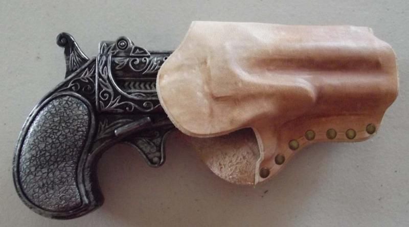

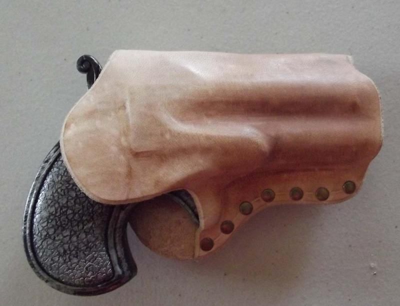

Ok, so living in a country with tight gun control laws means I don't really do holsters. This is the first one I've done to suit anything that didn't fire Nerf foam bullets, and this is a toy as well! As it was the prototype I just riveted the thing together, the actual holster will be sewn, but it's the first one I've drawn a pattern for so I didn't want to waste the time on stitching if it wasn't going to fit! Wish I had sewn it now as the pattern worked perfectly.
The gun is a toy derringer and will be part of my customers Steampunk costume. For the customers model I'll move the stitching line in a little to account for the rivet size, the actual size with the riveted seam is just about perfect, the gun slips in with a little 'click' when it goes home.
No dye as yet and the holster is still damp.
Critique please Smiley
Kindest regards, Raven
« Reply #1 on: December 31, 2014, 07:43:32 am »
Very nicely done, sir. All that is left is to dye the piece, bone the edges, and wax.

You did a very good job with the molding and the rivets. My only suggestion would be to remove a bit more leather around the grip. you should be able to get a full grip on the gun before pulling it from the holster (Learned from experience, I've made over a dozen holsters for people who carry guns every day). Please post pics of the finished product, I'm sure it looks awesome.
grimnir
Maker of fine Leathercrafts
« Reply #13 on: January 03, 2015, 10:37:43 am »
Yeah, it was modeled after a full-size pic. I don't think I shrunk that section enough. For a toy, not a big deal, but for a real gun it would be an issue Smiley
