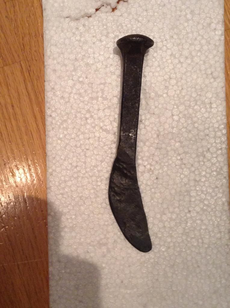

Had the opportunity to work at a forge for the last few days. This is what was made of that time:
First Railroad Spike Knife:
First Railroad Spike Tomahawk Head:

« Reply #3 on: August 07, 2014, 05:39:30 am »
For blades you may want to add a piece of high carbon steel.
Rail spikes tend to be a little short on carbon for a working tool.
Forge welding takes a bit of pratice and some skill so keep swinging the hammer.
Keith_Beef
France France
« Reply #4 on: August 07, 2014, 09:20:58 am »
From what I've read in other places, "railroad spikes" are made from a variety of different steels, the lowest carbon content being aroun 0.1% and the "high carbon" spikes being around 0.3% carbon. This is quite low for blade steel (usually you want about 0.7% - 0.9%) but it will work. Water quench will get you a hardness of around 50 HRc.
Your first attempts at forging a knife are not too bad. But the blade curves up a lot, is a bit short compared to the handle, and the tip is rounded like a table knife. If that's what you were trying to make, then great; it looks a little like a very short version of a butcher's flaying knife.
The tomahawk, on the other hand, needs more work or a better photo. I can't see an eye for the haft, and it looks more like a warhammer than a tomahawk.
Keith

The eye for the haft is on the side you cannot see. The knife had a few accidents and became a little odd, just need to remember and avoid said accidents in the future, And my next project is a candle holder and an Iklwa spear.

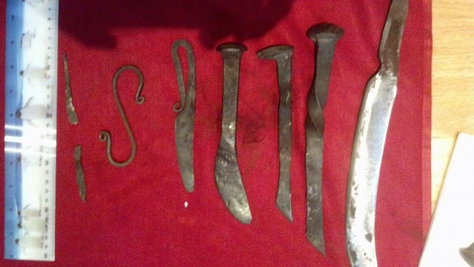

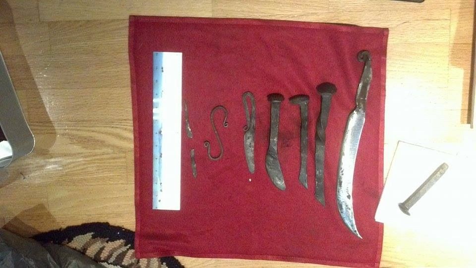

« Reply #11 on: September 14, 2014, 04:21:00 am »
Here is the rest like I promised. First upload a few weeks ago crashed my phone, so used the computer instead.
The smallest and the largest both have sheaths made out of leather that are not included in the picture, and the smaller tomahawk head is fit with a shaft now.

« Reply #13 on: September 14, 2014, 12:33:08 pm »
I like the one on the right.

« Reply #15 on: September 14, 2014, 06:09:10 pm »
Between your first attempts and that big honking hunk of cutlery on the right, you've improved one hecka lot!
I admit, the long knife is making me green with envy.
