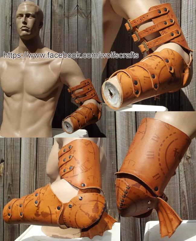

Presenting the Chronos Gothic Arm full leather armour from Wolfs Crafts. Featuring fully connected bicep, elbow and forearm protection, all depicting the essence of Chronos' power, Time itself.

That is awesome! How do you get markings (such as the time ones on this piece) on the leather? Something I've always wondered and never known :S

These are airbrushed using a stencil - this one http://thescrapbookstore.com.au/crafters-workshop/12-x12-templates/the-crafters-workshop-12x12-template-time-travel.html
I've been using stencils a lot since I finally managed to persuade the wife I needed a compressor Tongue

Can you straighten your arm fully wearing that? I love the design but I always worry about the practicality of cowters.

Yes, this one has full movement range, The elbow cop attaches to the upper and lower armpieces through the use of 2 internal pieces which give good range of movement and allow for fully straight to fully bent arms. The edges of the upper and lower armpieces where they meet the cop have also been curled up to prevent any possible hangups on the cop
