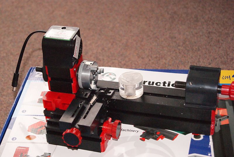

« Reply #53 on: March 01, 2014, 01:22:09 pm »
New tools!
It the Chinese clone of the Unimat and if it's anything like the Unimat then I have no second thoughts about paying only 1/3 of the unimats price for a cheep clone!

The machine is made by Shenzhen Zhouyu Intelligent Technology ltd and sold on ebay..
The machine set up and working on the cylinder.
Using a Dremel wood bit to drill the center hole.

« Reply #56 on: March 02, 2014, 06:14:13 pm »
or you can just tickle it open to the proper size using the cross slide and a boring bar. a quick and easy boring bar can be made from a large nail. just grind half of the nail head off so it Is a half moon and use the sharp corner as the cutting surface. works ok for wood and plastics. a good strong nail, preferably hardened.
that unimat clone looks to be quite useful.  I have some extruded aluminum framing, I could build something like that for myself! makes me wish I kept that ac motor/variable speed gearbox combo I had rotting in the garage, would have bolted right down nicely and I could have threaded the output shaft to take a small three jaw chuck I have tucked away.
I thought of doing that but when this was only £109! lazyness kicked in.
My only problem now is to source the extrusion/long bed. will need to speak to the seller.

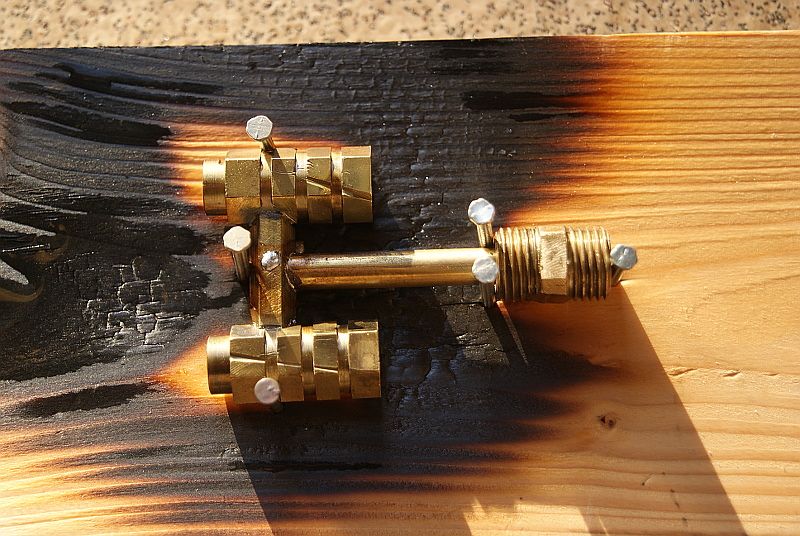

After writing myself into a corner I did some work on the brass work.
This is the detail without the barrel.
The centre piece isn't soldered together as the wielding torch heats up the other pieces and blows them apart. (I need some metal work clamps and supports.)

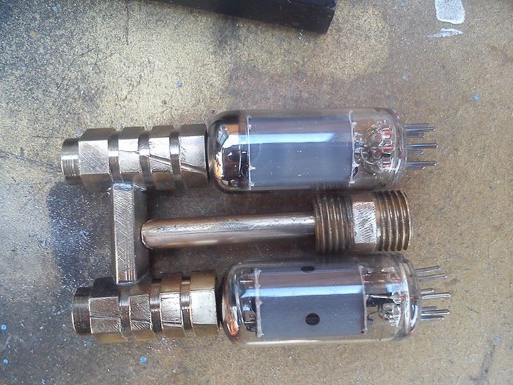

« Reply #72 on: June 24, 2014, 08:37:10 pm »
Thats the core brass soldered together.
no to work out how to mount the vacuum tubes.
