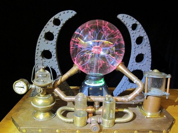

Just completed this project using an old brass camp stove base, plumbing parts and various other bits and pieces..

Excellent work.  What diameter is the bulb?

At a guess I'd say 8".

Yes, the ball is an 8" (20.3cm) diameter type.

Excellent work. The lamp looks fantastic. I hate to be the one to mention it, but putting metal very close or against the glass, can cause electrical shock, glass breakage due to stress and heat or even fire. If this item is for personal use, then as long as you know the risks, I'll try not to make a big deal out of it, but, For your own safety, please consider putting some type of insulation between the metal and the glass. If it's close enough to attract the plasma, it's an accident waiting to happen. However, if you intend to sell the item, the metal will need to be properly insulated from the glass and you need to clearly state to the buyer that this item is "VERY" dangerous and could cause serious injury or even death (due to fire). Putting metal close to or on the glass, can cause the electrical charge siphon to the outside of the sphere and then when grounded (normally by a person's touch), it will discharge causing a nasty shock or in a worst case scenario, it could cause a fire and possibly kill someone. The glass can also heat up due to the metal attracting the "plasma", thereby weakening the sphere and allowing it to shatter.  I'm not in anyway putting down your work. The lamp looks superb, I just want you to be aware of the dangers, I know I wouldn't want to sell one of these and later find out that the buyer's family died in a fire caused by my item. Some people may be able to live with that type of thing, but not me.

You are right, I'm always careful not to let the metal actually touch the glass. It can be a fraction of an inch away and attract plasma, yet not conduct electricity.

Mine too has 4mm thick leather pads on the two terminals for insulation.
