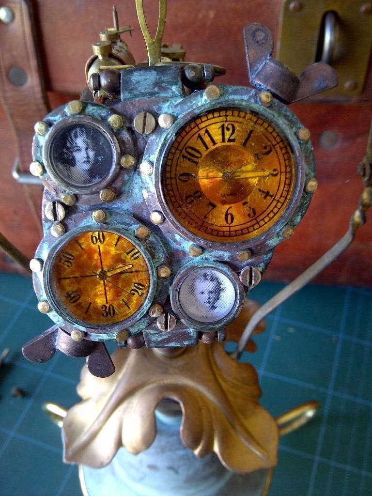

15$ watch off e bay, it was a high polish moon stone type finish, used brass paint and applied oxidizing solution, rubbed down with a Q-tip, used old saddle tack leather straps for the wrist cuff, modded the crowns with brass nut and whined up keys from a old alarm clock, used a horse shoe nail as the insert clasp pin. Added the rivet look by using push pin heads, drilled small holes and applied epoxy. First sort of build when it comes to a watch, funny that, since I'm a self professed watchaholic.

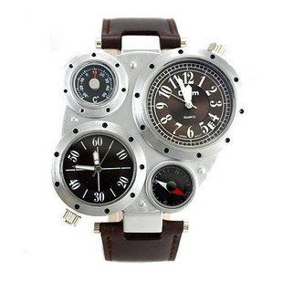

Curious to see what the watch looks like,I can see the 2nd&3rd pics,but not the 1st-it's states that you removed it.

« Reply #4 on: October 02, 2012, 01:52:36 pm »
Thanks,that looks really cool!
Yes,I was wondering the same thing. Did you age it? If so,how did you go about it.

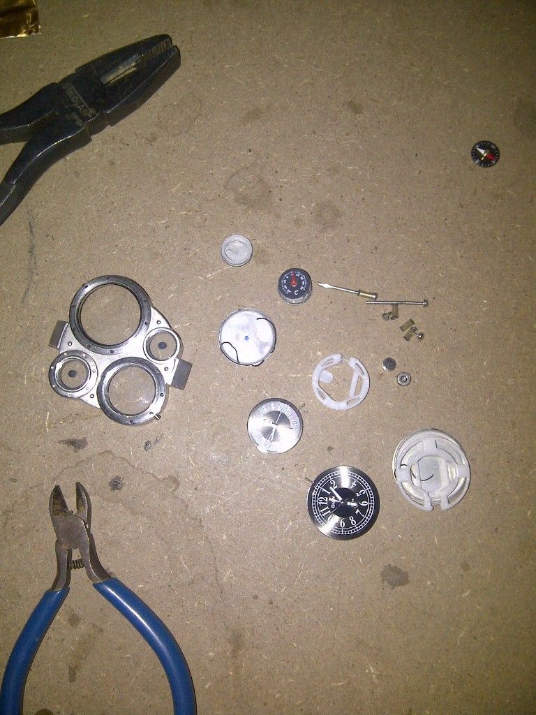

« Reply #5 on: October 02, 2012, 11:09:19 pm »
this is what it started as.

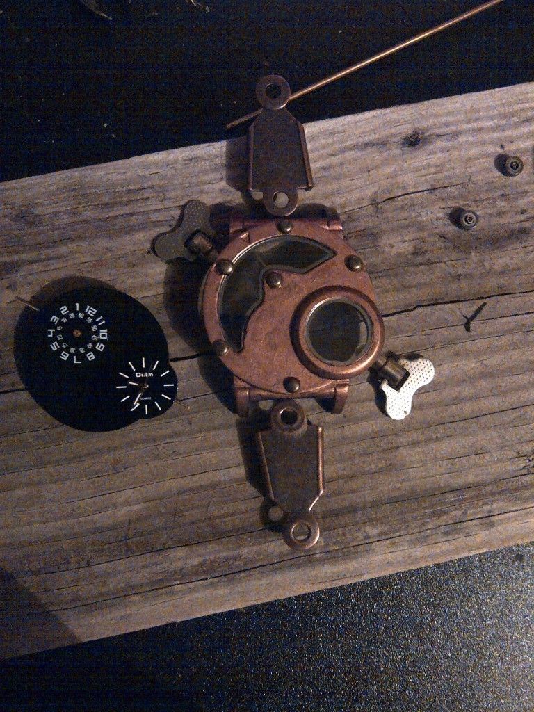

I went to the local art shop and grabbed a copper paint oxidizing kit. I stripped the watch down and gave it a good double coat of paint and let it set.
The Cuff band was simple, had an old belly strap laying around for a saddle, used that along with a bit of strapping from a harness and used some fixtures from a retro 70s chandelier   for the mounting points, clasp, narrow straps to band connections. The rivets are actually mini bronze paper split pins.
The oxidizing worked great and fast. You can keep applying more paint to areas to create some great affects. It was a fun build and I definitely will do another, here is the next one in line.

Did you sand it down or do the electrolysis thingy?

That is quite a transformation.  What would one search to find the original version on ebay?

no surface work at all, I was a bit surprised, even the little areas of the shinny surface popping through the tarnish gives it allot of depth when you look at it. fun thing about it is if it does begin to come off in areas just reapply and continually have a different warn in look. keeps you hands on it too and new ideas may pop up. I like revisiting old projects like that, they keep getting better and better.
How goes it Maets?
I just typed in Large watches and it came up. give that a go.

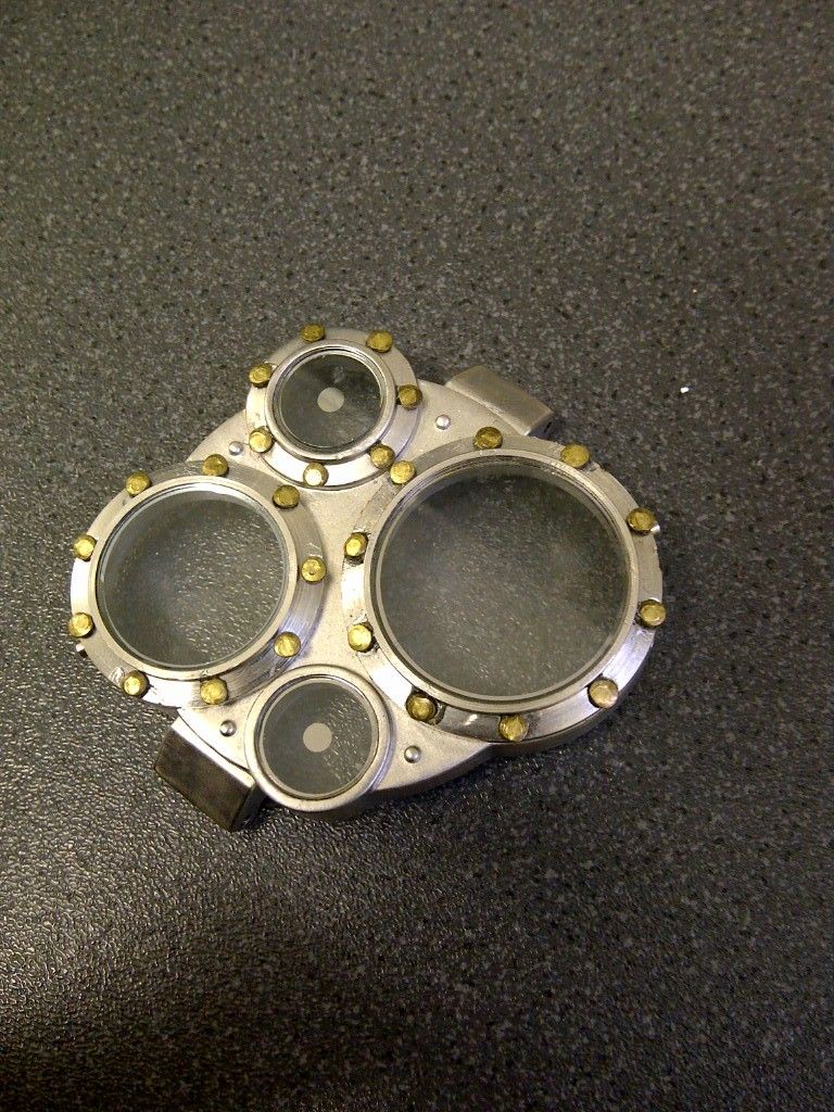

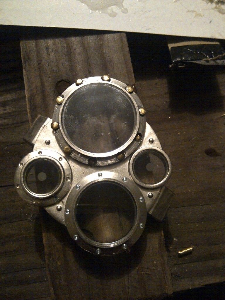

« Reply #13 on: October 19, 2012, 12:03:50 am »

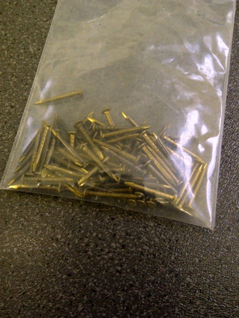

Some progress on the new watch idea.
Stripped the watch down.
Using these to give a rivet effect.
Next will to give it the oxidized brass effect.

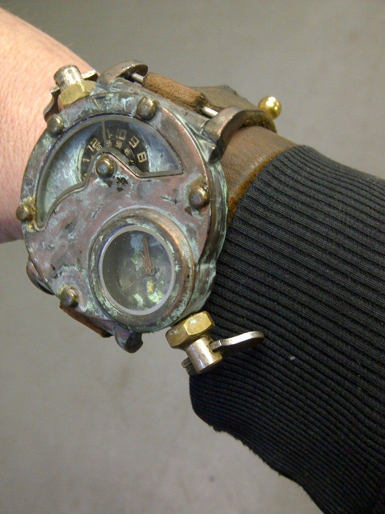

Complete.
« Reply #16 on: October 22, 2012, 12:47:25 am »
Came out very nice.  Looks really old.  Well done.

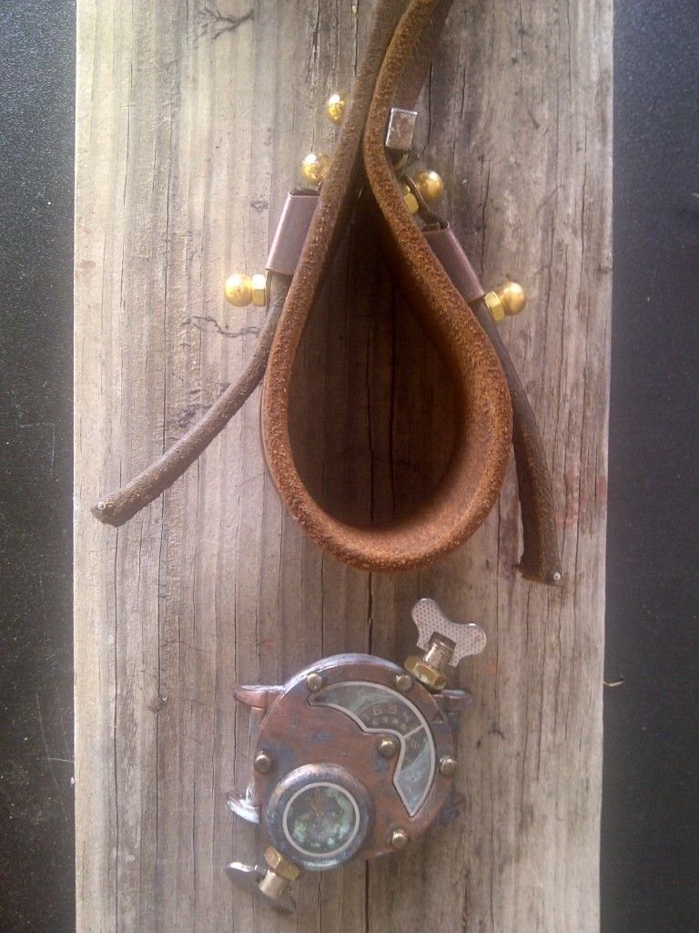

« Reply #24 on: December 27, 2012, 10:38:11 pm »
Thanks everyone for the feed back, I appreciate it. Here is the final piece.
Sorry for the upside down experience, for some reason photobucket is having some issues saving my editing. You get the just, flip your monitor and you will then see the desired position. Thanks again for the feed back, hope everyone had a stellar holiday.
