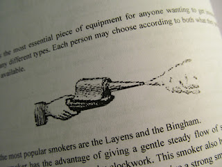

The first smoker is described in Abbe Warre's book Beekeeping for All.  He has a couple of drawings of it in his book.  It's small, bellows driven and would be perfect for the small time bee keeper.  It looks to be a predecessor to the modern smoker, and was popular in the UK about the turn of the last century.
He describes this as using "rolls of corrugated paper or cheap cloth (from wrappings, old sacks)."  Unlike modern smokers, these are held horizontally when smoking and stand upright with it's nozel in the air when not in use.
This link has an interesting diagram of how it's constructed. http://www.dave-cushman.net/bee/smok.html

There is a clockwork smoker - one I would dearly like to make one day - but according to Warre, the noise annoys the bees.
I have some old clock parts from manual alarm clocks... some of the springs are in tact.  Any thought on how to make a clock work fan?  Perhaps one could wind up the clockwork, then have a little leaver to turn the fan on, have it go at a stead and slow speed, then use the little leaver to turn it off when not needed?
