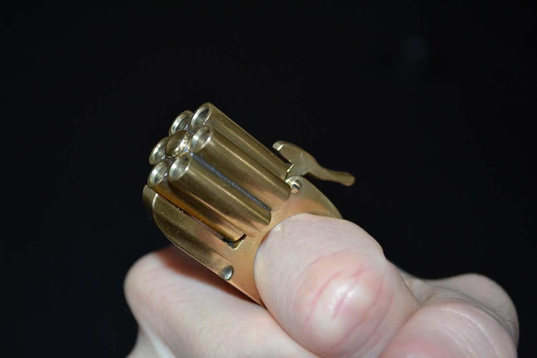

A while ago I made a ring-mounted pepperbox gun for the current Gentleman's Challenge, and had some inquiries about how it was made, so here's a WIP/How-to for the second one. This will be shorter and less chunky than the first as it is for feminine fingers.
Here is the original:
It starts with a cheap brass-coloured ebay ring, which has to be filed down to make it flat on top.
The barrel is made from a brass pipe manifold. They're very good for steampunk projects because (a) they're brass, (b) they're cheap (£2.50 with delivery), (c) they look very gun-like, and (d) they're compatible with standard pipe-work and pipe-fittings.
They're a bit too long to use as they are, so I cut them down by about 5mm. This time I used my new dremel rip-off, the first one was done with a hacksaw.
These manifolds have a hollow back, so need to be mounted onto something with a flat base that can be glued to the ring. I used empty size 12 shotgun ammo; they're a nice fit and can be obtained for free if you know a farmer (I met one on an archaeological dig who offered me a shipping containers-worth since they were littering his land. I only took a small bag).
You will also need primers for the mini-bullets. These can be removed by poking them out from the inside.
After that you just glue it all together. I didn't have time to get any pictures of this since the glue dries so fast, but its fairly obvious how it all fits together.
The ammo tips are M4 dome nuts, and the trigger is a bent bit of sheet brass that I made for the first one but didn't use for some reason. The diamond pattern on it was done with a £3 etching pen.
And here is a mountain of finished pictures:

That is the place I bought the first one from. The second one was from someone else on ebay (who also sells 2-hole versions) and didn't seem as nice (a bit rougher round the drilled holes and not as polished on the outside) but that may have been luck of the draw.
The bullets go in the regular way, but unfortunately poke out of the end of the barrel. If I had a big pillar drill I'd re-drill the holes to make them a bit deeper, but 8mm holes are a bit beyond my £20 rotary tool.
As for idea stealing; go for it. After all, I stole it off other people:
Initial inspiration came from this 19th century original, which was posted on the non-steampunked guns thread (I think):
Unfortunately, the only replica available costs a whopping $580 (Although it is solid silver with moving parts).
This one on Etsy was a big inspiration. Its much better made than mine, and the barrel spins! Again unfortunately, I couldn't afford the not-unreasonable £80 they wanted for it.
Incidentally, when I went to get the above image link, I found that they've made some very affordable resin replicas of their awesome version(unfortunately no spinning):
http://www.etsy.com/listing/98502488/gun-ring-aged-brass-acrylic-static-prop?ref=v1_other_1
