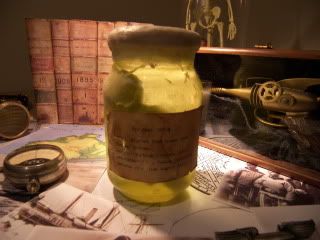

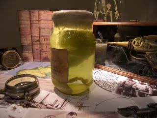

« Reply #16 on: May 03, 2012, 11:17:11 am »
Sculpey is a great medium for the 'Thing'. Give a it a couple of coats of waterproof varnish to the keep the finished product watertight.
I would stay away from anything acidic. Especially coca cola. It'll look great at first but we've all seen what it can do to metal over time. You don't want your precious thing to be eaten away in a couple of months.
I personally use distilled water and food colouring, along with an airtight seal this should do well to preserve your Thing for a long time. I do give the jar an occaisional gentle shake as the colouring does tend to settle after a while
Here's some photo's of one of my things:
« Reply #17 on: May 03, 2012, 12:38:41 pm »
Looks good! The background setting adds a lot.
