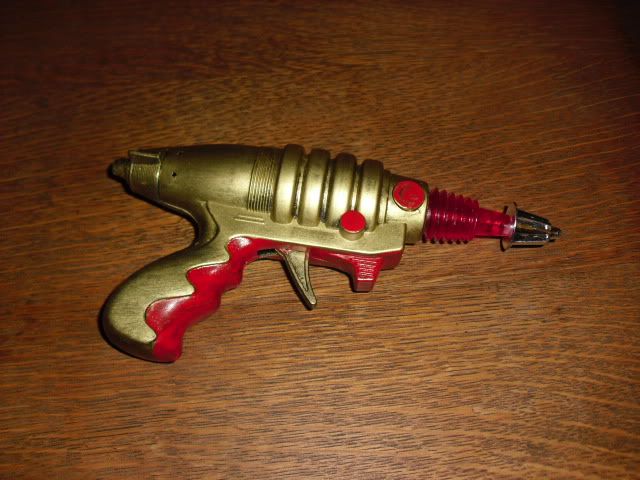

Ok..... I ordered a sparking space gun for my daughter. It arrived not working properly and after contacting the seller was given a refund and told that it was not worth shipping it back to them....
So I got out my matt black spray paint, some sandpaper, some gold and red paint and had a go at a very simple paint job just to see whatmy first try might look like...
Not bad.... ( I'll try to add a picture later.... )
Now I find myself wondering what advice you guys might have to shorten my learning curve and get better results and learn more advanced techniques...

« Reply #2 on: March 19, 2012, 01:30:21 am »
I'll admit up front this was a quick "how easy is this technique anyway?" paint job....
( the gun still 'growls' but it didn't make sparks..... )
For a sidearm for a 7 year old it's not too bad..... I guess.

oh, also on that non sparking sparker gun, you can now rub on some black paste shoe polish and that will darken the overall metallic and bring out some of the details like the ribs in the barrel body. it buffs to a nice sheen too, while still leaving the recesses dark. you can always add more too, if you polish it too much for your taste. just make sure the paint has had plenty of time to dry completely. that can mean up to a couple of weeks for rustoleum!
