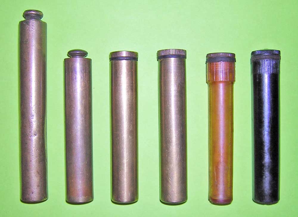

look for wwii 303 oiler bottles.

Pretty much what I need, except these are vintage. I would not dissect something truly old to make something _pretending_ to be old. Also, I need a steady, reliable source. Thanks though, a good illustration.

vintage they may be, but they are also common as muck, they were made in the millions. my local gun shop has boxes of them for a few bucks each

I see, thanks. I've found one single vendor in the US where it is sold for 10 $ each. Is the cap on vintage ones made of brass? Some look like bakelite.

all the ones i've had have been brass. they're useful things for all sorts of projects.

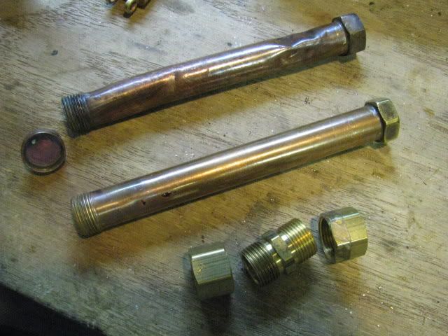

Here are a few tools I made to help with turning parts on the grinder. I cut the threads off the fitting and cap in the picture and brazed them to a piece of pipe. When I want to shape a cap with the grinder I screw it to the tool and it gives me a lot more ability to work it. The female side I use for other pieces I make. The one on the top has seen a little more use. It stopped getting sucked into the grinder once I took all the guards off the sides.
