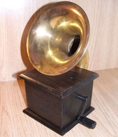

Ladies and gentlemen,
I found the continued transportation and assembly of portable speaker systems a source of frustration, and so I aimed to create a portable sound system capable of housing my Mp3 player, and also connecting to my portable thinking engine in order to play sounds at our RPG the Clockwork Opera.
Here it is:

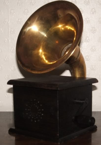

It fits in the palm of your hand.

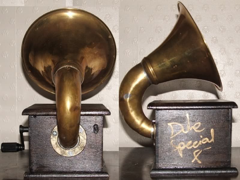

I took it along and had it signed by gramophone-loving musician Duke Special(www.dukespecial.com)

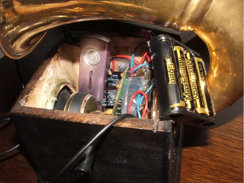

Here is a look at the mechanism:
I purchased a speaker set from the eBay auction rooms.  Finding such a set with a mechanical volume control was essential (they are mostly digital these days).
I dismantled the speakers and placed them inside a tea-caddy which I purchased for fifty pence.
I found a crank in my box of assorted fixings and attached it to the volume control.
The horn is from an old Car horn that I purchased in a charity shop some years ago.
As you can see, there is just enough space inside to fit a tiny MP3 player.  It may even fit an Ipod nano along the surface.
As I have said, it fits in the palm of the hand and is capable of producing quite a sound!

How delightful! I've been waiting for someone to do a mod like this (because it is an absolutely drool-worthy idea) and now my desire to see a portable, mp3-playing gramophone has been sated.
Congratulations on your wonderfully steampunk "speakers".

Daemon, I'm not sure how useful a video would be... it really just sort of sits there.
As to the horn, my apologies.  I was unable to get a picture of the full workings.
In fact it is a two-speaker system with one set into the front as can be seen, and a second set into the rear.  The horn does indeed go all the way through, fixed in place with a metal epoxy.  Pleasantly the sound coming from the horn is amplified to be just louder than the front speaker.  When the lid is closed the combined speakers give a wonderfully warm sound.
By far the icing on the cake is the working crank.
-Herr Dokter, esq
