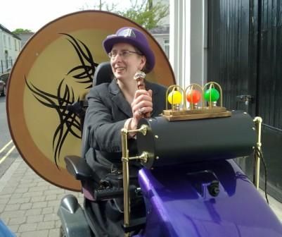

Greetings to you, Gentlefolk of Brass Goggles,
As you will see from the attached photographic representation, we are in the process of converting my scooter into a Time Machine.
The process is not complete and the machine does not yet function fully as a time travelling device. Hopefully the conversion will be completed next year.
Or last year...

« Reply #4 on: May 21, 2012, 12:39:34 pm »
Thanks, Guys.
The next stages will be to address the hood (I never thought I'd describe something as "too purple") and the seat. And possibly motorise the disc (which currently turns by hand power).

« Reply #15 on: May 21, 2012, 08:05:50 pm »
Should anyone wish to know, here are a few details of how Lady Chrystal's wish for temporal enhancement of her Tramper was realised.
The machine of the 1960 film is referenced, but as a rough guide rather than a template for duplication.
The disc is a 1.2m parabolic reflector (from a de-commissioned microwave radio link that once carried mobile phone calls). The outer rim was cut away,
then a hub added (made from wheelchair castor wheels) which would allow rotation of the disc when finished but also helped with the spray painting (the hub is covered by a plastic bag here).
After painting, vinyl decals were added (threefold symetry was chosen partly because the disc already had three small holes but also just to be different) and an edging strip added round the outside (as used on restoring old cars with protruding spot welded seams). Here it is mounted to the vehicle.
Construction of the control unit next, the body is simply a section of 150mm duct and MDF end discs covered in black vinyl. A further internal disc is rotatable and is accessible through a slot, it has a threaded socket into which the control rod can be inserted.
The lamp unit consists of a base cut from two layers of a discarded hardwood bread cutting board, conventional bayonet lamp sockets, and cages bent from 4mm brass tube.
I was a bit unsure of bending the brass tube, but found it was easy to form around discs cut from plywood and screwed down.
The control rod itself is a spindle from a plant pot stand, further turned down, finished and with a glass crystal inside a 2mm brass tubing cage at the end.
In situ, the control unit is supported by brass (effect) wardrobe rail and brackets. In this picture you can also see the power feed (it is parasitic upon the buggy) made from conventional PVC wire inside the braided casing of a shoelace.
And here is the final ensemble.
Close inspection will reveal that all the brass screw heads have their slots aligned. My inner Sheldon cannot be denied...
« Last Edit: May 21, 2012, 08:07:36 pm by Professor Magnim » Logged
