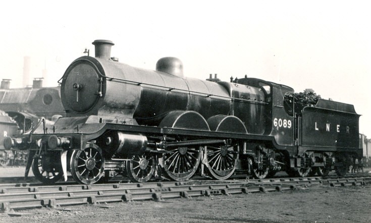

This is what a C4/ Jersey Lily looks like (it occurred to me that I might end up utterly confusing people by referring to class designations....)
My starting point is a Hornby B12 4-6-0; to get the correct wheel arrangement, it is necessary to remove the rearmost axle.  For various reasons, it was not a case of simply doing this, but rather one of switching the middle and rear axles around (the middle axle is the one discarded). Unfortunately, whilst doing this, the insulator on one axle broke and had to be replaced... and the modern replacement was recalcitrant about fitting to a 1970s model... and has since itself broken.  Hence the need to replace the entire axle again.....  It also needs outside valvegear and motion.  I did start off with some Hornby spare parts, which seized up; I've since spoken to Bachmann and bought two sets of their 'proper' Robinson motion (one set for this engine, one set for the B5 I have in mind).
Now then; onto the rest of the chassis.  I did attempt to graft the rear pony truck onto the cut I made in the chassis itself to remove the rear axle, but the two wouldn't come close enough (there was always some or other bit of metal in the way).  So I decided to make the running plate part of the chassis.  Like the previous model, this plate is curved.  Last time this took several weeks and endless frustration to get right; this time I decided to use balsa wood to make up the straight portions (around 90% of the plate) and deal with the curved bits 'later'.  I also made the rear pony truck out of balsa, stuck the axle between the two sides and glued it in position.  A bit rough and ready, but it will work.
