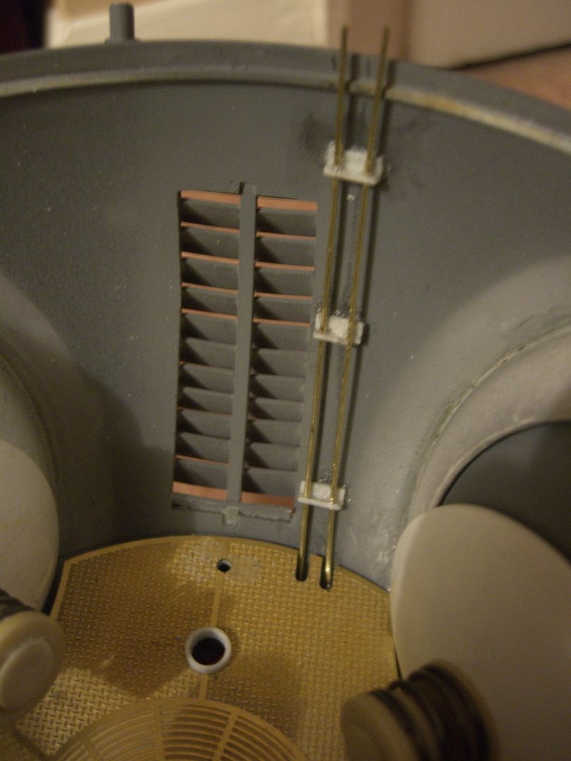

« Reply #321 on: February 05, 2013, 11:33:15 pm »
Having disentangled myself from my tripod, I've done some more:

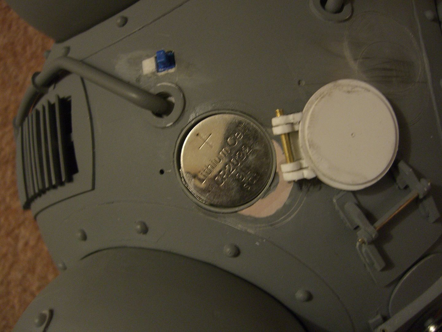

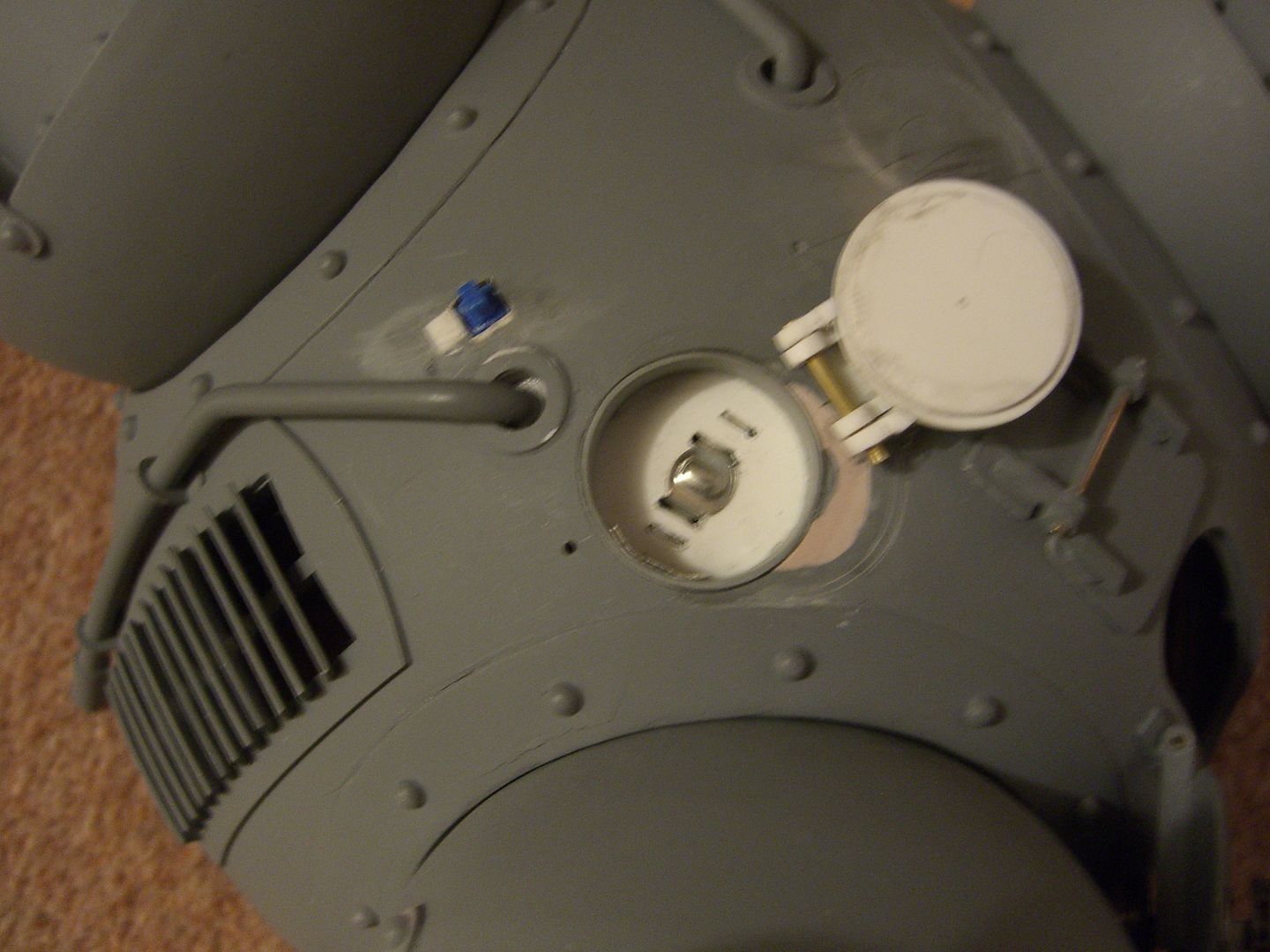

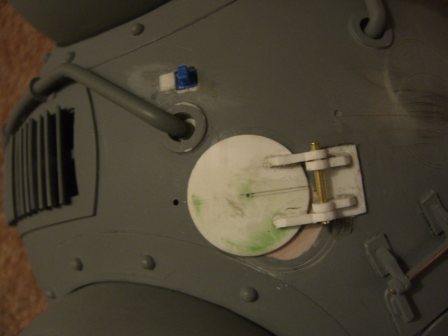

Decided to work on the lighting today, so started with a set of those cheap, flickering LED tealights, stripped out the LEDs, and using the gubbins from one of them, fashioned a two cell battery box from a turned-down length of ABS tube:
Batteries go in thusly:
And the hatch closes over them (I have yet to fit a lock, it'll probably involve a nut and bolt:

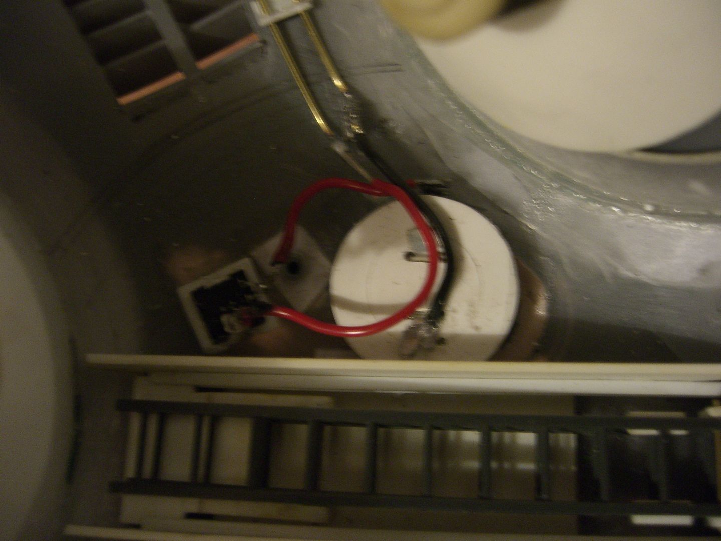

The inside of the base has the battery box and switch, and to get the power to the LEDs, two brass rods that curve to match the interior:
here they are, up to the centre line:

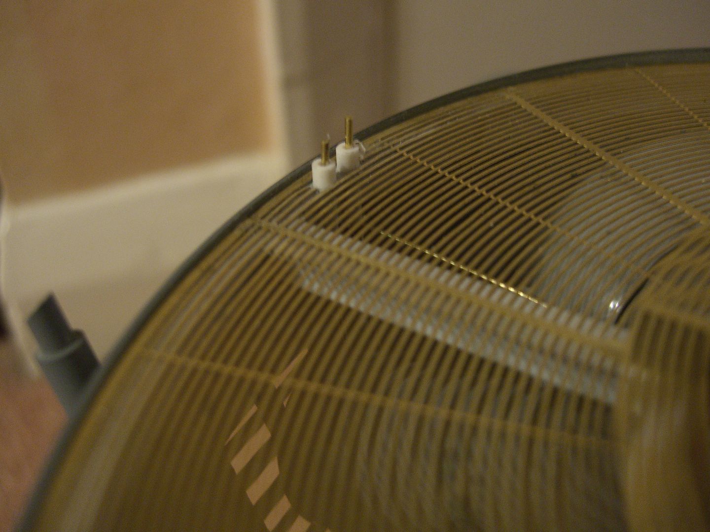

The deck has two pieces of styrene tube added, with brass tube for 'sockets', and brass rod to the LEDs:
LEDs mounted:
And the deck slid into place:
The power gets through to the LEDs perfectly, and the rod sticking up will go to another set of three LEDs in the main cabin, which will be above each pilot position.
The lighting flickers in a slightly eerie way, and this will be compounded when the main cabin has is also lit, as they will flicker at a different rate; here's a video of the lights as they stand tonight:
Three Legs Lighting Test
More soon! Smiley

« Reply #324 on: February 08, 2013, 01:32:42 am »

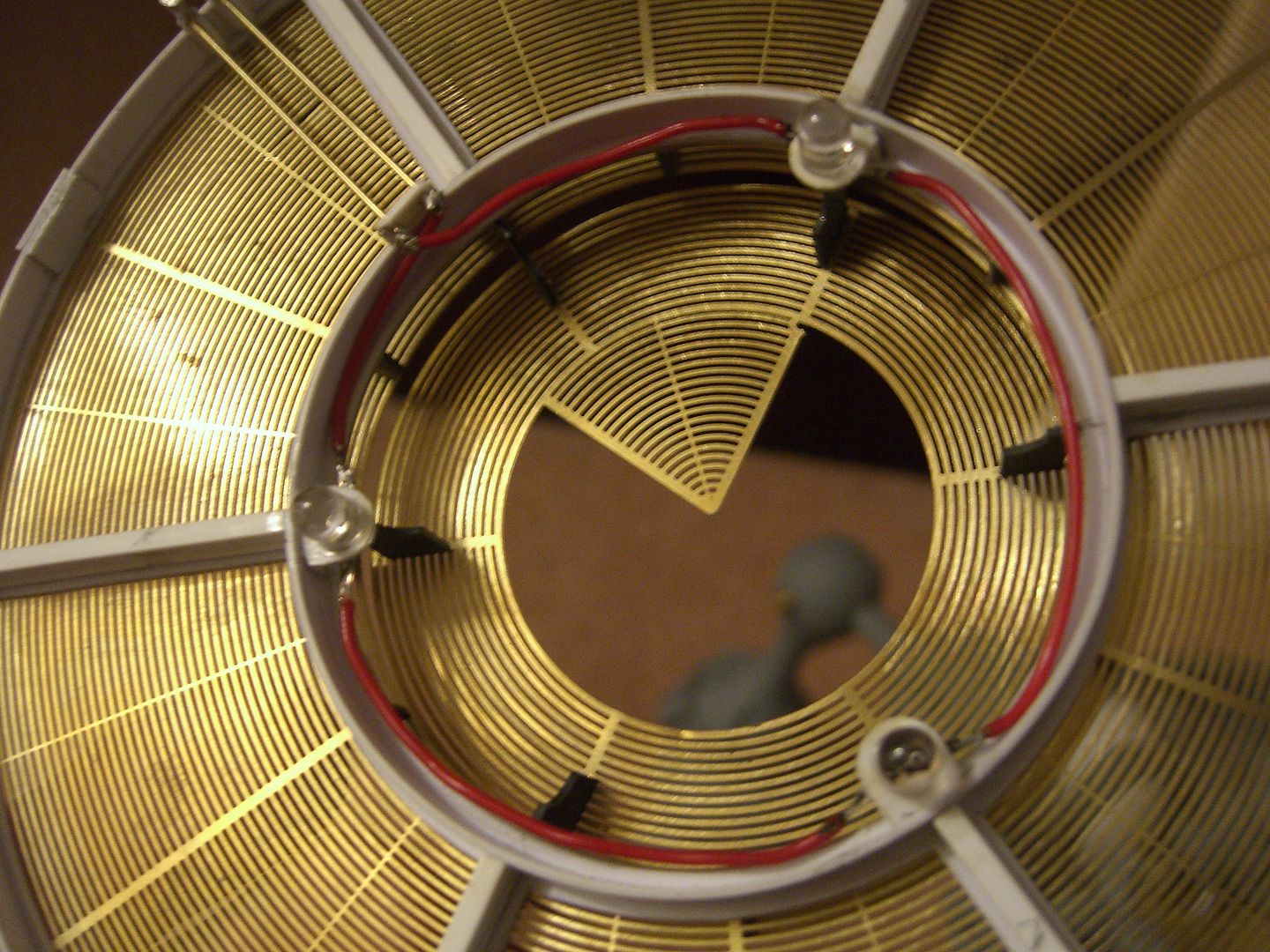

Went for more brass wire, and brass tube sockets:
Only managed to wire one LED in backwards, necessitating some desoldering and resoldering.
Some stills of the lighting in action, through the lower door:
Through one of the pilot hatches:
Looking down through the roof hatch:
And a video of the two layers of LEDs in action:
Three Legged Tank- upper deck light test
Just need to add some styrene brackets to hold the wire in place.
« Last Edit: February 08, 2013, 02:39:50 am by Herr Döktor » Logged
