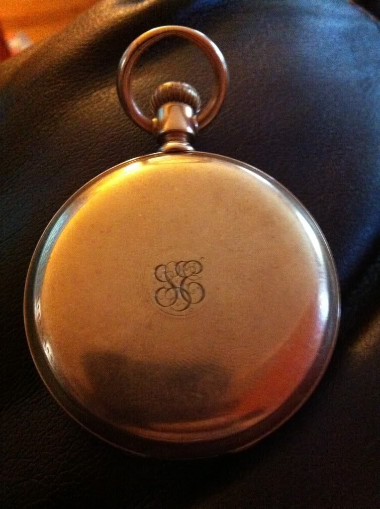

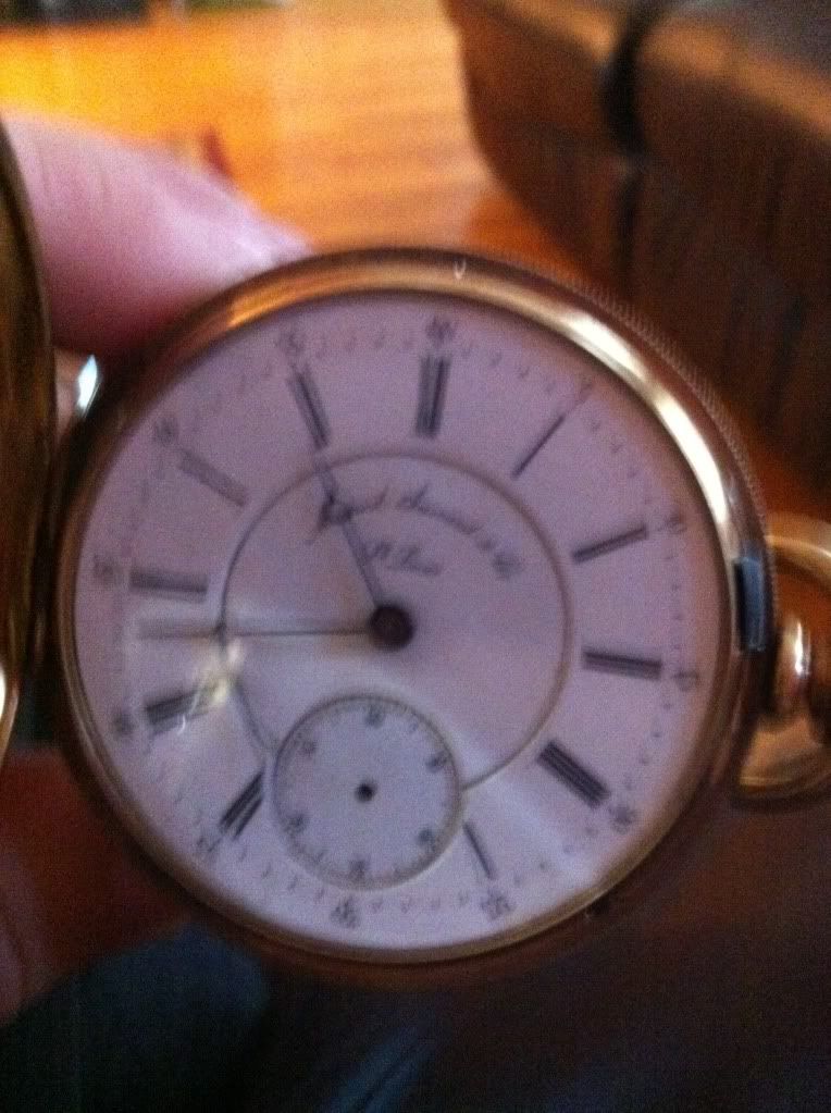

Ok, sorry this took so long, and thank you for sharing your knowledge.  Here's pictures of the watch. Please understand that photography does not even toy with the idea of numbering among my skills, so my apologies for the quality of the pictures.
So, there's a watch and a watch case, with markings on both.  On the inside of cover of the watch case, it says mermod and jaccard jewelry co, and 14k.  Under the 14k mark are the number 45112.

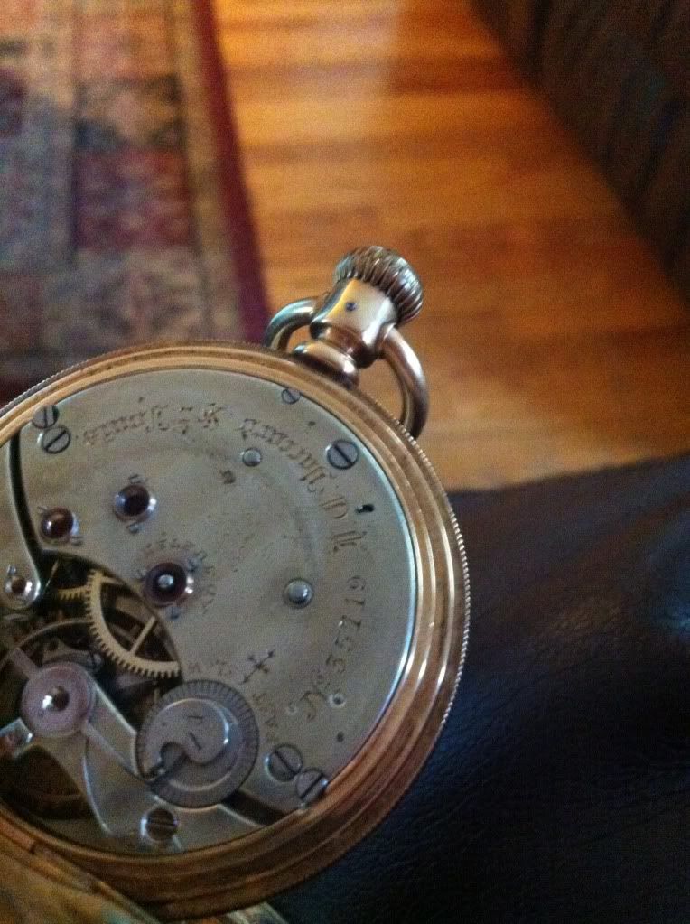

On the inside of the back cover of the watch itself is a funny little symbol that I assume would mean something to me if I knew anything about this sort of thing.  I can't get a photo because of the reflectiveness, but it looks a bit like this: 1$4 - only the line through the dollar sign has lots of swirley things on the ends.  under that is a row of the same numbers - 45112 - and then on the next row a single number 8.  So it looks sort of like this:
                          1$4
                         45112
                            8
Inside the watch itself, the lettering reads " No. 35719 DC Jaccard St. Louis."  It also has the words fast/slow on either side of a little mark that looks a bit like a compass rose, and the word "adjusted" curving around the centerpoint of the watch.  Last but not least, on the second layer of clockworky stuff, there's a stamp in the metal that looks like a small shield - the same shape as the USDA shield.
There was no screw or anything for the back, it just opened like a lever.

Wow, just enough detail to intrigue me without enough to identify it.  Gotta love a mystery!  Cheesy
The general style of the watch points to a swiss import from around the turn of the century.  The snail regulator is interesting; that was used by Gruen and Assman (from germany), although I've seen it on some Longines watches as well.  You mention a "sheild"; is that underneath the balance wheel?  And is there anything inside it (letters or anything)?
It looks like a very good quality watch; well worth restoring, but it probably won't end up being worth much more then the cost of the restoration (if that).
ladyjabberwock
« Reply #4 on: September 28, 2011, 03:41:00 pm »
I want to get it fixed because I think that would be a neat thing for other family members down the line.  That's the value for me, so investment of repair vs. cash value of the watch isn't so much a factor.  What is more of a factor is whether its likely to get messed up during restoration or whatever.  There's no lettering on the shield that I can see, and I've looked at it with a magnifier at this point. It's not really below the balance wheel, more like beside it.  Turn of the century would be about right based on who owned it.

NO!  That holds all the gears in place; remove the plate, and they'll fall out (and beside, you'll never get it back on without damaging something).

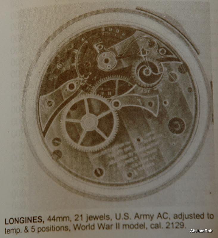

The more I research this, the more I'm inclined to finger "Agassiz" as the maker.  This is company that eventually became Longines, and I know Longines did a lot of jobber watches.  The snail regulator was commonly used by Agassiz (and actually shows up on some later Longines as well).  That said, I've never seen a 3/4 plate Agassiz.  I did find a somewhat similar Longines in my "Complete Price List:
This is a much later watch (with center second) and is reversed, but there are enough similarities to convince me about yours being a longines.  You might want to email Longines directly with the serial number to confirm; they're usually pretty good about responding with finishing records.
Question, does the shield on the pillar plate look like this?

no, thats more elongated. The one in the watch is more squared off at the bottom. I did find the symbol on the case and a thread about it. Apparently it's a j through the s.
