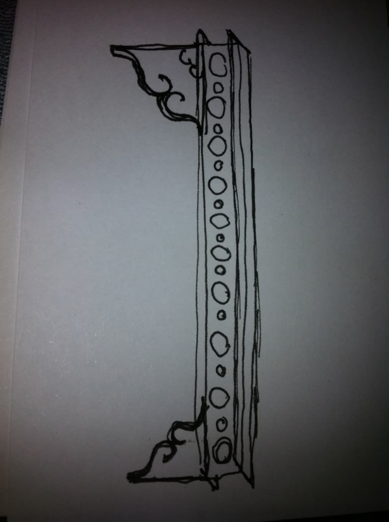

The first thing was to make some designs, spitball ideas and garner a little a help from my friends.
After a thousand similar sketches.
More to show my wife my thoughts rather than anything else (I had this project planned for years so I knew exactly what I was going to do) it was time to start.

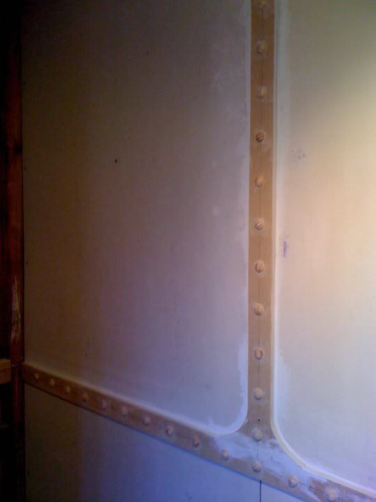

I had revised my plans and went on to create a "bulkhead" style feature wall.

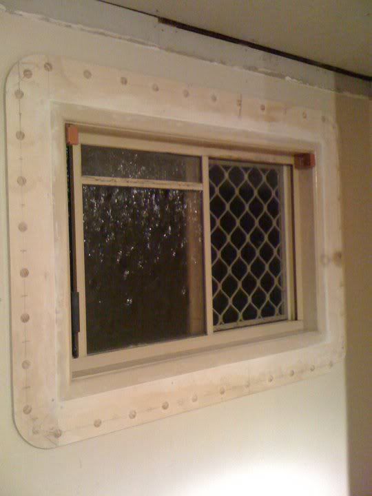

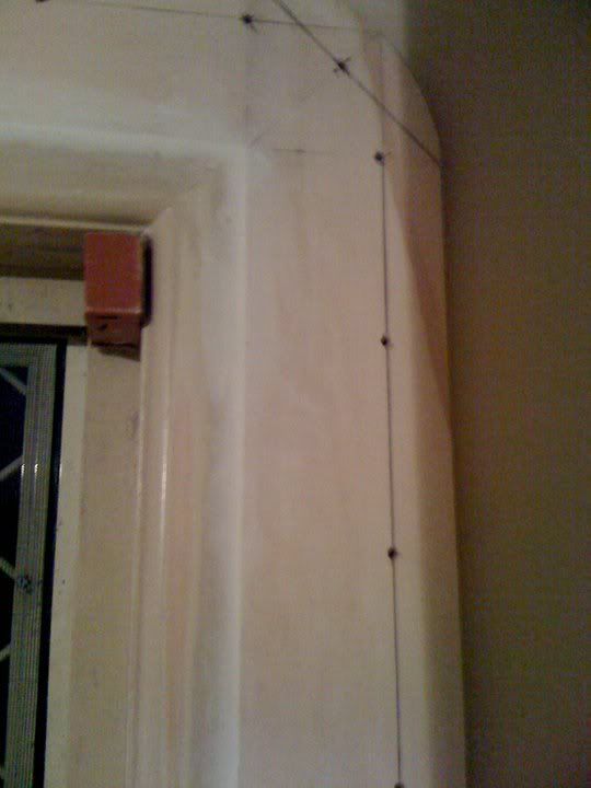

After the termite fiasco I could no longer aford the Iris Viewport window and had decided that it will just get the same treatment as the door and wall.
Back to the wall though, the "bulkhead" surround for the door was created with exterior ply, and continued along the wall as a picture rail which was extended toward the ceiling about 2 feet along... only a picture could make sense of that, so here it is.

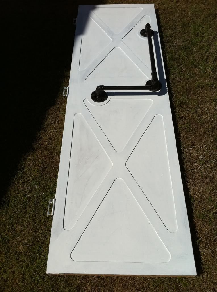

this style was also continued for the cupboard door...

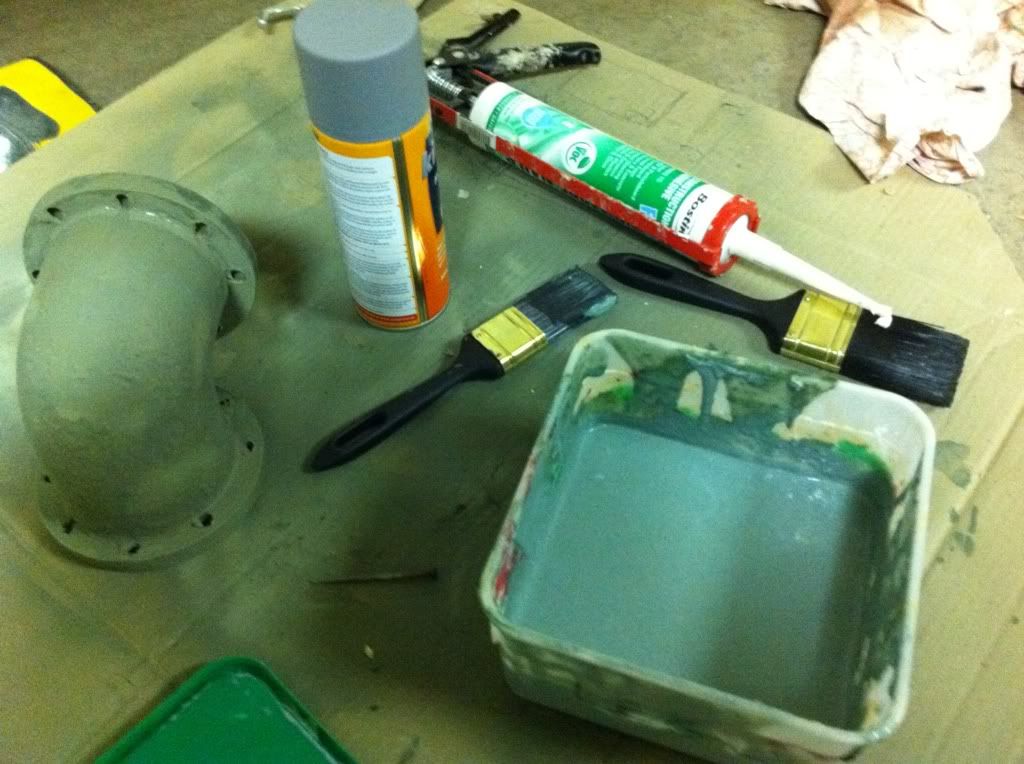

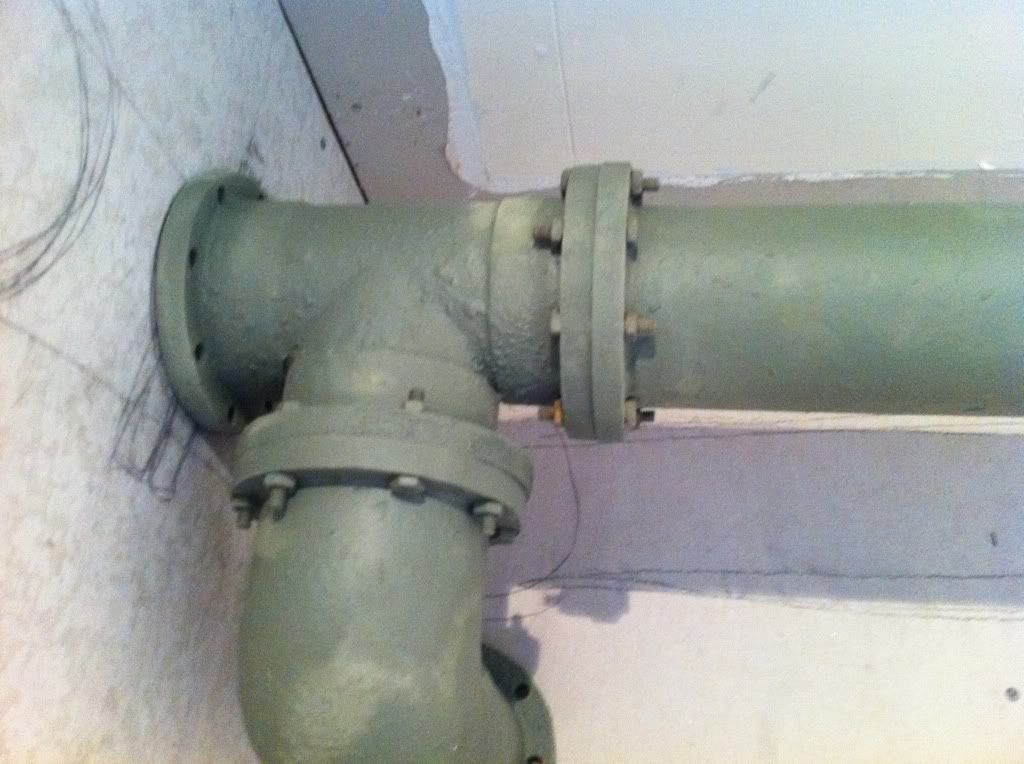

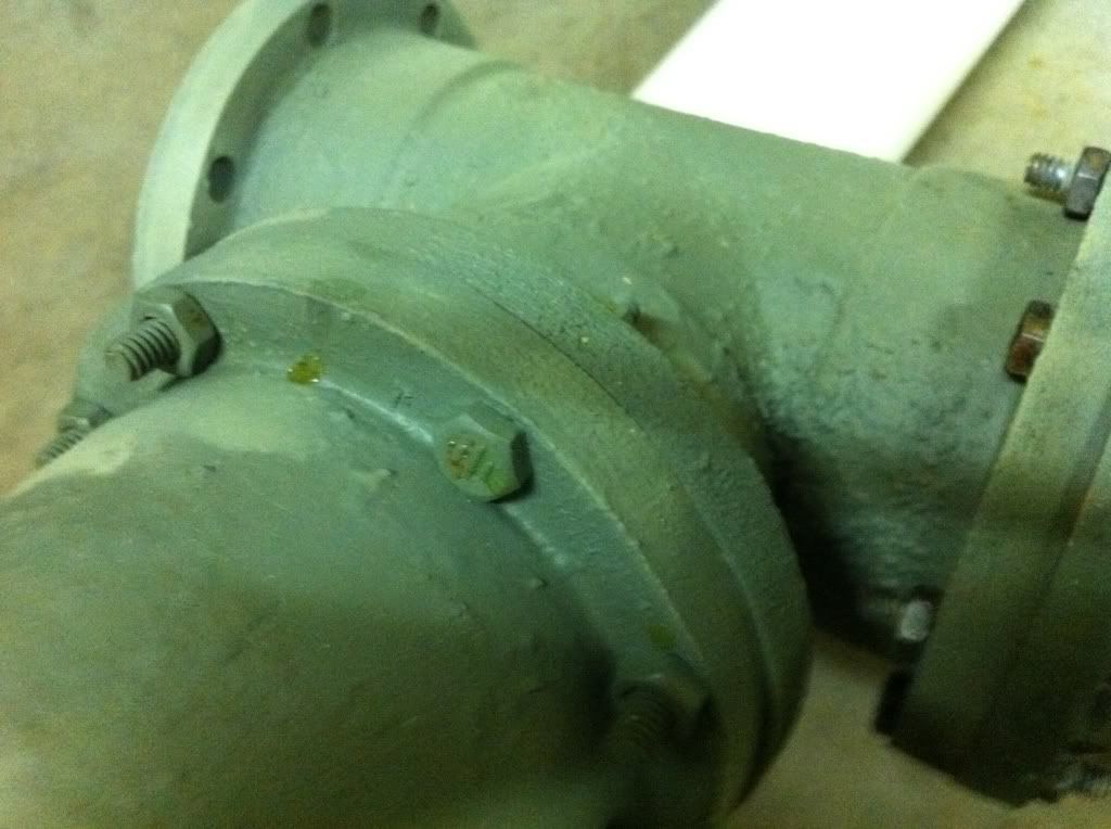

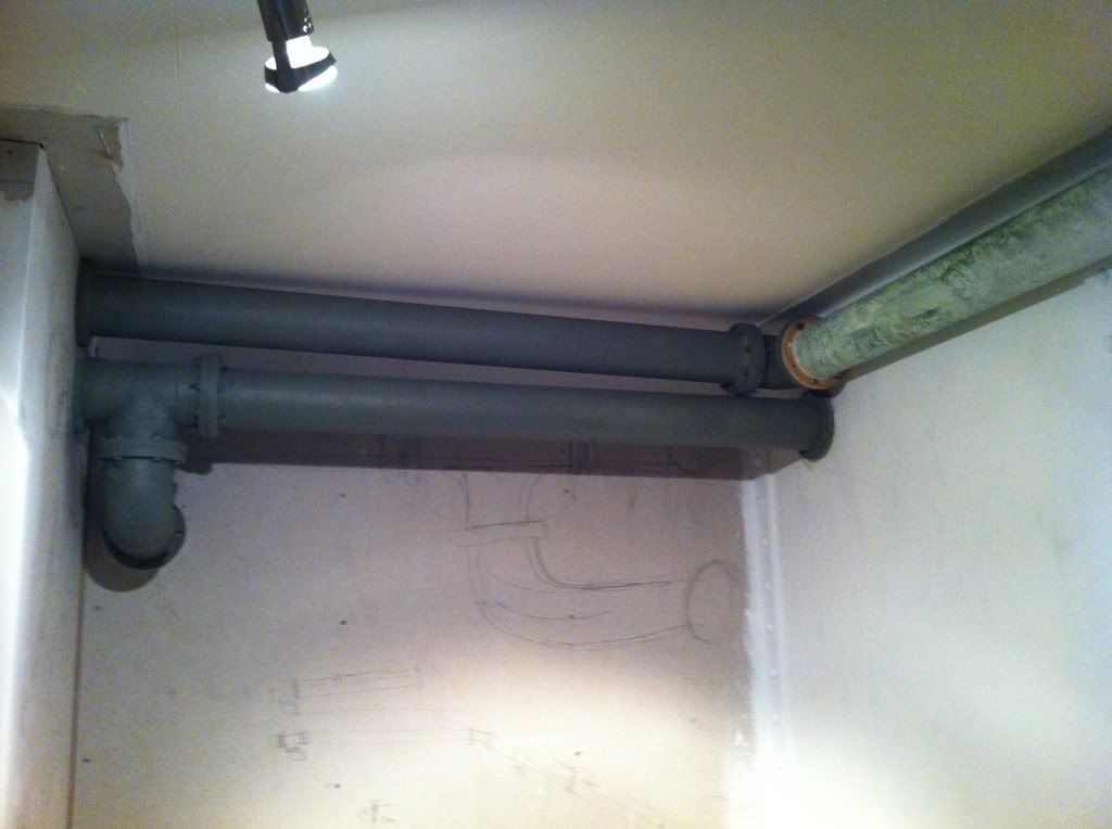

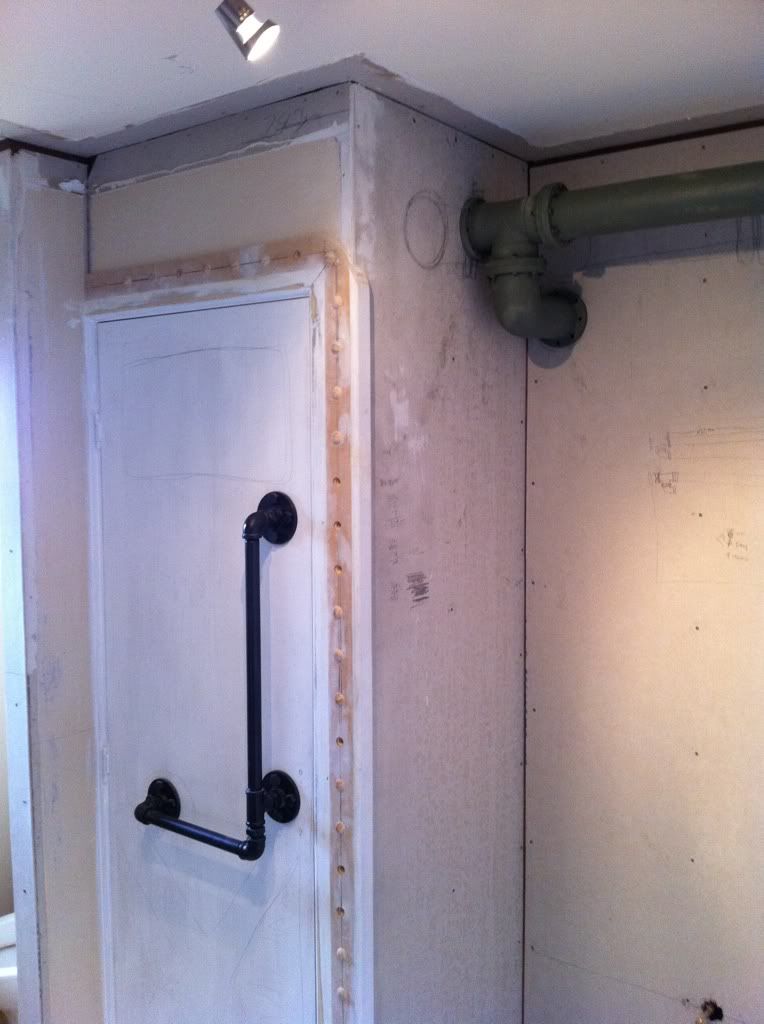

During the planing stages it was decided that steam pipes would adorn the walls, and after the walls were given their submarine style treatment the pipes were the next thing on the agenda.
I had a play around with various types of pipes, ABS, PVC, Iron, cardboard and wood.  For several reasons we decided we'd use PVC, its cheap, plastic, rigid and easy to work with.
A metal restoring friend of mine took several photos of 100 plus year old iron pipes and I went on to style the PVC to get a close aproximiation as I could.

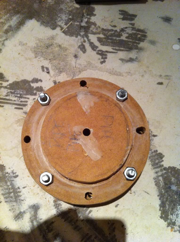

First of all I created the flanges for the ends (now I know this is a humid environment) but MDF was chosen... I didn't go for the waterproof MDF either because I just didn't like the look of it after it was cut.

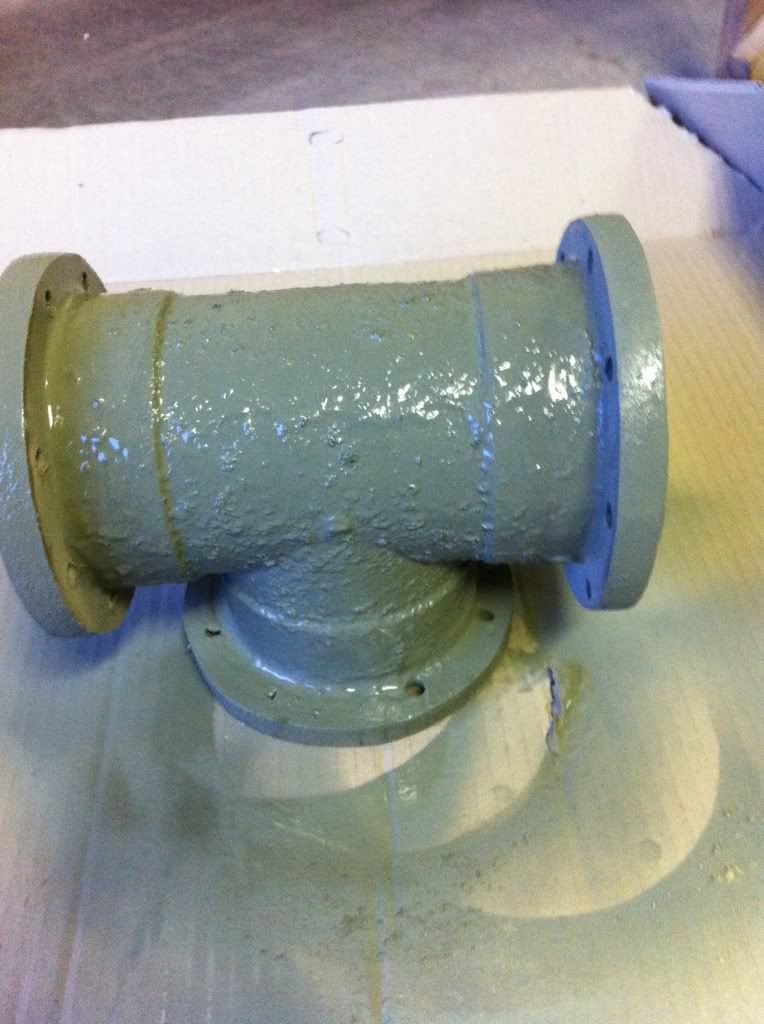

I sanded the PVC rough (rough enough to take a paint and the painted on a goop of my own creation (not too unlike Plaster of Paris except for the ingredience)
The goop was roughly and I mean roughly because i'm not going to spill all my secrets here, 48 parts PVA glue, 48 parts warm water and 4 parts agrigates like sand and sawdust.
this was left to cure for around 24 hours and then a Zinc heavy primer was used to paint it, This paint was runny and filled in all the little gaps and crevices left by the textured goop, it would then also alow me to paint a water based acrilic paint over the top.
Still wet.
Dry.
« Last Edit: June 02, 2011, 12:36:56 am by Joeynana » Logged

This required no more than to be glued to the wall... The product of choice here was no more nails (of course)
This particular pipe runs low from the ceiling, and another pipe will run over the top.  The reason for this is so we can hide a very non submarine/steampunk fluro light behind it.
The top pipe continues along the feature wall and over the door, this also acts in place of proper cornice on these walls.

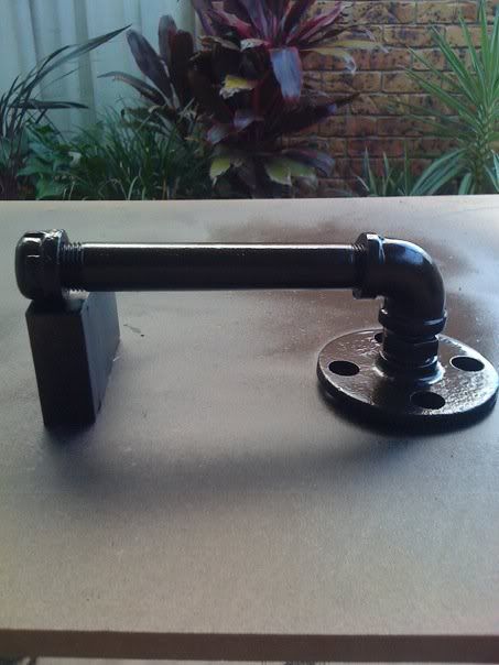

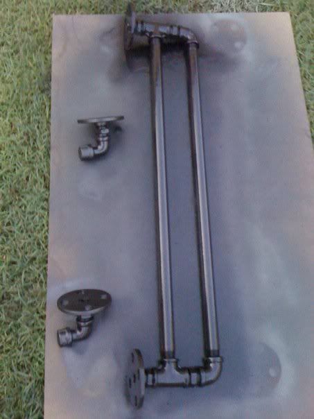

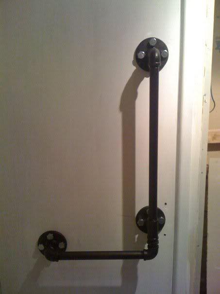

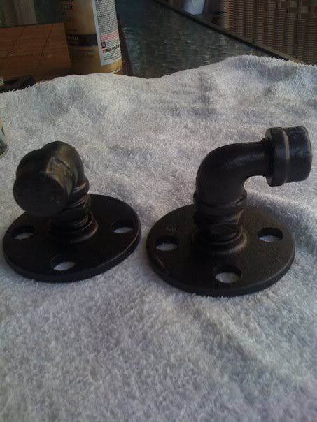

I had a weeks holiday up my sleave and I took it.  During this time came what has so far been the most fun, I made all the wall furniture (toilet paper roll holder, towel rail etc. etc.)
This was easy to do too, it was made using pre cut galvanized theaded pipe, flanges and nipples.
Robe Hooks
Toilet Paper Roll Holder
Towel Rail
Cupboard Door Handle

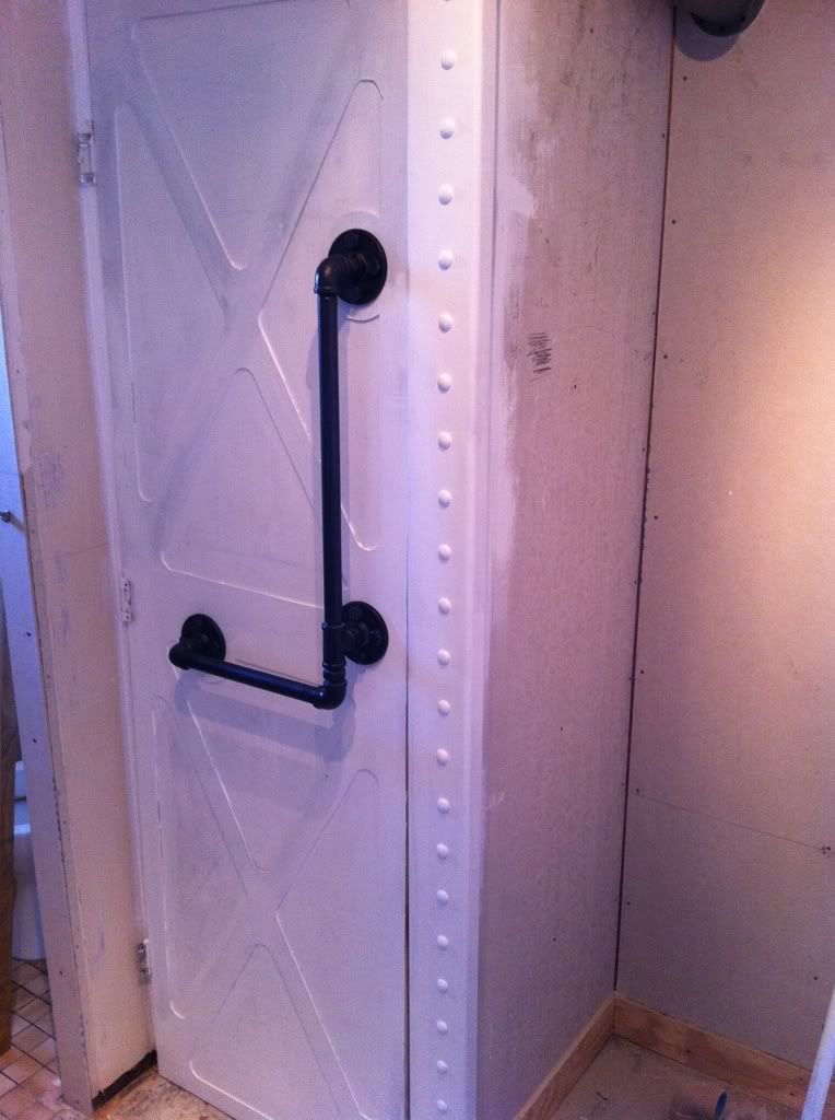

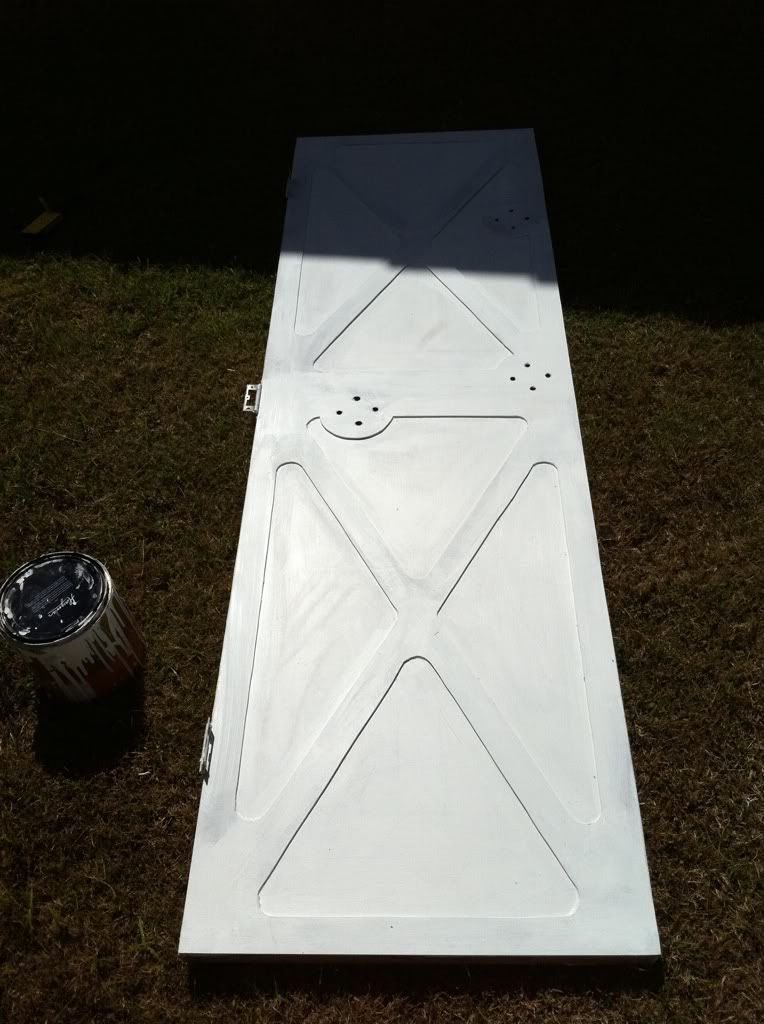

The cupboard door gets it's proper makeover.  I wanted to keep with a Victorian theme here however everything i designd just didn't seem to work, plus it's a "faux" brace, it needs to look functional for the illusion to work.  Once again Trav' (my metal restoring friend) came through with the goods, some photos of 150 year old door bracing from the sugar mills around the town.  Even then the KISS principle was evident, with that I went to work.
As luck would have it, and somewhat on purpose too, the area where the flanges of the handle sit create a great Victorian-esque appearance.  Once again only a picture could make sense of that, so here they are.

The faux brace was glued to the door using a few dabs of no-more-nails and a liberal spray of construction contact adhesive and then painted with an undercoat.
the handle put back on...
... and then put back in place to await it's colour.

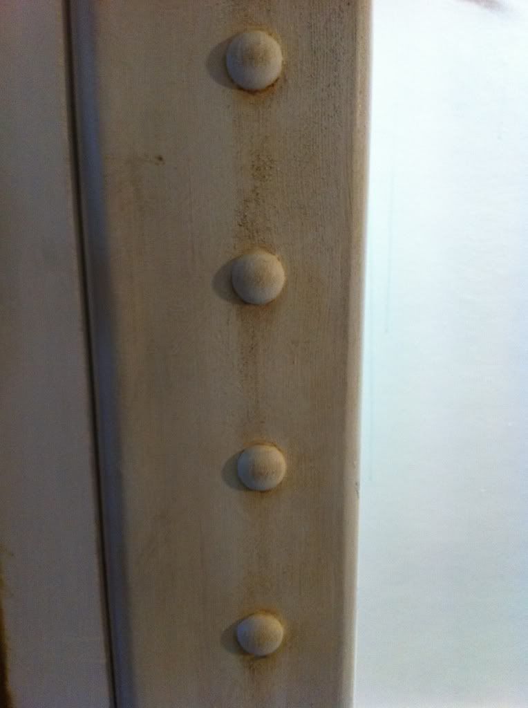

Musist.  An explination on rivets will come later in the post.  In reality while they are up in these photos, they were not at this point of the build. They came soon after and while doing the cupboard door.
A brief explination though is that holes were drilled in the paneling and a pine cover button (little wooden mushroom, incase they have a different name in your country) glued in.

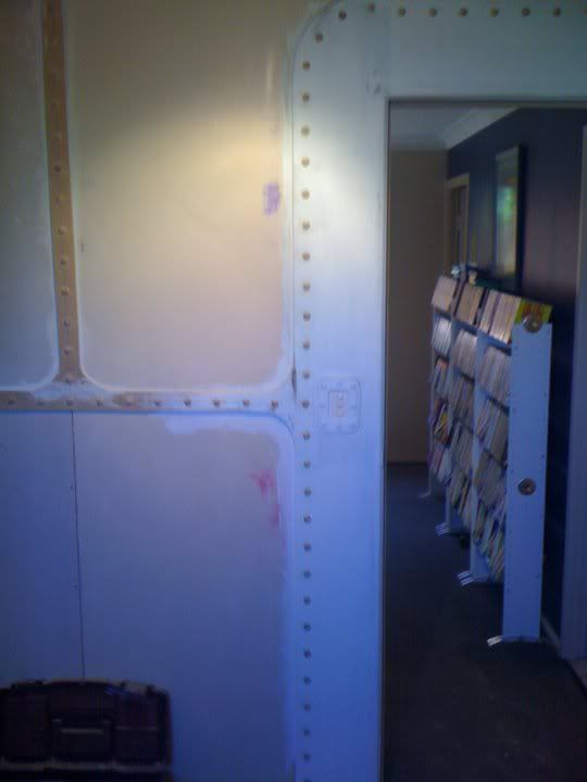

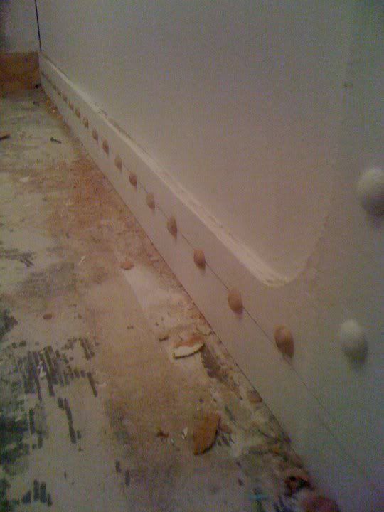

It was now time to put in the pre-cut (by me and my trusty jigsaw) skirtingboards.   It was at this point I started to feel sorry for my wife who I realised would be the primary cleaner of this room.
It was also when most of the "rivets" went in.
I wanted a perfect alignment for the rivets so that each one would be the same distance from the next, the rivets had to meet up with the picture rail and also where the picture rail extends to the ceiling (ALL THE SAME DISTANCE APART) this just about turned my brain to mushy tofu, here I was thinking it would be easy... but alas my dreams dashed for the day and I went to bed unable to sleep, however as my wife recalls it I fell asleep as soon as my head hit the pillow only to awake at 2am from a dream i'm sure had me and a scantily clad Sandra Bullock in.
EUREKA I had figured it out and I went to work then and there measuring and drilling only finishing when the rest of the family got up and had breakfast.
This took a long time... weeks in fact, considering at this point i'm well and trully off my holidays and work takes up a great deal of my time.
As you can see for the window the rivets are not the same distance apart, to do so would have had me working in millimetres and my sanity over this job was already lost to a four year old that thought it would be funny to swing off our flat screen T.V bracket. (it survived, so did my son... just)

With the rivets in place, it was then time for a litlle experiment in making it look well worn.
I used real iron paint for this effect.
