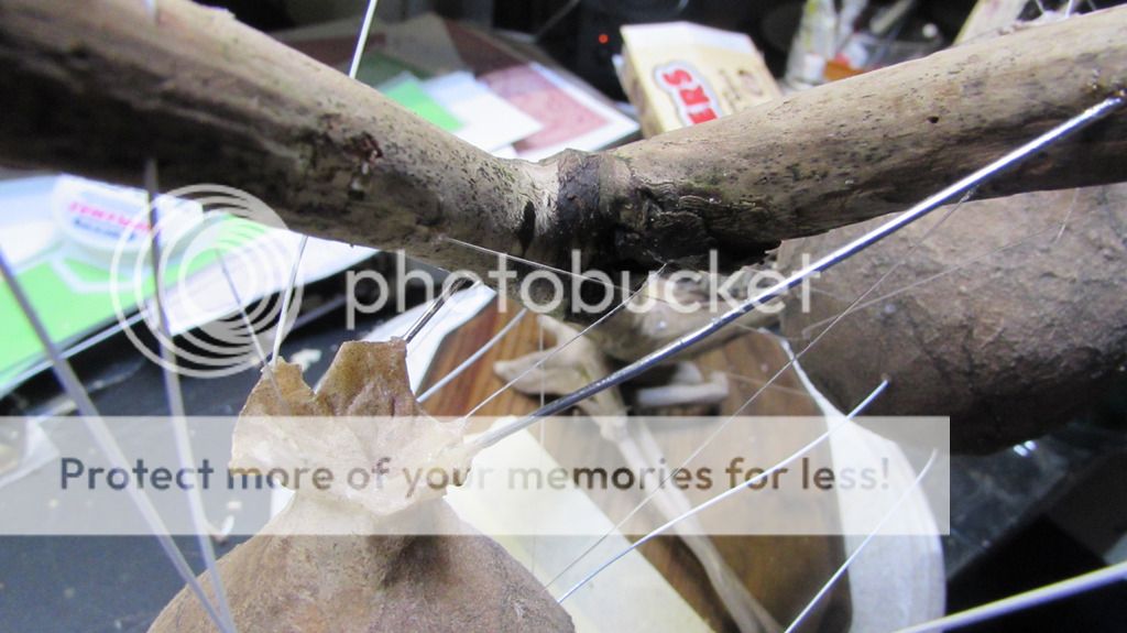

 Took a day off, but now I'm back to it. Here's the wire technique I mentioned. I used carefully straightened paperclips for these two strands. Once they're superglued into position, they hold the egg firmly in place. So now I can glue the other strands in place and carefully pull them taut without worrying about causing slackening in strands going in other directions.
Hopefully this will speed up progress considerably.

« Reply #434 on: May 03, 2016, 09:56:16 am »
Toothpicks! Why didn't I think of this before? Very sturdy, and without the hassle of cutting wheels and pliers that wire requires.
Currently I'm adding the 3rd egg pod.
Yeah, adding some yellow and green washed might help. Right now I've got pearl medium over grey which has given everything an unintended metallic sheen. Spraying clear brown coat over it has only managed to turn the threads to gold. So I'm not sure what to do now.
« Reply #435 on: May 03, 2016, 10:47:11 am »
Ack! First big mistake of the build. One of the paints I used has reacted to the plastic strip I was using and melted them into rubber. So i'm having to go back and replace a lot of the sagging ones. *sigh*
So later today I'll have to go pick up a package of craft wire, and start stripping off the plastic strands. :p

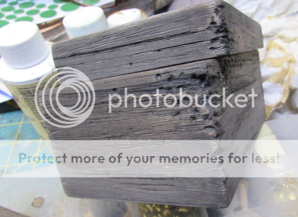

Unfortunately most of the sands are too saggy/rubbery to use, so I'm going to replace them with wire. As a result, I picked up a box of paperclips for $1.25 which I'll simply straighten and glue into place as needed. It'll also give me a chance to explore various options.
While I contemplate the issue, I've decided to do a quick and simple box to store my insulin supplies. Using as always, a cheap and nasty box from Michael's. It's good to have a secondary projects in case things get frustrating.
It's funny how most people try to make a lovely stained and varnished finish, while others want our wood as tattered and decayed as possible.
Day one involved painting the box with a strong tea solution. After lettign it dry, I brushed it with my beloved steel wool and white vinegar mixture.
Day two of the box involved giving the wood a good gouging with a Dremel, a large wood rasp and pounding and scratching it with a small rock. Not quite satisfied, I took it in the garage and scrubbed it well with one of my roomies large wire brushes, which gave me all those lovely long worn scratches in the soft wood. I'm so impressed with it that I'll probably go over it again tomorrow to erase some of those round Dremel holes that I'm not happy with.
After that, I gave it a thorough wash nd wipe down with a mix of brown and black acrylic paint. For now, its been set aside to dry.

« Reply #439 on: May 04, 2016, 05:30:52 pm »
Looking good.
Distressing is so relaxing, is it not?  Wink
« Reply #440 on: May 05, 2016, 06:32:40 am »
Now I can't decide if I should varnish it, or stain it.
Mme. Ratchet
« Reply #441 on: May 05, 2016, 06:55:02 am »
My vote goes to stain!
Colonel Hawthorne
« Reply #442 on: May 05, 2016, 08:08:21 am »
I would also tend more to staining than varnishing, but do you need to do anything?  It looks wonderful as it is - even the woodworm holes can stay, for my money.
« Reply #443 on: May 05, 2016, 10:30:23 am »
Yeah, keeping it the natural color sounds like a plan. Though I may hit the inside with a clearcoat just to help keep everything clean.
I'll try hitting the outside with a clear matte finish just to protect the finish. Or at least what there is of it. Smiley
For now, I've got bits glued into plae that'll require drying overnight. Photos tomorrow.
