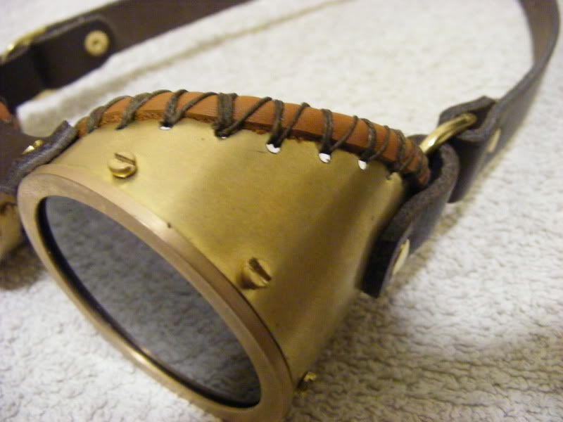

I'm making a pair of DIY steampunk goggles and came upon an issue I didn't really think about:
how can I make the leather backing of goggles that support them around the eyes? (I have no earthly idea what they're called)
Here's a pic of what I'm talking about:
the leather piece behind the frames. I have a rough idea of how to do it, but I'd rather be more sure of what I'm doing before blowing through all my leather reserves with "tests".
Any ideas or links to patterns out there?

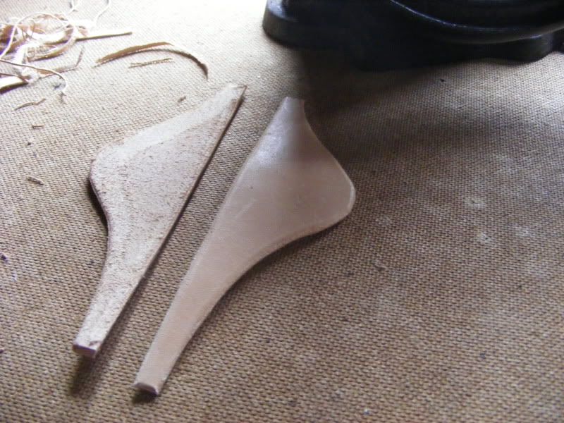

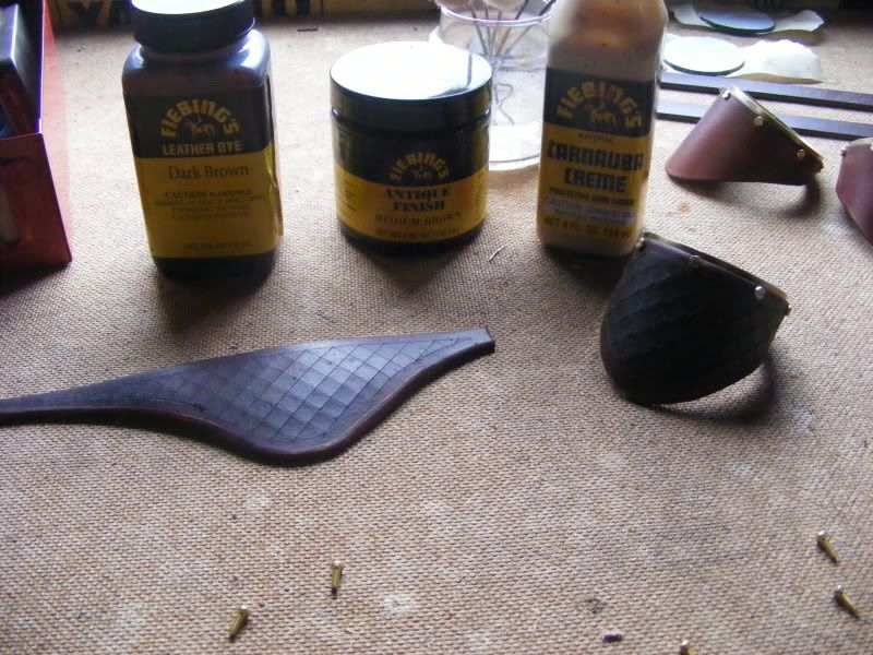

A cut up toilet roll tube made my first ever pattern many moons ago.
Then trace to leather or brass ect.
After some work-
then abit more work-
Same principles apply for brass too
 Wink

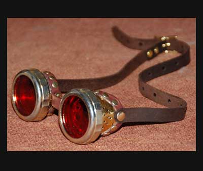

On roughly the same subject, I've seen several pairs of goggles (only pics) that have this "pasta strainer" like piece attached to the side of the cups.
I'm making a pair very similar to these. I found the washer part that houses the lens at a hardware store. Does anyone know what the gold part on the side of the cup is and would it be something I could make at home or buy at home depot?
( I thought of a sink stopper grate, but the only ones I could find were to thick to be bent to the curveture of my eye.)

If you are up to bending brass, the DIY stores sell brass door kickplates that would do for several pairs of goggles.  If you want the ventilated look, trace out the pattern, drill holes where yo want them, and then bend around a pipe of the correct diameter.
