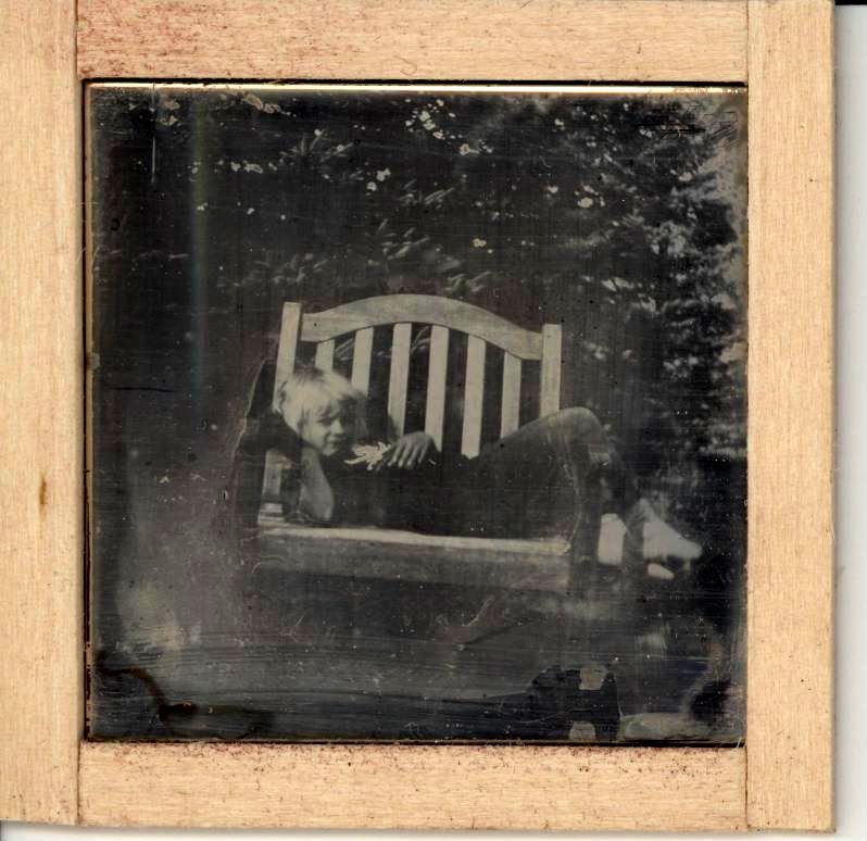

phuphuphnik
« Reply #14 on: April 16, 2010, 02:54:33 am »
Another one. This is a 2x2 Daguerreotype of daughter #1. f 5.6 for 1 min. Bequerel development, iodine to second rose colour.  This was a gift to flea market friends of ours.
