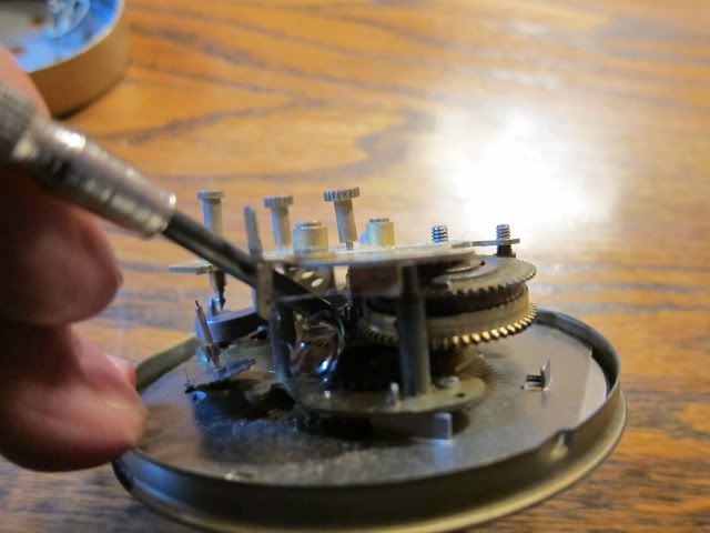

You'll see a number of small nuts on the clockworks. Loosen them all with the pliers and unscrew them by hand
When you have all the nuts off, now comes the dangerous part (not really). Stick your screwdriver between the sides of the case and pry them apart. The mainspring will unwind suddenly. Make sure your fingers are out of the way, it can bite.

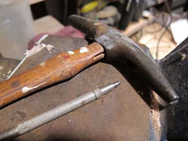

At this point you will change your tools to something like this, a hammer and pointy thing. Your pointy thing can be a small nail. You use this to drive the shafts out of the gears.

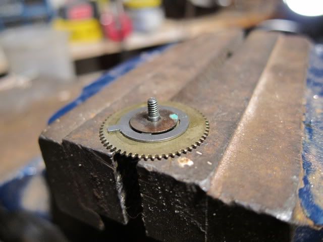

You really need a vice for this, not to hold the gears, but to support them while you whack the shaft with a hammer.
Look at each gear and figure out which way the shaft wants to come out. If you can’t move the shaft with a few taps, look again to make sure you are removing it from the right direction.

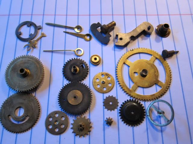

After just a few minutes work, our little clock has yielded this fine collection of gears, hands and works, which will have a new life in other projects.

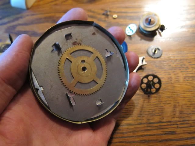

I plead guilty to "slapping on" gears to achieve a retro, mechanized look, but feel the use of brass gears as decorative objects is justified, considering their history as invisible cogs (literally) in the history of industrialization. When I dismantled a broken mantle clock from the early 20th century, I was stunned by the beauty of the gears and marveled that (outside of a clocksmith) I was the only one to have ever seen them. I use these gears as decorative relics of another age (a recent build is shown below) in celebration of their precision, and the beauty of their symmetry.
