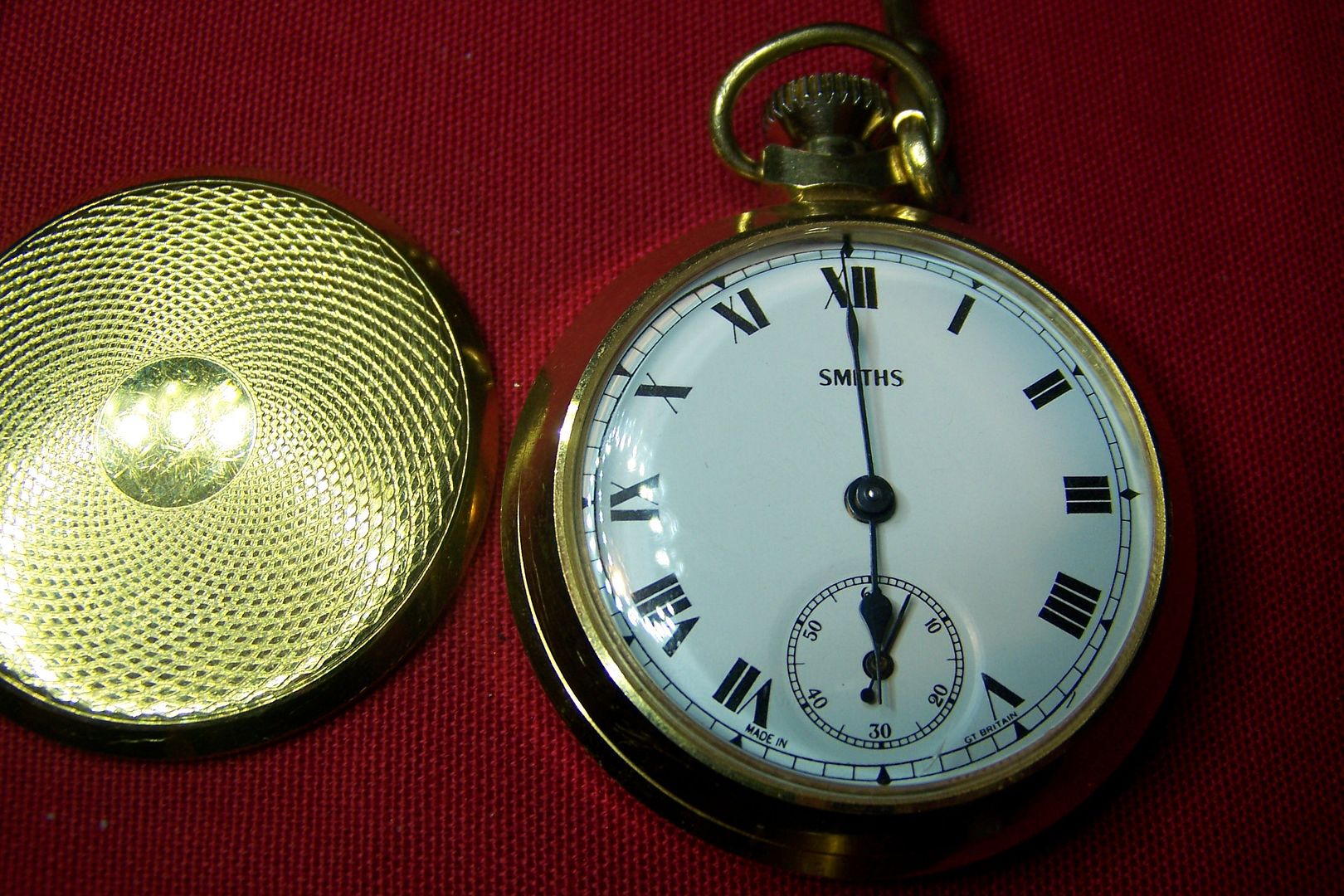

« Reply #1656 on: December 21, 2015, 08:12:23 pm »
Hi folks, I found this thread last night and thought I would post a pic of mine, it's fully wound but not working any help would be much appreciated.
it says "SMITH INDUSTRIES, NO JEWELS, UNADJUSTED"
Richard H
  • Deck Hand
  • Posts: 24
Re: Master Pocketwatch Thread
« Reply #1657 on: December 21, 2015, 10:16:46 pm »
Well the good news is, it's now working, another site seaid spray it with WD40 and hey presto it works!!  ;D
