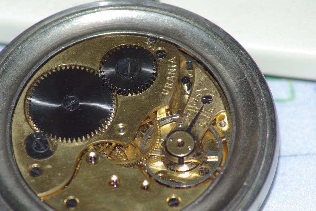

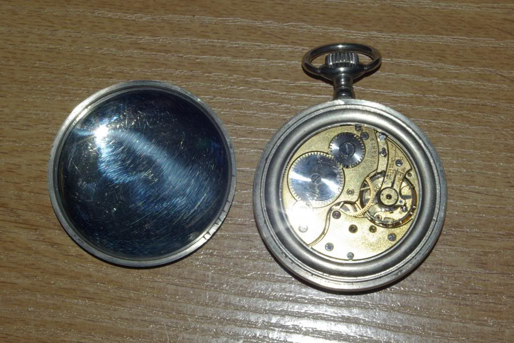

OK, so I need some advice please. I got a cheap pocket watch off Ebay to wear for work. I wanted it cheap in case it got damaged. Now, here's the thing, I don't think it is a cheap watch, but I can't find any definitive information. It is labelled on the inside as Urania. The face is porcelain. I'm not sure what the case is, but I think it may be silver as it gets the usual black coating that silver jewellery does when it needs cleaning. The only things I can find on line suggest it may have been made in Germany before WWI. There are two lots of markings on the inside of the rear cover 16/ 6 57 and 1577 5Oh, and how cheap? £10 Here are some pics. The markings are difficult to photograph.     Any ideas? Is it worth anything ( historically or financially) and is it a shame to wear it for work?

Abslomrob
« Reply #1638 on: January 17, 2013, 06:33:26 pm » |
It's a Cortebert movement (or based on it, at minimum): http://www.ranfft.de/cgi-bin/bidfun-db.cgi?10&ranfft&a&2uswk&Cortebert_488"Urania" is a surprisingly popular trademark term; so much so that I'm surprised at the number of competing references to it. There are tradmark registrations from both german and switzerland. The design of the watch and dial suggest 20's or 30's, and the lack of any other information on the movement means that the watch was never expected to be exported to the U.S. or United Kingdom, and probably wasn't finished in switzerland. German is possible, as is Russian. Regardless of origin, if the case was more then about 80% silver, there'd be a hallmark on it. If there isn't, it's either a lower percentage or one of the many 'silveroid' materials that have existed over the years. As far as quality goes, I don't see anything that strikes me as special for that time frame; The Cortebert calibers were simple but robust movements. In fact, many early Rolex pocket watches were built on Cortebert ebauches (but finished to a much higher standard, of course). And the Russian version (your classic Moljina pocket watches) were produced with little variation from the 40s up to about 2006. So I'd say its an excellent choice for a daily wearer. Depending on where you live, you can probably get it serviced for fairly cheap (although much more then £10 you paid for it) but its worth the cost; once serviced, it should be good to go for at least a decade of trouble-free use.
Ezra Hogbin
« Reply #1639 on: January 18, 2013, 10:38:08 am » |

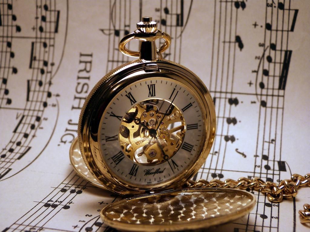

« Reply #1640 on: January 19, 2013, 12:54:39 am » |

Abslomrob
« Reply #1641 on: January 20, 2013, 03:25:15 am » |
In theory, there's a small lever on the balance that you move back and forth to adjust the speed. But you have to be very very careful, becuase you're so close the hairspring, and if you nick that you've really buggered the watch. What do you consider a "little fast"? Is this a Japanese movement? I can't make out the text at the bottom of the dial. Essentially, it's a wristwatch movement that's been place into a pocketwatch case; they've done a nice job of it, although the sweep second hand is a bit anachronistic. But it allows them to use a more common (and thus less expensive) movement (and they pass the savings on to you!). Did it come with the chain?
SpeedyFrenchy
« Reply #1642 on: January 20, 2013, 11:45:10 pm » |
Something less than a minute a day, I've not managed to make a very accurate measurement yet. Is this a Japanese movement? I can't make out the text at the bottom of the dial.
Internet wisdom suggests it's Chinese (they do more expensive models with Swiss movements, but this is advertised when present) , the text says 'mec movt', so mechanical movement. Essentially, it's a wristwatch movement that's been place into a pocketwatch case; they've done a nice job of it, although the sweep second hand is a bit anachronistic.
I'd be interested to know why you think that, it's not a continuous movement, the second hand moves at 4hz. Also, how does one tell the difference between a wristwatch and a pocket watch movement? But it allows them to use a more common (and thus less expensive) movement (and they pass the savings on to you!). Did it come with the chain?
Yes, chain, box, and warranty that's not valid because it wasn't signed by the supplier (Amazon).
Abslomrob
« Reply #1643 on: January 21, 2013, 01:15:27 pm » |
Internet wisdom suggests it's Chinese (they do more expensive models with Swiss movements, but this is advertised when present) , the text says 'mec movt', so mechanical movement. Yeah, that's what I thought. For what they were selling for on the internet, I figured it had to be...you can't buy a swiss movment (uncased) for that money. Which isn't a bad thing necessarily, but you on some level you get what you pay for. Essentially, it's a wristwatch movement that's been place into a pocketwatch case; they've done a nice job of it, although the sweep second hand is a bit anachronistic. I'd be interested to know why you think that, it's not a continuous movement, the second hand moves at 4hz. Also, how does one tell the difference between a wristwatch and a pocket watch movement? Your typical "pocket watch" movement (thinking of the ones made a hundred years ago) always had the seconds hand in a subdial at the 6 o'clock position. It was a practical thing; that arrangment allows you to drive both the second and minute hands directly off the gears without the need for any additional gears. Center sweep seconds requires additional gears, which means more moving parts, and thus more places for loss of precision and energy. There were sweep second watches back then, but they were hideously expensive (and usually chronographs) and finicky. It wasn't until manufacturing methods improved in the early 20th century that it really became practical to mass-produce sweep second watches, and by then everyone was busy trying to make movements "thin", which delayed them further since the normal method of implementing sweep seconds increases the thickness of the movement somewhat. It wasn't until they fundamentally rearranged the design (putting the second wheel off-center) that they were able to make relatively thin center second movements. As far as the difference between "Wrist" and "Pocket" movements, there isn't one. In fact, the original "wristwatches" just used small pocketwatch movements. Size is the main difference these days; your typical pocketwatch uses a 16''' movement (three ' marks indicate "lignes", the typical way to measure swiss movement sizes). Although the trend towards "big" wristwatches these days is changing that. Back in the day, pocketwatches used 19''' or bigger movements, and most wristwatches were 11''' or smaller. Most of that's just habit though. A watch is a watch. When I say that its using a wristwatch movement, mostly what I mean is that its a center-second movement that is substantially smaller then the case. Usually, a good pocketwatch movement is the same size as the dial; this one is only as big as the inside(exposed) part of the dial; the rest of the case is filler or empty. Yes, chain, box, and warranty that's not valid because it wasn't signed by the supplier (Amazon).
Get in touch with Amazon and get that fixed. The warranty is the only thing that makes these watches worth spending that kind of money on (I have a chinese skeleton watch, but I only paid $20 for it. If you paid more then that, you're paying for warranty. If you don't have warranty, you're getting ripped off). The movement in your watch retails for under $5. The problem with Chinese mechanicals is that their quality varies greatly (which isn't surprising considering the low-cost labor force responsible for the machines and assembly). SO while you can get really really good movements, you can also get really really bad ones. My standard advice for these watches is to carefully time the watch over a 24hr period in several positions (for a pocket watch, time it both dial up and crown up). If the time is out by more then a minute a day in either position, return it for a refund and buy a new one. The watch will likely never run as well as it runs when you first buy it, so if it isn't running well then, get a new one. It might take a couple of tries, but you should be able to get one that does better then +/- 30 seconds a day very easily. When I bought mine, I actually bought two, and then disassembled both of them. I combined the "best" parts of both into a single watch that is good for an average of +/- 5 sec/day (or will be once I machine a new rotor for it; the factory one is just too light to keep it at full wind, which throws the timing off).
« Reply #1644 on: February 01, 2013, 12:57:07 pm » |
Instead of going thru all the crap of sending it back,how about opening it up and adjusting it. Works wonders and it's not that difficult. ?

Abslomrob
« Reply #1645 on: February 02, 2013, 04:26:15 pm » |
If a new watch doesn't run at the correct rate with the regulator centered on the balance cock, that tells you that there is something else wrong with the watch. Yes, you can just adjust the regulator to compensate, but that doesn't fix the problem. And problems like that don't go away over time, they usually get worse unless they're fixed. And fact is, you shouldn't have to "Fix" a brand new watch. So while its a bit of a pain to go through the hoops to get another new one, the payoff is five to ten years down the road when the watch still works correctly instead of sitting in your desk or in the garbage because it stopped working, and you didn't want to spend the $200 to get it fixed.
