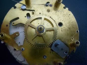

Think this might be the right spot, smack me if I'm wrong.
Pulled my poor little broken Westclox apart (never knew how much grease and grime could be in such a little thing) and am trying to get all the pieces so I can look at them individually. Anyhows, I've gotten pretty much everything off, except for the actual face from the metal plate and the dial hands.I've tried just pulling and that doesn't work Angry Everything else just had to be unscrewed or pulled or jiggled off. Could anyone help me? We've got quite a toolshed but I wouldn' know which to use. I don't want to break any of the pieces.
Here's what's left:

« Reply #1338 on: March 26, 2009, 01:49:26 am »
The hands can be removed with tweezer, they should be a simple friction fit on the cannon pinion. As for the centre wheel, and cannon pinion itself, I'm not sure, I think that they were a very tight press fit, but I'm not sure, nor can I find a diagram.
Your dial may have been fixed with tabs, if so carefull bend them out. Hands shoudl be removed first.  You could try the same technioque as is suggested for Westclox alarm clocks..
1. Remove the hands (they just pry off). Careful not to scar the dial.
2. Remove the dial pan. Two tin tabs pokes thru the front plate and bent over. Pry the ends up with a small screwdriver.
3. Buy a bottle of SIMPLE GREEN houshold cleaner, and a quart of denatured alcohol (shellac thinner) at the paint store.
4. Squirt the movement all over, and in between the plates, with Simple Green. Let it sit for 5 minutes.
5. Wash it thoroughly with hot water from the tap.
6. Repeat steps 4 and 5.
7. Pour the alcohol into a pan or bowl and swish the movement around in it. Alcohol drives off the water. Do this a couple of times. Make sure that the mainspring and alarm spring have been thoroughly "de-watered" as they are susceptible to rust.
8. Dry it thoroughly with a hair dryer.
These are very simple "dollar watches' they were designed to run in almost any condition. About the only part that was properly lubed (greased) was the mainspring..
Sorry I can;t be more help, but I've not had the pleasure of working on a Westclox like that..
Cheers
Harold

« Reply #1339 on: March 26, 2009, 02:37:13 am »
I managed to find the tabs already - they were a booger to get out.
Thanks for the handy dandy info, I end up trying to just pry the hands off and ended up snapping the axel that seemed to be holding everything on. Ah, well, it works jut as fine - fine skill and accidental brutality.

Terribly sorry for the double-postages ness, but I've had success cleaning the pieces as suggested.
But please be careful when blowdrying - although it seems like a good idea to lay all the pieces out and aim the dryer at them, there's a good chance that they'll get blow away into the toilet  Lips sealed Either dry them one by one in hand or be prepared to disinfect them x)
I really like that the case could be re-clsoed so I put most of the parts back in just loose. Yays.
