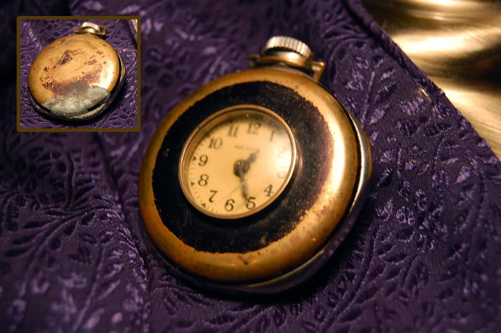

Yesterday I picked up a little New Haven pocket watch for ten dollars in an antique shop.  I'm terribly interested to get inside it and maybe play, but how on earth do you get such a thing apart gently?  It's got a little wear and tear and, having not done this before but with a great interest in modifying it, I'd like to crack it open in the least damaging way.  Does anyone have any advice?  Here is an image of it:

I'll move it in shortly.. That looks a lot like one of the older New Haven "travel watches" They cased a smaller movement in a larger case, meant to be stood on a stand next on a night table.. That case with the slots in the side, LOOKS like one of the cases used on the alarm styles, where the case acted as a sounding board.
  I've never seen that model before, so as of now, I have no advice on opeing it (need to hit the books, and see exactly wht you have..)
As far as "palaying", my attitude to such things is that an old watch eitehr gets restorted to glory, or is broken up into parts to fx other old watches, no making jewelery, etc, unless the parts are so badly out of tolerance that they would be of no use for restorations.. But then, as an amateur horologist and collector, I'm biased  Grin
Let me see what I can find out...

Ok.. from what I can tell, you have a New Haven "pentagon" dollar watch from the mid 1930's. Movement is probably like this..
A dollar watch was a pocket watch or later, a wristwatch, that sold for about one dollar. These were intended to be watches affordable by the common working class.
The sale of such watches began in 1892 by the watchmakers Ingersoll, Waterbury, and New Haven. Later, Western Clock (Westclox) in 1899 and the E. Ingraham Company also began manufacturing them. Dollar watches were practical, mass-produced timepieces intended to be as inexpensive as possible. Trademarks of dollar watches were their simple, rugged design, movement (usually with a pin-pallet escapement, although sometimes with duplex escapements) which has either no jewels or just one jewel, width of about eighteen size (two inches), and sale price of about a dollar from 1892 until the mid 1950s. Many other companies made them, with literally hundreds of names on the dials.
To keep costs down, the watches were often sold in flimsy cardboard boxes, which are now highly collectible.
While these were not high-grade watches, they were important from a horological standpoint, in that they made watches affordable and popular.

I think I'm going to clean all that oxidization off of it and buff it up before trying to pull it apart at all.  It would be nice to get it working again, it only ticks for about thirty seconds at a time so I'm not sure if we'll get it functioning again at all, depends what's wrong with it.  We'll see!
Any advice on a good compound for cleaning that much oxidation off of brass?

Sounds like it needs a simple clean and oil, if it runs for 30 seconds..
As far as the brass, There are several options, a light touch with a dremel and a cratex wheel is fast, but you can easily take off too much.. Any of the automotive metal polishes will work, but be much slower..
Cheers

Use the finest cratex (rubber abrasive) you have, and keep your RPMS on the low side.. If you go the dremel route, you will need to follow up with a fair bit of polishing (I use felt bobs and cloth wheels with green rouge, follwoed up with hand polishing as needed)
