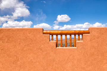

Meanwhile, as previously mentioned, I intend to use this method for 3 items:
1) an adobe-look wall across the front of the property,rather  like this:

3) If the fake adobe walls work and hold up well, I will then use the stuff as an exterior skin on another outbuilding I want to put up
 ( county permit will read "garage" - but it will be shop/artspace/ guest sleeping ). The intent is strong fire and weather proof DIY exterior
 easier than stucco.
