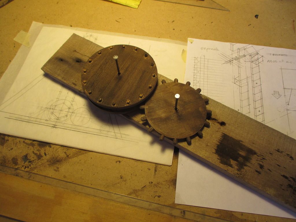

polyphemus

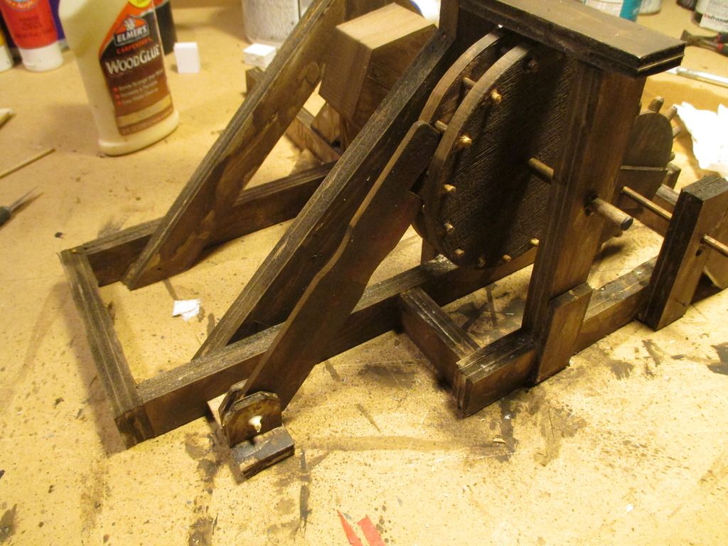

« Reply #8 on: March 25, 2016, 11:34:09 pm »
After some teething problems the first 3d printed wheels are being produced. (Hush, I know I could have cut them by hand faster!)

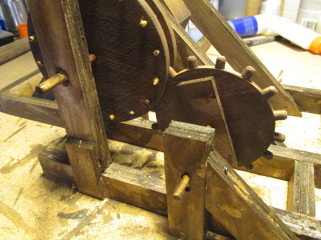

« Reply #10 on: March 27, 2016, 12:26:31 am »
Successful bench test of gears
successful test of bucket chain

« Reply #12 on: March 29, 2016, 01:06:34 am »
The frame work begins to rise. Very preliminary tests have shown that directing the water at the top of the chain may be the hardest part. It may require a special bucket design which I was hoping to avoid.

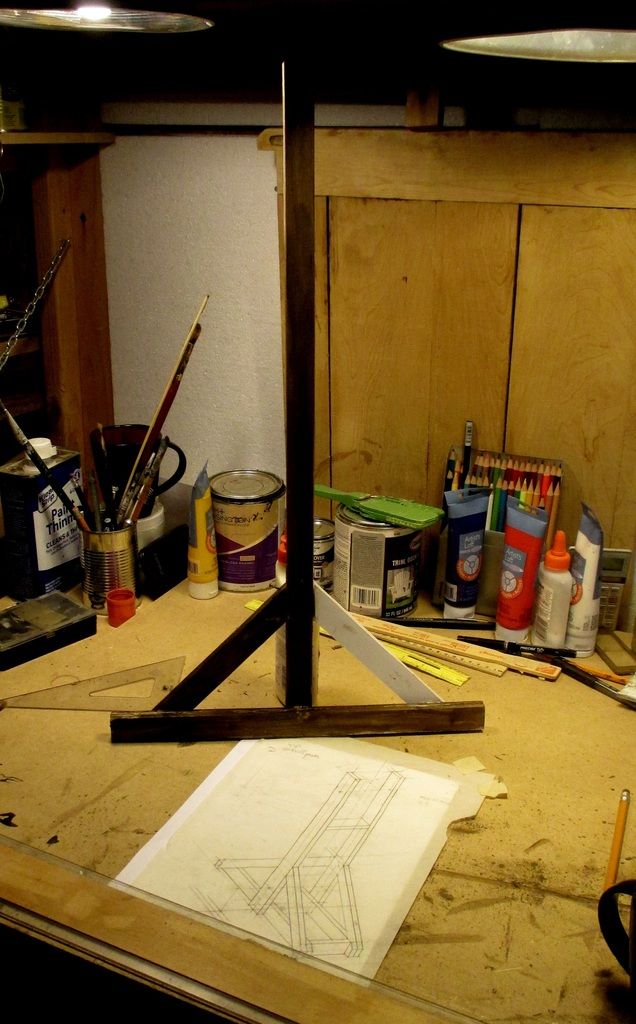

« Reply #13 on: March 29, 2016, 11:18:28 pm »
The framework continued

« Reply #18 on: April 05, 2016, 04:46:10 am »
Brake installed to prevent filled buckets falling back when pressure is removed from drive wheel
Main wheels installed
Next a crank and the planning and installation of the sluice

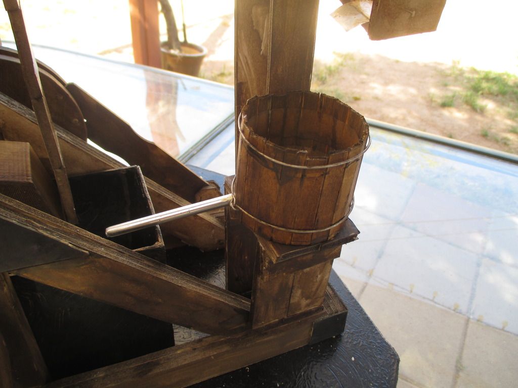

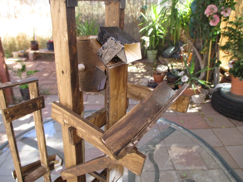

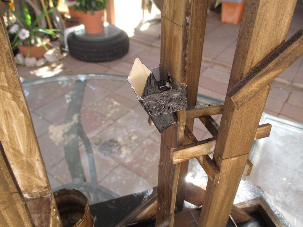

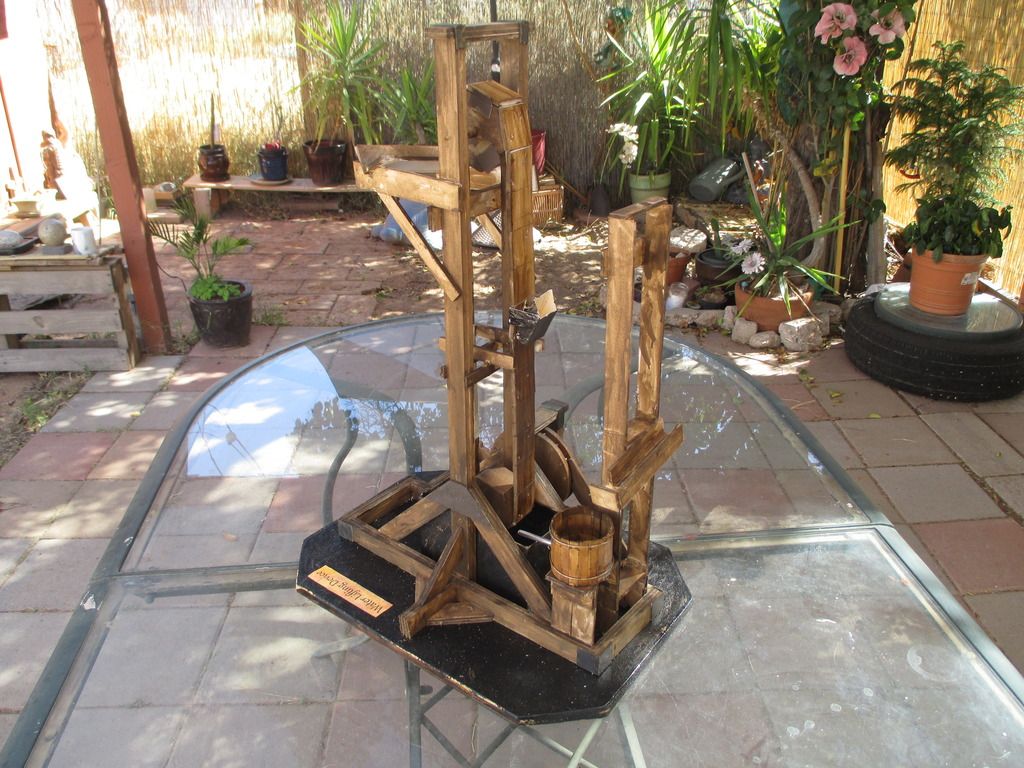

« Reply #24 on: April 16, 2016, 11:28:07 pm »
The latest state
The thing about doing models involving water is that it doesn't matter what scale you're using, water is always full scale. And a thimble full doesn't behave like a bucket full which doesn't behave like a barrel full. Which is a long prolog to saying that I had my first test with water and it didn't go well. Part of it was the scale, but even at full size I think the design of the buckets would have been problematical.
Redesigned bucket system.
It will now pour forward into a sluice
down another (unbuilt as yet)
and into a cistern
and back into the main tank.
This is all for the purposes of the model as demonstration piece. The school (remember the school?) for which I am designing this will divert the water in ways to be determined.
