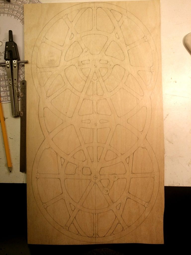

Ok, the redesign for Mk II has started in earnest with starting to lay out the central frame. This frame is a great starting point as it carries all the pivot points for the entire machine, so I can pretty much set everything up from just this one component.
It looks like a random set of curves, circles and partial ellipses, but this is an amalgam of the two separate halves of the machine (front and back) which come together at this central frame - so some elements of this will project forward and some elements will project back. Hopefully it will make some kind of sense as it comes together!
I've jumped the gun a little as I've got to recut all the gearing before I go to much farther as I have to check that all the pivot points are in the right positions measured against the new gears, but it's nice to know more or less what it'll eventually look like as I'm spending countless hours cutting cogs...
More news in a few weeks once I emerge from the shed, blinking into the sunlight, with my shiny new gears.

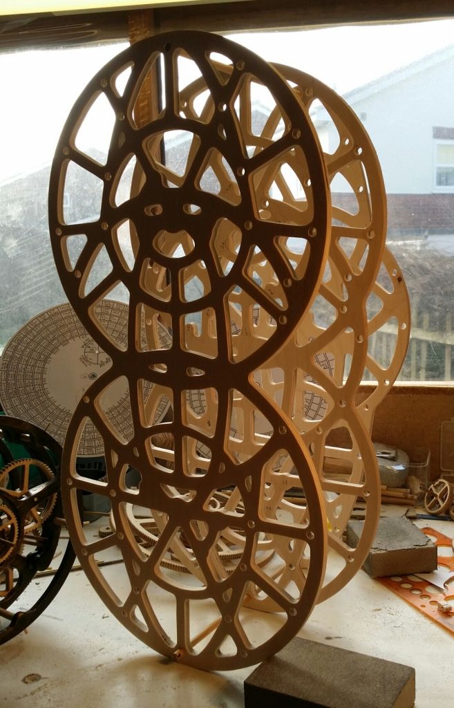

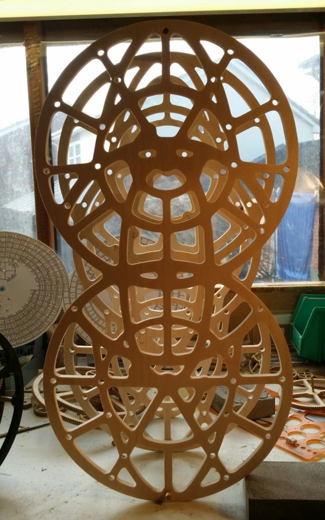

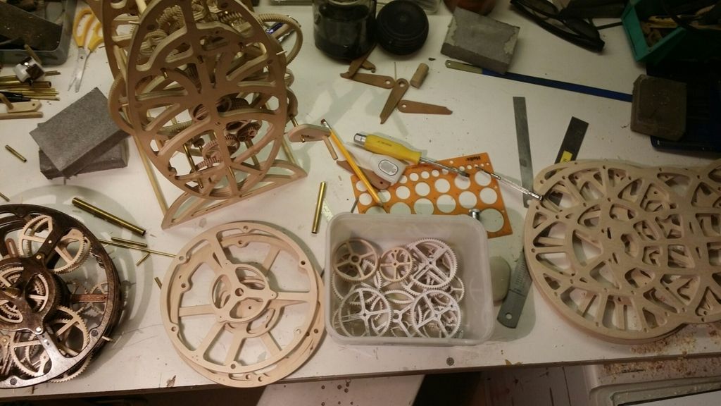

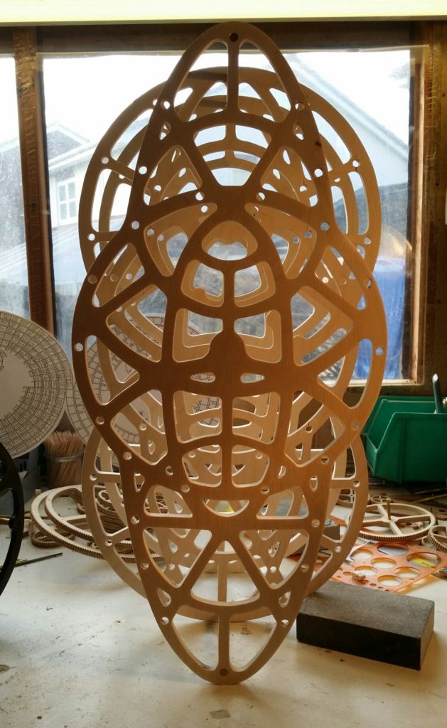

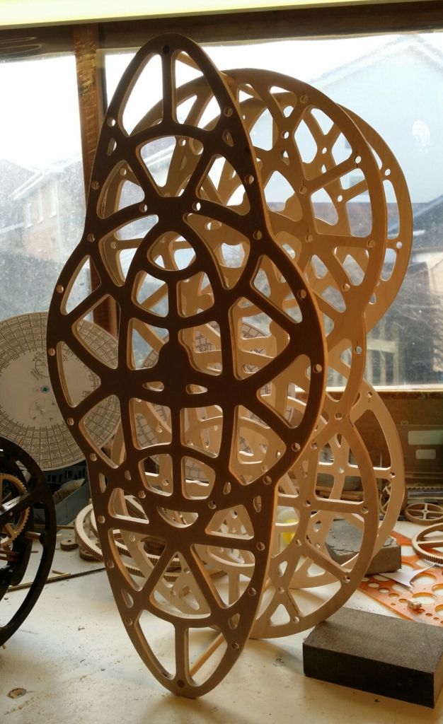

« Reply #138 on: January 26, 2016, 02:36:06 pm »
Afternoon all,
Progress is still painfully slow, but here are the freshly cut frames hastily cobbled together for photographic purposes of MKII.
I ran into a bit of a hitch having cut them, my drill press is not big enough to allow me to drill the centre holes in the frames as it's only got a 10.5cm throat depth (about standard for most £100 machines I have discovered). Unfortunately my frames are close to 13cm to the centre of each circle, so I've had to splash out on a shiny new drill press with a much deeper capacity. It's always nice to have an excuse for a shiny new toy, and I have wanted one for a while, but I just wish that I'd worked this out sooner!
The size of the frames is very much a product of the size of the gearing that they're going to contain and the dials that will be fitted onto them, so going smaller wasn't really an option, so I guess I was always going to have to get a bigger machine.
Right, I'm off to start cutting a new batch of gears whilst I wait for the postman.
Until next time ladies and gents.
