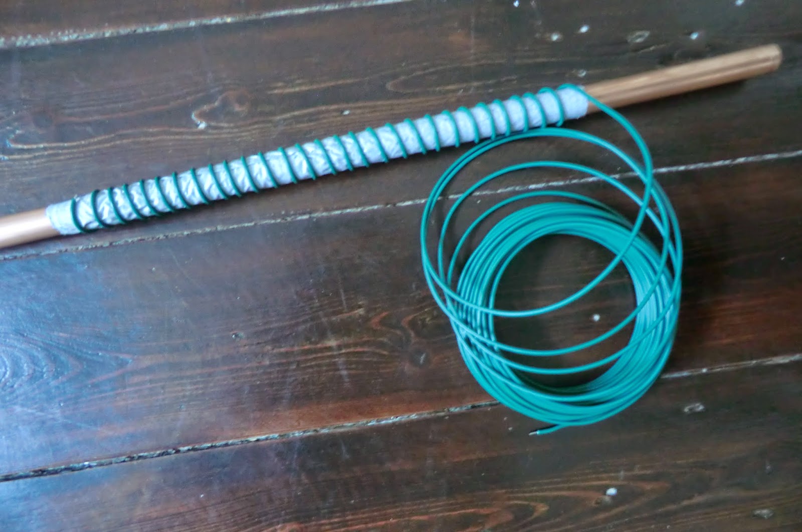

A quick how to on steam hoses, this was a technique I discovered for replicating (in miniature) the kind of hoses that are use to carry steam heating between the carriages on a steam train. These hoses will not hold liquid but should look pretty good for (for example) connecting a handheld weapon to a backpack or for flexible connections on just about anything.
Created in three steps, firstly duct tape was wrapped around a copper pipe, sticky side out (You could use any round object depending on length and diameter). Then thick garden wire was coiled around that at around a 5mm spacing. This was then covered with cloth tape (this was "professional sports tape" from a discount supermarket) . It should then be possible to slide the whole thing off the pipe giving you a none functional  steam hose that looks about right. It should be possible to colour these with ink but I haven't got round to that yet.

Lord P, that is a fantastic idea!! Thank you for the walk thru. Smiley
