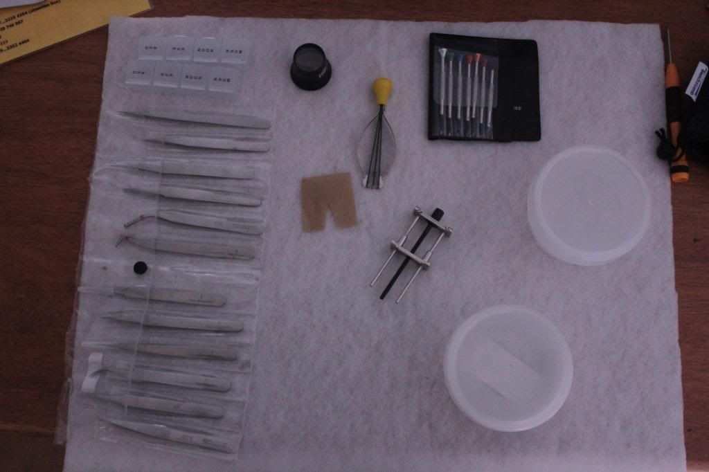

This is everything over all
So what have we got here
Firstly I work on top of a piece of quilt padding, its blank white making it easy to see parts, and it absorbs shock reducing damage on dropped parts and importantly stopping dropped parts from bouncing!

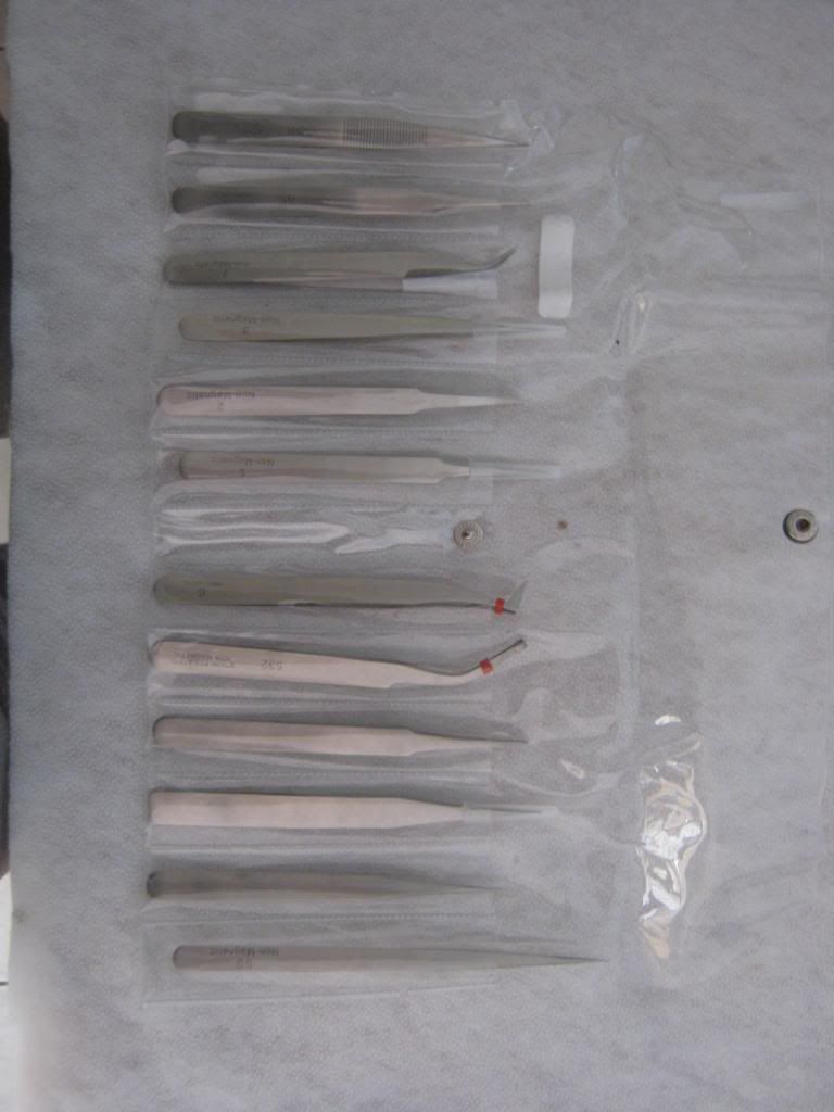

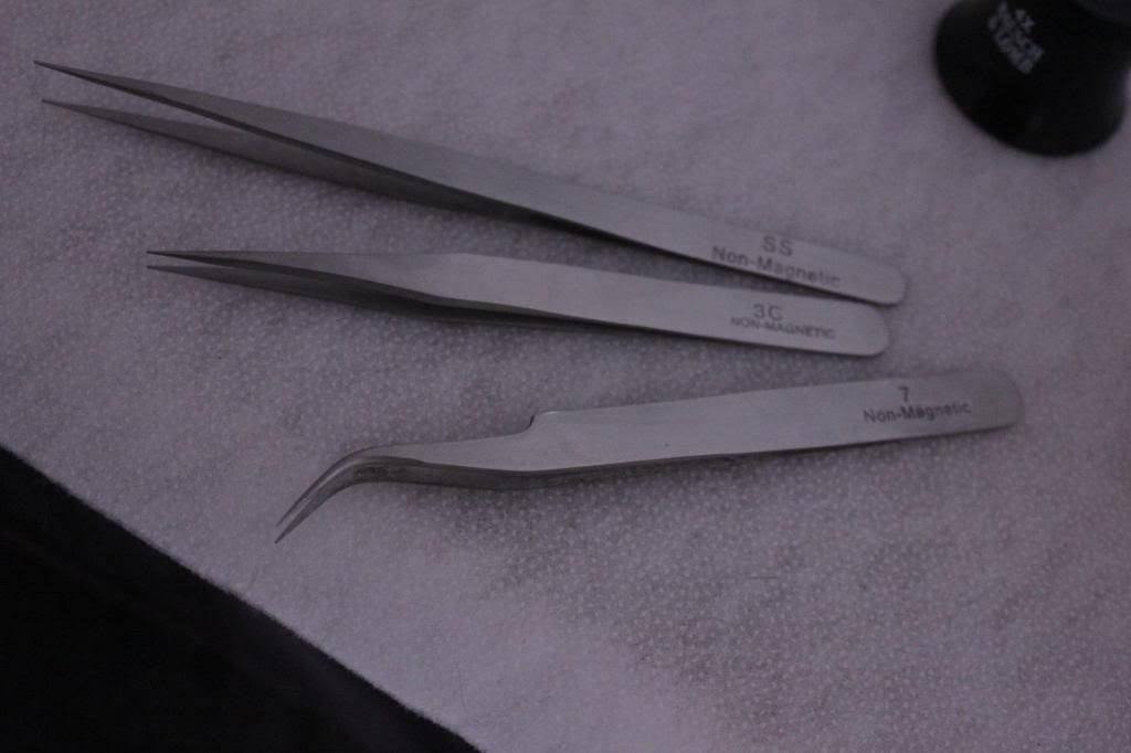

Tweezers
This is a cheap set of tweezers I think it was 15 dollars for a set of 12. A lot of people on other watch forums will recommend buying more expensive better quality tweezers, I don't quite understand why because these will do the job just fine without damaging any parts, plus as they're cheap i don't have any problems with bending them to a shape I want or "sharpening" to get finer tips
If you want to follow along but buy more expensive tweezers here's the 3 I use the most.
SS, 3C, and No. 7, why not buy them individually and save yourself some money.

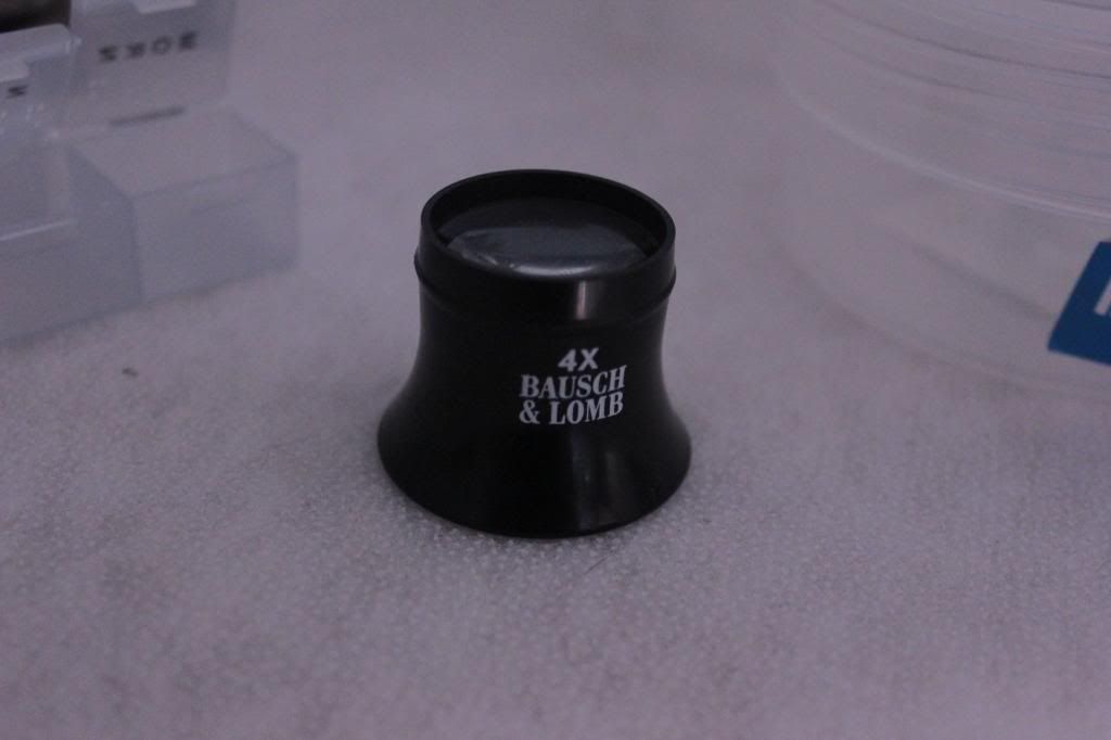

Loupe
I don't use any magnification higher than 4 times, on the movements I'm practicing on I don't find it necessary, purely down to personal preference, I have stronger and weaker loupes but I just don't use them all that much. Some loupes are sold with a head band holder, I don't use one but whatever you are comfortable with. When using a loupe with no headband or glasses clip, the loupe is held between your cheek muscle and the muscle that controls your eyebrow (can you tell I didn't do biology) NOT stuck in your eye socket. Holding a loupe like this can take some practice, it took me about an hour to get it to hold for 5 minutes. It's a good idea to practice with the loupe before you start, its a real pain to have the loupe drop out of your eye onto a part and cause damage.

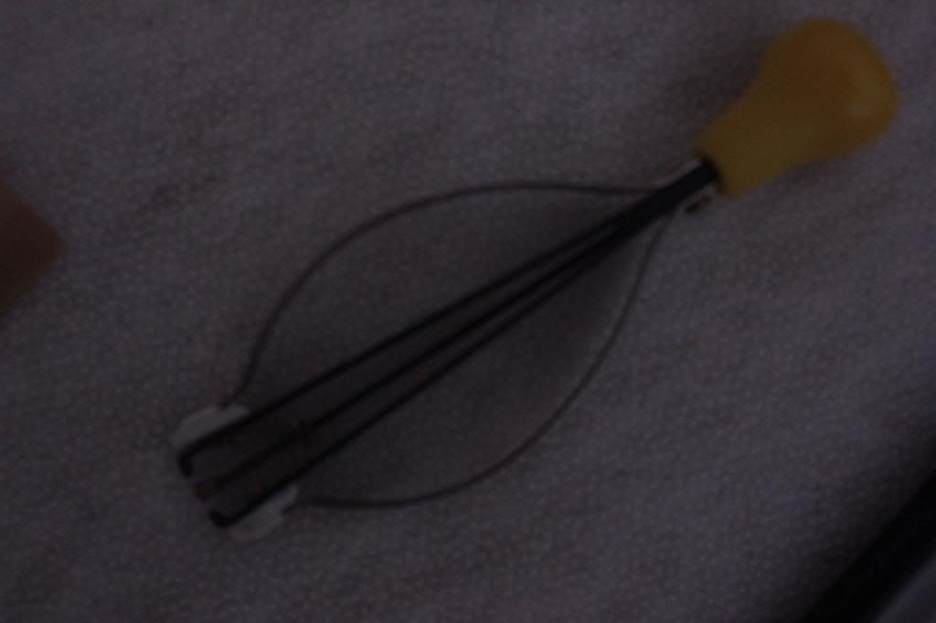

Hand Puller
Terrible photo. This is a squeeze type hand puller, very very easy to use. In this learn as I learn series it wont be used much as I'll be mainly working on bare movements but I thought I'd show it anyway.

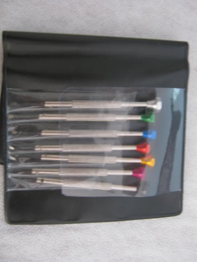

Screwdrivers
The second most used tools next to your tweezers and something that you should spend money on. As I said I'm a poor student, good screwdrivers are EXPENSIVE, so what did I do? I bought a very very cheap set of drivers, and bought high quality replacement blades! The handles on these drivers work just fine, they're color coded so you know which size is which and I wasn't going to spend $150 when I could spend $15 for cheap perfectly fine handles and then a little more for blades.

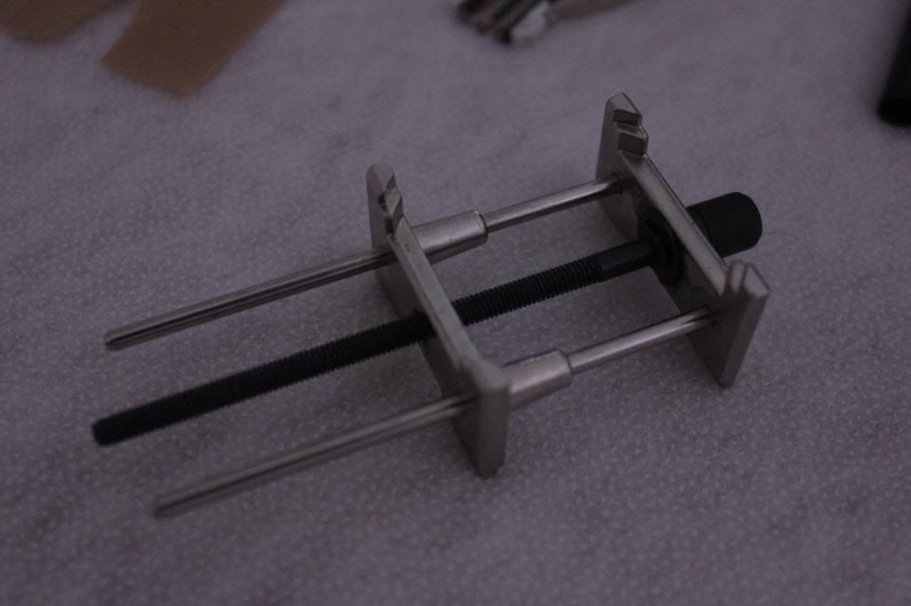

Movement Holder
Cheap cheap cheap, works jsut fine has 4 different jaw sizes, and being so cheap is a little soft which I consider an advantage as I'm not likely to mark movement plates with the holder jaws, some poeple buy more expensive holders and glue felt or leather on the jaws to avoid this problem but I don't have to bother.

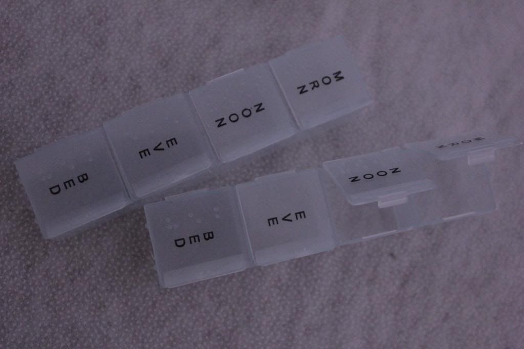

Pill Boxes
These work fantastic as small parts holders, they've got good lids and they cost very very very little
and some other screw lid containers for larger parts, plates etc. (on the right in the overview picture)
