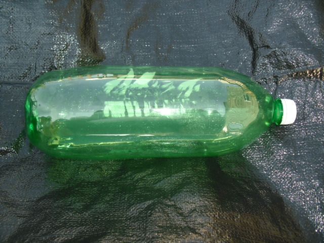

I tried filling the bottle so that the area I wanted to reshape was the only area
unfilled when I turned the bottle over and heating it with a heatgun.
It might have worked if I had more practice.
I heated up the plastic and gently squeezed the bottle to provide extra pressure
and I was making good progress until I got a small pinhole.... I might have gotten
too hasty and was going too fast and getting the bottle too hot.
I have achieved a round bottom accidentally while making quick mead..
( its pretty much honey flavored alcoholic soda pop that will sneak
up behind you, beat you up and steal your lunch money while making
you smile the whole time ) I may try water, a little sugar and some yeast...

« Reply #20 on: June 28, 2012, 09:13:34 pm »
I've got a bottle outside ( temps over 90 F ) with some yeast, sugar and water....
It's slowly working....
I'll get a photo later ( I have a couple things I wanted to take pics of for the
forum anyway.... )
I probably should have used more water.... and sugar but it is slowly
rounding the bottom of the bottle..... I left it go because opening
the bottle to add sugar would depressurize it so I'll just let this one
go until I get the result I wanted or it becomes clear no more progress
is being made.
More water would force the pressurizing air into a smaller area and give
me more bang for the buck..... Water does not compress air does. Less
air space would have made this work faster ( It has been three days so
far)
More sugar would have given the yeast more to eat... See above three days
comment...... There can't be much sugar left for the yeast to make CO2 farts
with..
Professor J. Cogsworthy
Aude Aliquid Dignum
« Reply #21 on: June 29, 2012, 12:54:07 am »
The promised pictures.....
It's not perfect, but it's not bad.....pretty good actually...
I think more.... of everything ( but the yeast ) will give me the slight improvements I'd like to
get
