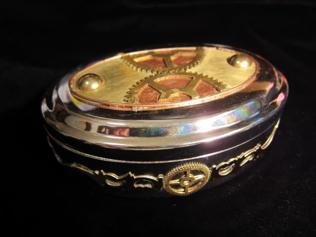

There are so many attractive and well made boxes of all types available cheaply or for free, leaving you to apply your creativity to decorating them rather than worrying about dovetail joints. I found this metal box at a sample sale, I think it cost $4. I applied all the decoration, then my wife claimed it for her own.

Very nice little box,
