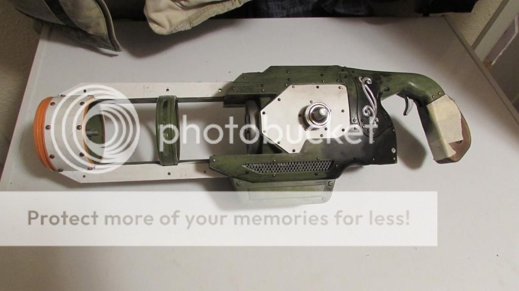

A couple of WiP shots.
The support bolt for the side handle made from several layers of plywood screwed togethr and epoxied into place. It's not budging.

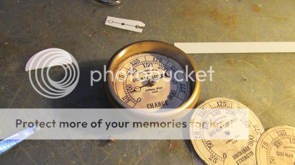

Making the electrical charge gauge for the top.
Styrene sheet glued into place with brad 'rivets' added. The collar for the handle is a slice of pvc pipe with half of a tarp grommet glued on.

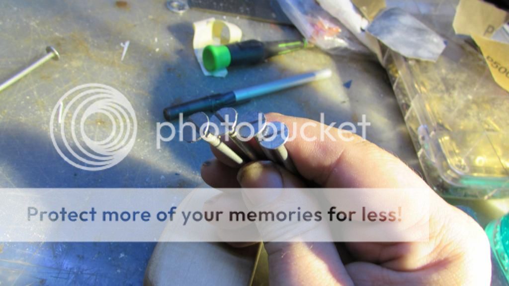

Don't have  flat screws? Grab some nails and cut a slot with a Dremel cutting wheel then slice off the heads.

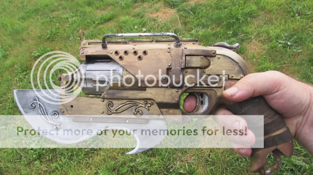

Oh, And I was feeling bored last night and decided to replace the blade on my Hammershot with something a bit more substantial. Its just a bit of acrylic plastic cut out on the jigsaw, then sanded and filed to something resembling an edge. Now to paint.
One quick question. Does anyone have any idea of how I can go about simulating the different shade/texture of metal you get along a sharpened knife edge?
You could try painting and aging your whole blade evenly then lightly sanding the sharpened bit with a fine grit sandpaper to remove the aging where you need to, OR age the whole blade and then hit the sharpened bit with rub and buff to brighten it. I'd try different methods out on a scrap piece to find the best results. It would make a great mini tutorial, in fact, I'm certain a lot of folks here would love to see it.

Many thanks RR. that sounds like it should work.

For a sharpened edge, you could try a very bright metallic colored acrylic model paint used for miniatures or a very shiny metallic paint marker. The effect can be accentuated by contrast, so you could darken the immediate area that is adjacent to the sharp part.

Meanwhile back in the world of fake guns, here's the finished blade attachment. Rub n' buff on the edge seems to have done the job. What do you think?

That's a very nice effect on that blade.
