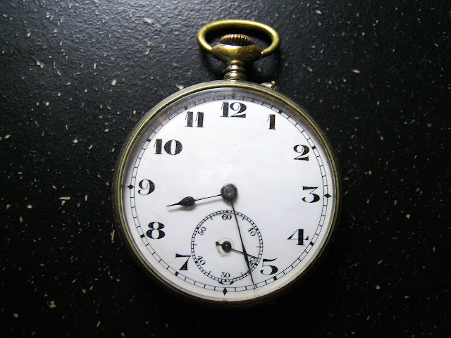

« Reply #11 on: September 21, 2009, 11:23:09 pm »
Minus,
I am not in any way an authority on pocket watches. However, the model shown above is strikingly similar to my 1906 Invar watch. It is nigh on identical, with only the face being dissimilar. I hope that this clue might aid you on your quest. Good luck!
Sincerely,
Z.H.J. Lindenvale
Could you post a picture?
I would if I were not in want of a digital camera. However, I took the liberty of procuring an image of another Invar watch which might lend you some measure of comparison.
Sincerely,
Z.H.J. Lindenvale
