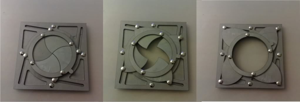

Well I am trying to get this reverse version made to test the theory. It has a better hole/area ratio
Its only a small 200 x 200 mm version. It would work something like this

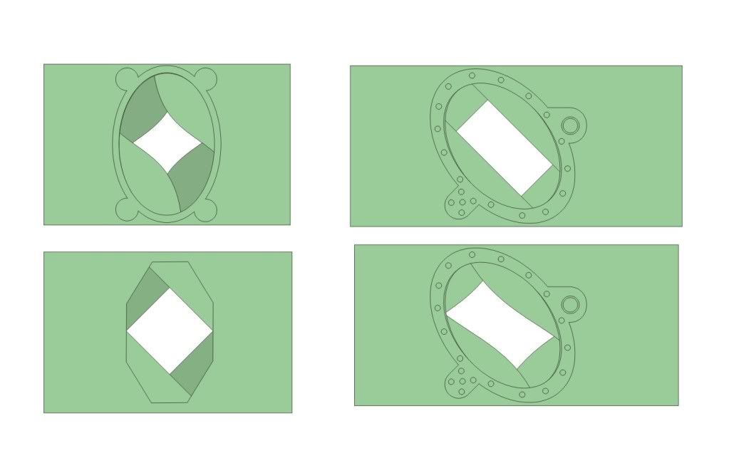

« Reply #78 on: May 26, 2010, 07:50:34 am »
Is it possible to make a more oval one for a door?

Robo Von Bismark
« Reply #79 on: May 26, 2010, 08:35:23 am »

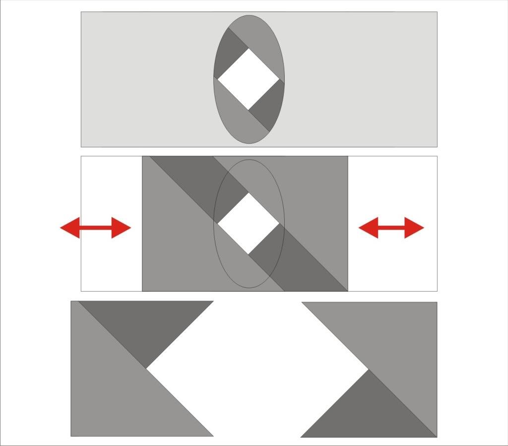

One way I thought about was having overlapping sliding doors at a 45 degree angle.
This animation explains a bit better
It is really just sliding doors but the give the illusion of an opening iris
That design is very common in SF movies. Works fine, and you get a flat threshold. Stepping through hatchways (as on warships) gets old very fast.

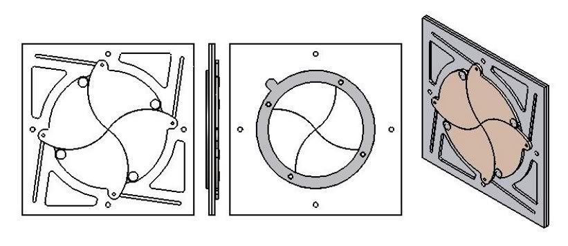

« Reply #85 on: May 31, 2010, 02:56:27 pm »
This is the reverse version of the four door iris i was working on
The centre ring rotates forcing the shutters along the straight tracks. Not as pretty as the the other version but more compact.

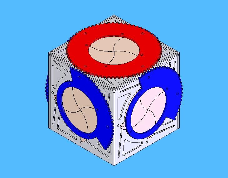

« Reply #90 on: June 08, 2010, 11:10:29 pm »
I reread passbyguy's comment and realized he probably meant something more like this:
Its still a bit rough so please excuse some elements. The red cog represents the drive wheel, which in turn drives the blue cogs (which are only partially toothed to avoid running into each other). This only covers five sides instead of six.

« Reply #91 on: June 09, 2010, 12:43:55 am »
May I suggest a drive rod, extending through a corner of the cube vertically could operate an iris on the bottom surface of the cube, without causing major obstruction to passage through the openings.

« Reply #92 on: June 09, 2010, 01:19:56 am »
Hopefully that communicates the idea, meanwhile Ill just continue to be amazed with how you've developed this.
Do you mean like this?
The magenta rod links the top and bottom plate internally.
That's a great idea. I like to think we are all developing this.

« Reply #98 on: June 09, 2010, 10:48:36 pm »
Good evening Robo,
Not quite what I'd envisaged, though it would work, the magenta pole would obscure part of the iris. (Possibly restricting passage through the junction.)
Apologies, my earlier explanation was not precise enough to convey my suggestion. If a shaft were to be mounted in the corner of the top surface, such that it pierced both the top and bottom surface, in the space not occluded by the main cog, it could then be driven by either a toothed cog or by a drive belt situated on a rim below the gear teeth.
Unfortunately my drawing skills are not up to rendering a visual which does anything other than confuse the matter.
Does this make sense of what I'd suggested?
