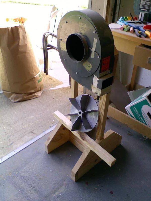

« Reply #29 on: June 06, 2012, 05:40:28 pm »
For air any squirrel cage blower with an adjustable flap to restrict intake will provide excellent amounts of air.
Like this one? The motor I bought for my lathe had a blower attached to it.
I have to remove the pedals and replace them with handles and tighten up
the chain a little. Then make a connector to get the air flow into the forge.
Ther is a little more work done than I have photos for... I added a brace
the wooden pulley. I might have to replace that pulley with a larger one
if I do not get enough air flow. I think I get around 30 revolutions of the fan
cage for one turn of the pedal/crank... ( do not remember exactly )
Getting back to this one is almost to the top of my backlog of projects....
http://s147.photobucket.com/albums/r295/ConalOhAirt/Forge%20blower%20project/
I have an electric fan on it now but it is so picky I have to fiddle with it so
much it gets annoying.... I might try to work out a way to attach both the
electric blower and the hand cranked so I can pick and choice. For welding
temps I might need the electric blower..... I'll have to actually get this finished
to find out how good a job it does.... lol

« Reply #30 on: June 07, 2012, 12:05:14 am »
That should work beautifully. If you can find  a copy of the  reprint of Practical Blacksmithing  there are several home brewed blowers in it from the turn of the last century. If you don't care to spend the money for the actual book it is also available on line at Internet Archive free.

« Reply #31 on: June 07, 2012, 02:24:51 am »
I pulled it out tonight and tightened the chain and took the pedals off.....
I need to get some bolts to go in their place and make some new handles for the crank.....
The outlet opening is 14 inches around I need to make something to go from rectangular to
round and get some kind of a hose to connect it to the forge....
« Reply #32 on: June 08, 2012, 01:12:49 pm »
I have used exhaust flex tubing in the past for connecting to the forge. On my newest I just rolled up some scrap HVAC tin I had laying around and used Aluminum duct tape to seal it.
